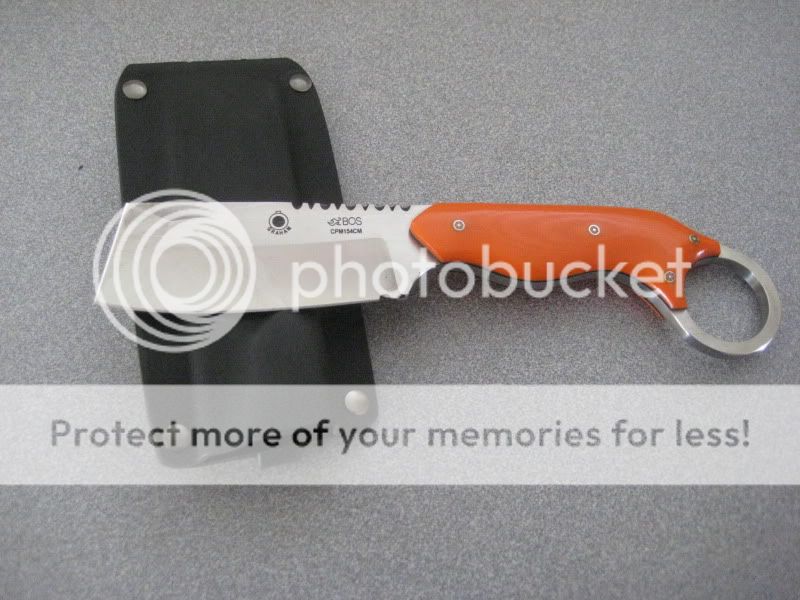

Well,
I have found a reason to like kydex :)
Well - actually 2
1 - Its way thinner than leather and stiffer for pocket carry reasons ie. poking into leg :)
2 - I can do a much better job than before!!
Here is my neck sheath + pocket sheath + can be belt sheath :D :thumbup:

Very very cool! What are the specs on that? I've been looking at getting a new necker for my bag/kit.
If you truly want it for pocket carry, you can put a little 90 degree ramp at the mouth of it. It will allow you to rest your thumb on it and push the sheath off as you pull the knife out. Otherwise, you are going to do the two handed pocket pull thing. Otherwise known as the pee pee dance :D
I carried a Glock 27 like that for a long time, and the thumb ramp was a very cool feature.
B
This one is 3/32" D2 with OD micarta. 6" overall. Stews away super easily.
