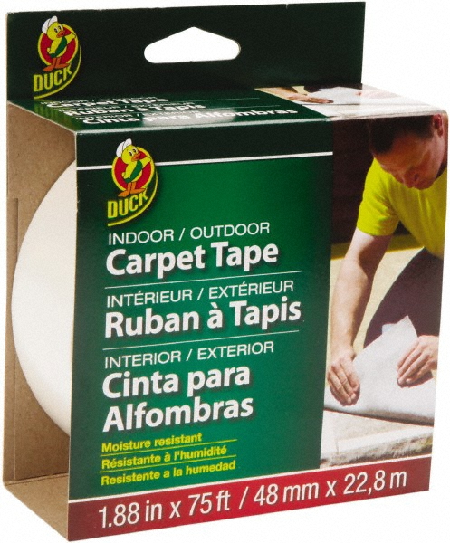

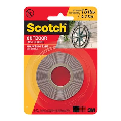

exterior grade double stick tape.
Would that be this stuff?
http://www.homedepot.com/p/3M-Scotc...-SearchPLPHorizontal1_rr-_-NA-_-100575385-_-N
That my very well work.
http://www.mscdirect.com/browse/tnp...gle-PLA+-+Test&CS_003=7867724&CS_010=47028899
This is what I originally used, from my local hardware. Last time I went to pick up a roll, I didn't see it anymore, but they had a similar vinyl flooring tape that seems to be about the same stuff.
IIRC, 3M makes a VHB (very high bond) double stick tape that comes in high regard too.
