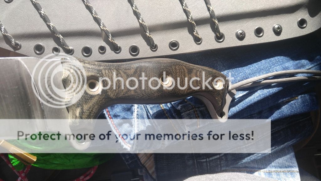

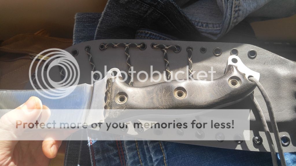

Thanks to the info from AZTim & SpyderPhreak, I ordered some Ren Wax and tried it out on my DTBM with Black Micarta.
It really brings out the highlight colors of the Micarta and does indeed make it shiny:
I forgot to do a before shot and realized that after I put the first coat on. DOH! :grumpy:
A little really does go a long way as SpyderPhreak said, and this effect is from two light coats of Ren Wax.
Me likey! :D
I think I may try it on the Green Micarta on my TGP when I get that.
That looks good evlcat. Did it darken up the micarta from what it was before the ren wax? The shine looks nice. Did you have to buff a lot?
Glad it worked well for you evltcat! I've been impressed by the stuff every time I've used it. There is a reason that museums use this stuff. :thumbup:
I think I'm going to try this on my green linen Leprechaun AD to see how it turns out.
A little more info - if you want to remove the Ren Wax, a light scrub using a soft scrub brush under warm water with Dawn dishsoap will work well. Same goes for an oiled handle. Will make the micarta look like new after the water dries off.
Yes, it darkened the Micarta, it was originally that very light grey color Busse Black Micarta has when clean and dry. The change is subtle as you can see, and add a really nice sheen.
I used two light coats and a few minutes of buffing between each coat.
