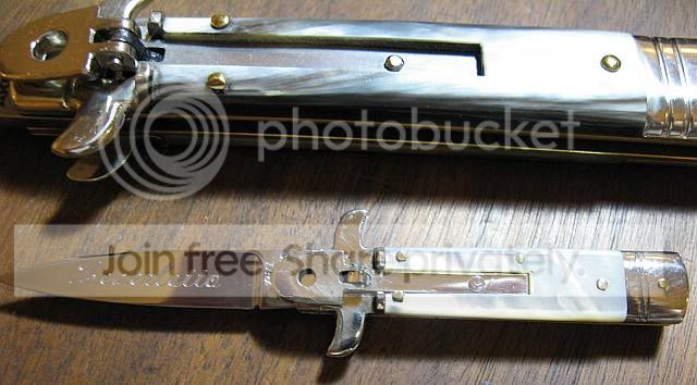

I use materials that you just cant peen pins in (ivory, pearl, some wood etc) and the way I do it is use a quality glue and slightly bend the pin and gently hammer it in. The bend locks it in place. Never have had a failure reported in 20 yrs.
I peen pins in ivory, pearl, tortoise shell, and wood quite often.
All it requires is finesse. You can't use your blacksmithing hammer and anvil to do it.
My thoughts as a beginner would be: is glue the handles on, re-drill the pin holes then taper them (takes the glue out) and tap the pins in last.
Here's a miniature Leverletto I'm just finishing with mother of pearl scales that I peened. The knife is 3-3/4" open.
