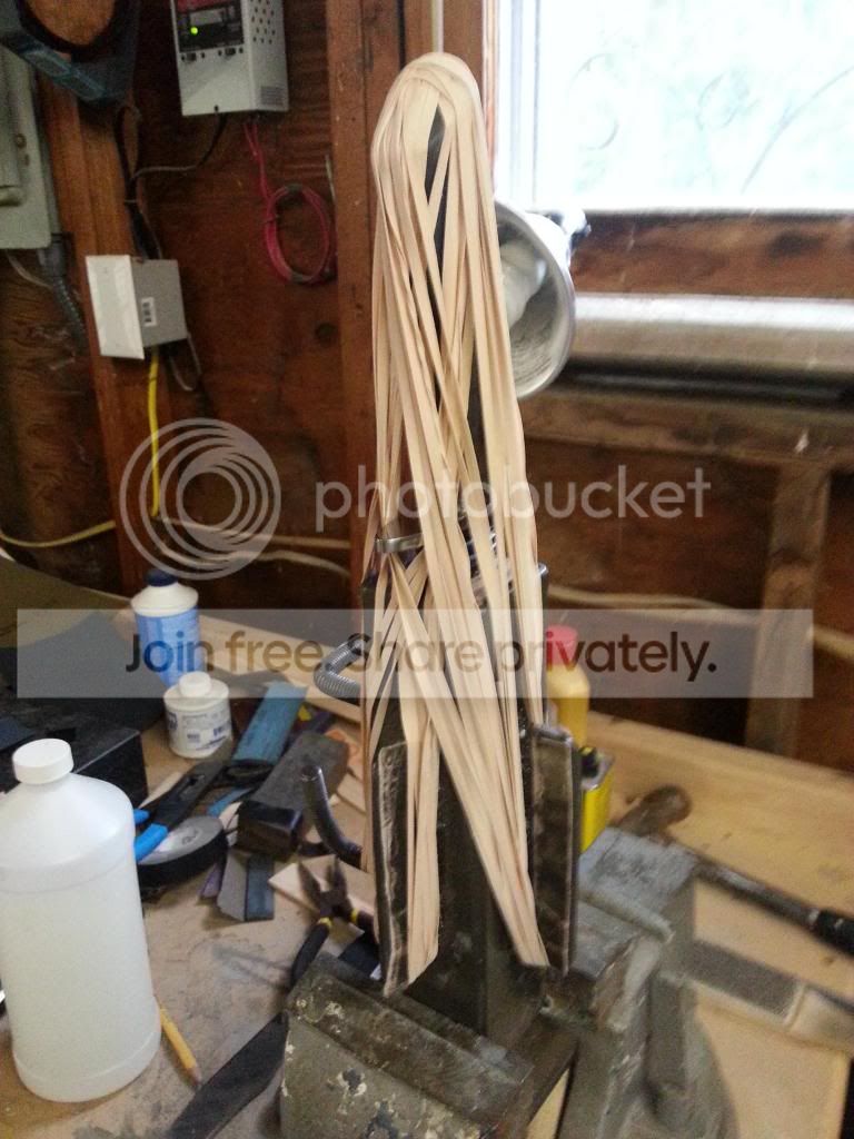

I use threaded rod, nuts and two 2x4s to make a clamp. I've tried to type out how this works and for as simple a design as this is, articulating it in writing is not so simple... Not perfect but it works fairly well and was probably under 10$ to make if you have a piece of 2x4 laying around.
Here's the fancy clamp I used on my first one. It's called a bag of rubber bands from Staples lol. Oddly enough there were a lot more I didn't use, and yes there is a knife somewhere in there.
