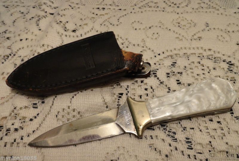

Pictures of received and process
Original knife with cracked handle
