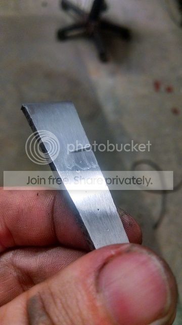

In my quest to harden w2 completely I took a better picture and I was hoping someone could tell me what it is. This piece was held at 1460 and quenched in parks and had hardness reading from 45-62. I then heated it to 1460 held it and quenched it in water and had an overall reading of 66 with one 60 spot. A 3rd time I tried at 1460 and quenched in parks and had a reading everywhere except the small circlish area that has white lines around it. I've removed .035" and the spots are there all the way through. This area is 67 . It's noticeable on the grinder and tester. It is way harder than the surrounding area. This is the second bar of w2 to replace the first I couldnt get to harden. I've had 2 other makers try and neither were able to get it to harden completely using parks 50. I dis have an analysis done on both bars and both had enough carbon to harden. But 3 of us can't get them to harden completely. I'm curious as to why there's a noticeable hard spot just right there?
This piece is the first time I've gotten such a big area of hardness with water/brine. The other pieces I've done still had very soft mixed in. And one I did with clay blew apart at the line where the clay stopped.

Why don't you send a piece off to Peter's HT and see what they say? Tell them your issues and maybe they can shed some light on it.
