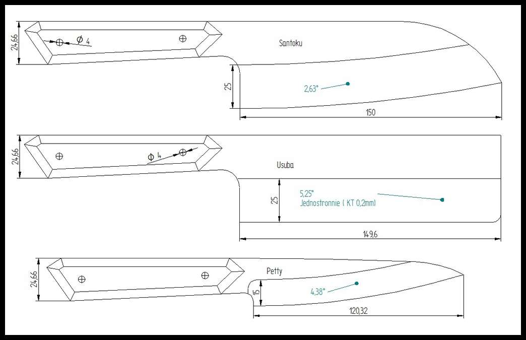

Hello guys, :)
From some time I was thinking, and thinking...
Maybe it's time to try and make some kitchen knives?
One night I taken a cup of Yerba mate (Pajarito ;) ) turned on CAD software and make some designs.
From 5 designs, in my opinion this is most in my style, and looks good.
But how this designs of 3 knives look to you guys?
First set I want to make them from 2,5mm NCV1 steel (80CrV2) and some wood ;) ( and one with black G10 :P )
Cheers,
Konrad Sadowski
I'm no expert on kitchen knives, but I like the blade shapes on the knives. Some of the sharp angular features on the handles look like they would be uncomfortable to use in the kitchen for extended periods of time.
I like the handle. I you want a good blade shape, go buy some Sabatiers and use those patterns but without the heavy heel bolster. Apparently, that is what the Japanese makers did when the started making western style knives.
The shapes are nice and classic, the handle designs makes me remember the ones made by Don Nguyen who also makes nice kitchen knives.
Pablo
Those are classic, can't go wrong, single or double bevels?
One curiosity, are you left handed? i ask because i'm right handed and always draw knives point facing left, other way around doesn't feel natural to me.
Just a thought, the knife handle must be easily cleaned to prevent food cross contamination. The "point" front of your handle would require 2 swipes to clean and one swipe might be skipped. Just a thought.

I've been watching this thread since it was started, hoping someone else would point out the obvious.
Well, no one has, so... OK, here goes... remember, you asked for honest opinions. Here's mine.
I wouldn't even bother picking those knives up if I saw them on a counter. Frankly, I think they're pretty awful designs. (Just my opinion, of course... hey, you asked)
I think the handles look un-necessarily angular and possibly really uncomfortable, especially in a "pinch" grip.
I do not understand why your "santoku" and "petty" have such a dramatic belly and such a high point. That's pretty much the worst of both worlds between classic European and Japanese kitchen knife designs.
My advice? Stop playing with graphics software to see what "looks cool", and spend more time using knives to see what actually works.
