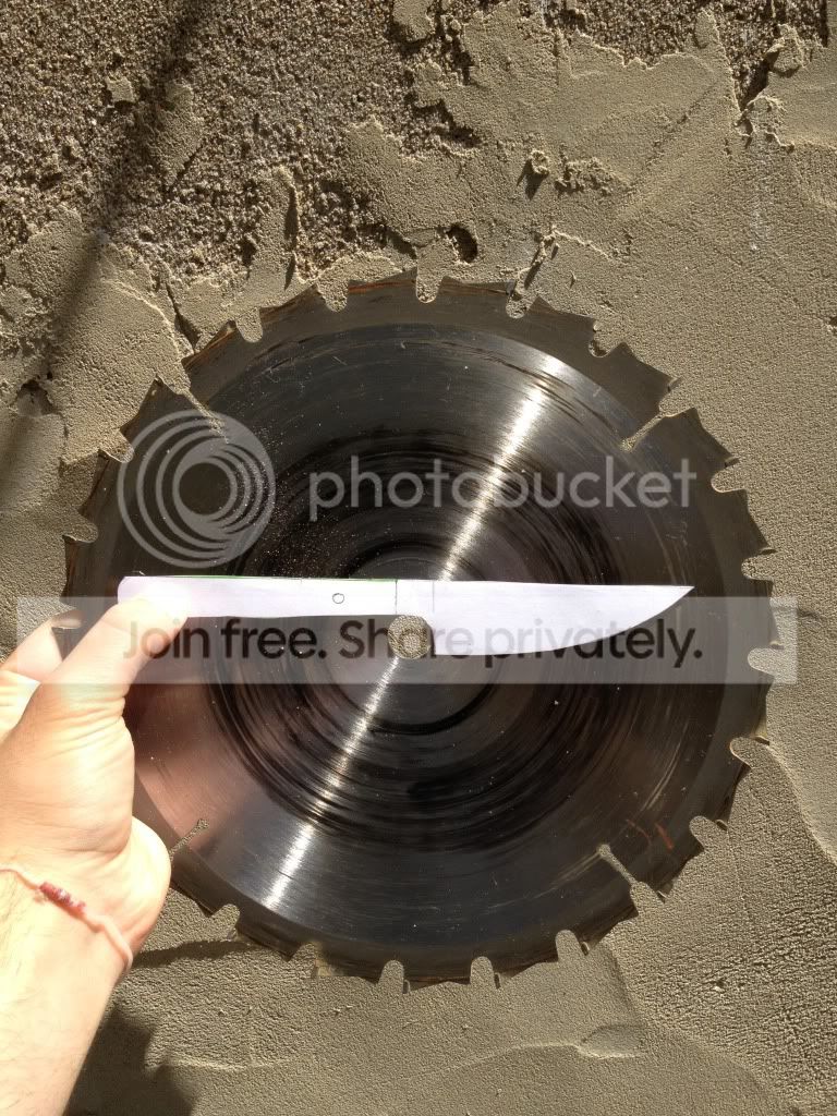

So I thought for mothers day, I was going to try to make my first knife , and make my mother a sort of personal pairing / mini chef knife..

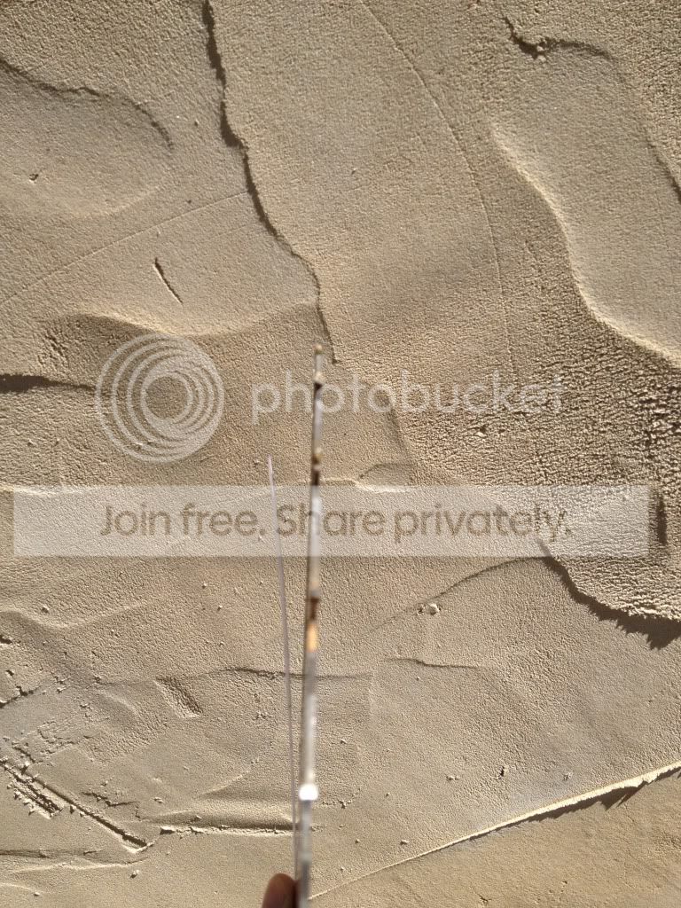

I planned on making it out of the old saw blade i found, i think its 1/16th thick - I was just wondering if there is anything I should know before I start, I've read all the threads I can about blade making - I am going to cut it out with a hack saw, and finish it wil files and sand paper...
If input would be great, THANKS GUYS (and GALS)
ISK
here is the saw blade and pattern
I can see carbide tips, and the brazing the use to attach to the blade.
I'll bet you a wooden nickle that that blade is not useful steel.
since it's a kitchen knife - stainless seems right

THANK YOU, saw the carbide tips too and wasn't sure if this was good steel to use, that was the main reason i was posting (to see if it was useful steel and any HT info - tho I am going to send out) ... I just wanted to not have to order steel but I think I must -
