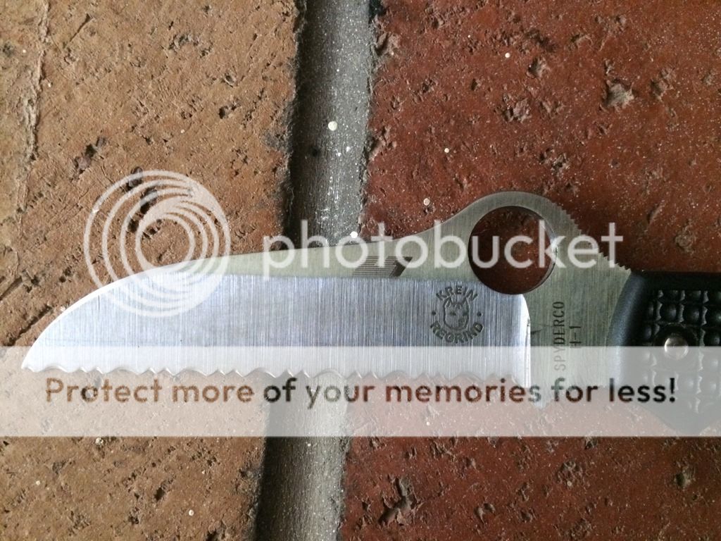

Here's something to consider as well... If you like the serrated and the PE both, you can grind the serrated to a high flat grind and it will smooth out the serrations a bit. I'm in love with this grind. It still retains a great edge and cuts extremely aggressively, but it cuts just a bit smoother than standard serrations.
Tom isn't doing regrinds anymore, but others will.
