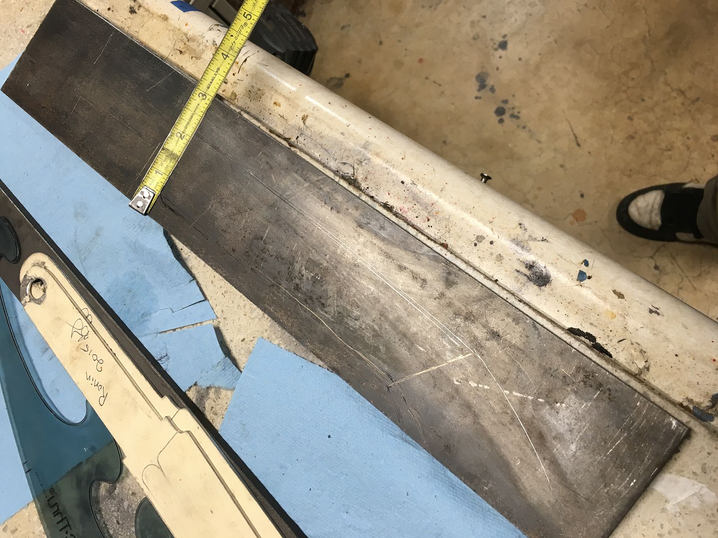

Hey everyone! So this is something I have wanted to do for a very long time. Don Fogg's knives have been a big influence for me with my work, and his Yakuza Bowie II is a stand out piece. Probably in my top 5 favorite knives of all time. Just a powerful design. I decided to build a knife inspired by it. With this one I am not trying to copy his, it's just a source of inspiration thoroughly mixed with my design elements and style. His was a chisel ground, mine will be double ground. I will likely do a chisel ground version as well eventually.
I figured I would post a couple pics of the build.

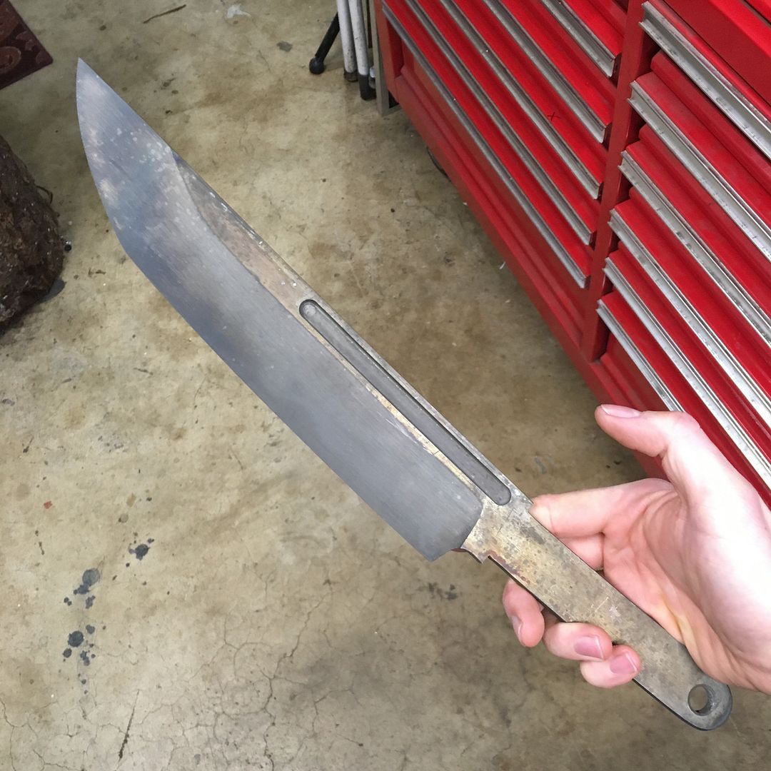

Laying out the design on a big ol' chunk of 3V.

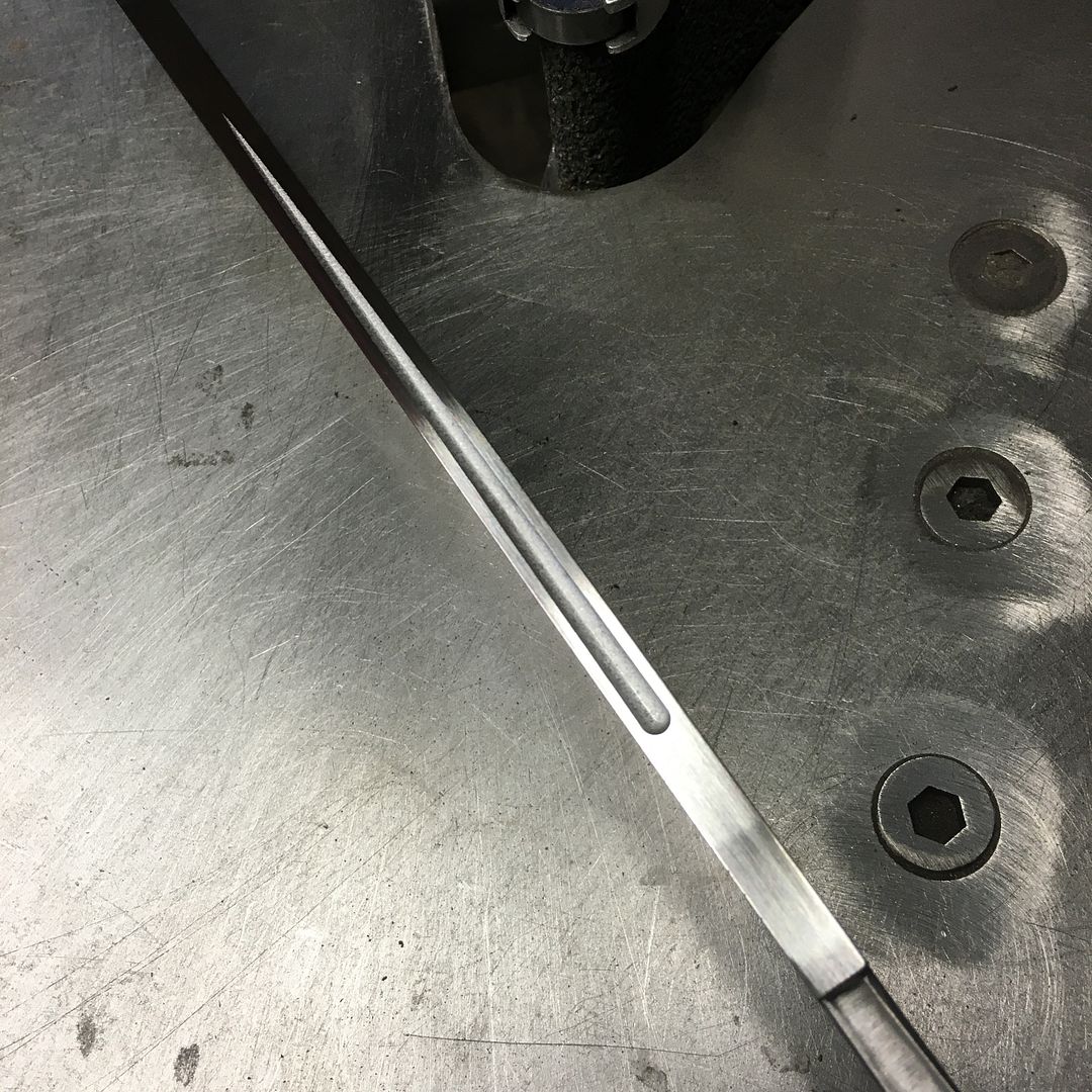

For extra weight reduction and better balance, I went with a flat bottom radius-ed fuller. Manual mill, no power feed. Lots of cranking. :D
My signature tapered fuller on the spine. This is a feature that I put on most of my large Japanese style fixed blades.
Blade profiled and fullers milled.
I didn't get any rough grinding pics, but here it is ready for pre HT hand finish.

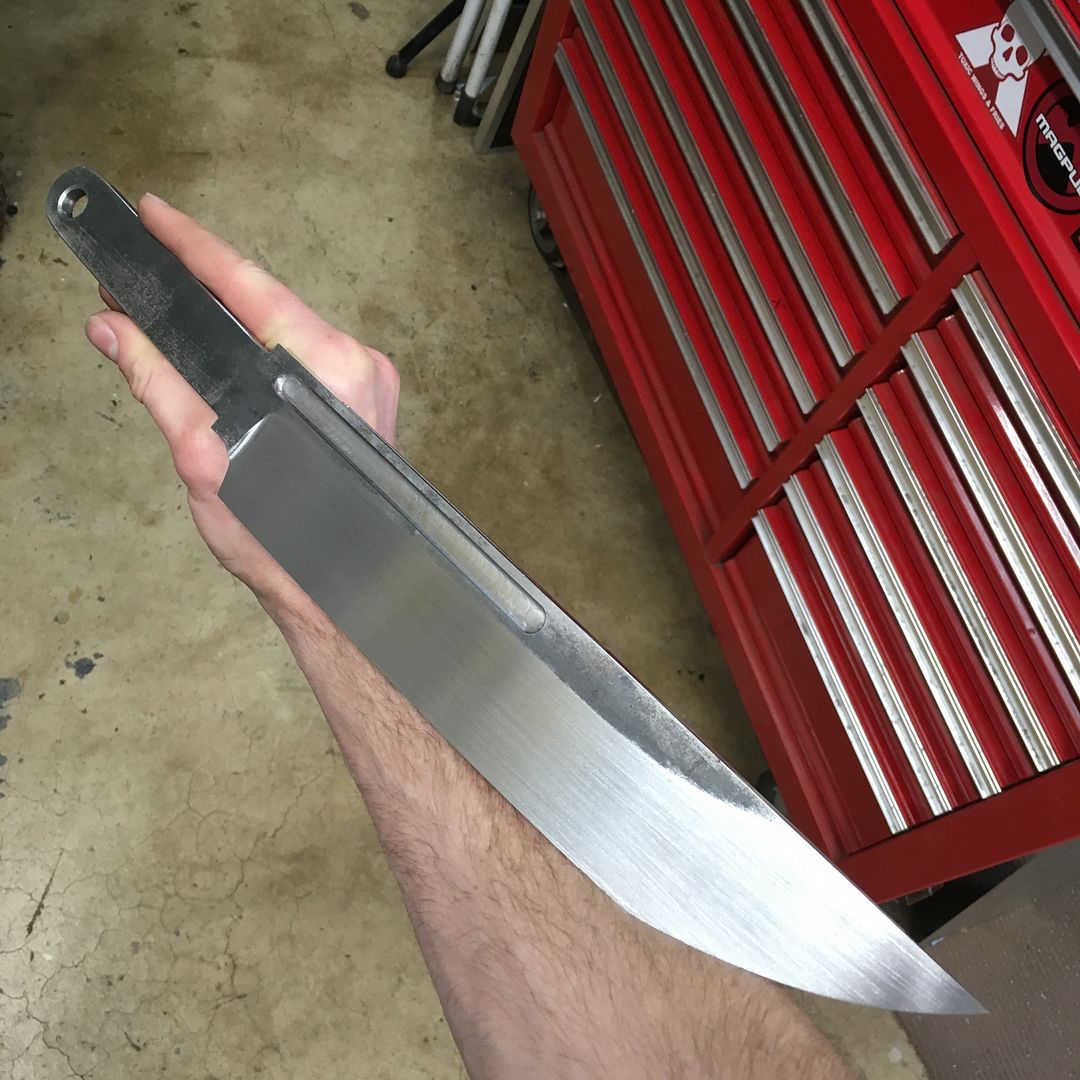

Bevels cleaned up by hand.

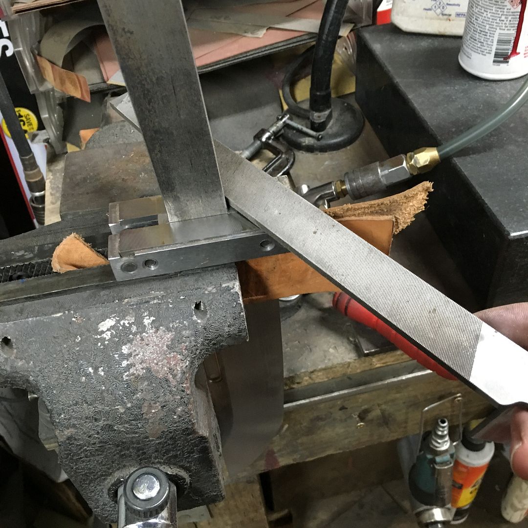

Hand filing the shoulders square for nice guard fit.

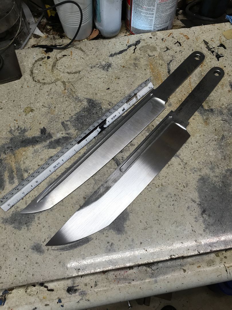

Here is a pre HT pic of it next to my Shinobi tanto, which is a pretty large knife. It pales next to Gojira!!!!

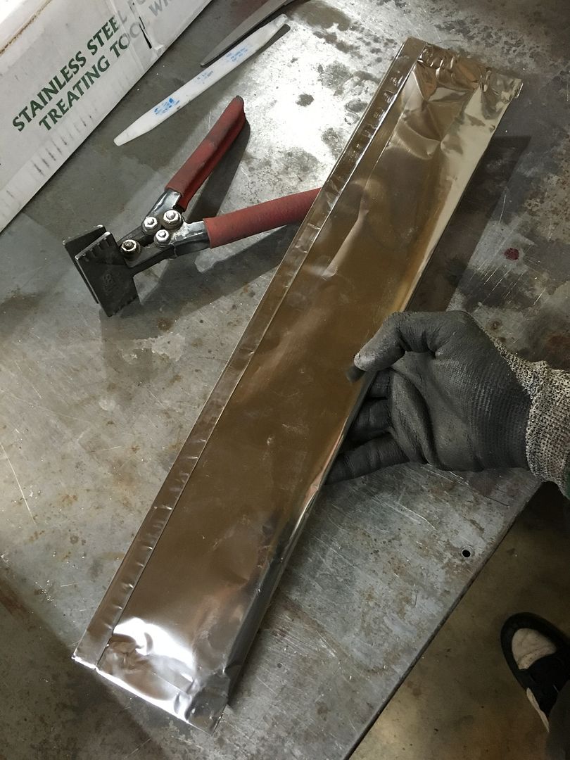

Decent size piece of high temp foil needed for this one.

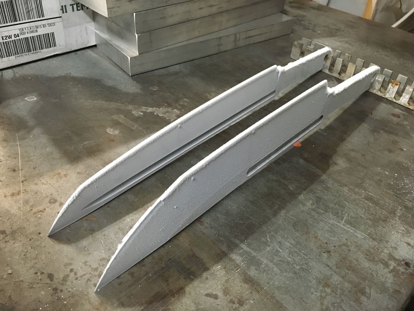

All wrapped up.
I didn't get any pics of HT. To do it properly there can be little delay (minutes) between the Plate quench at 2000+ degrees and soon after into Liquid nitrogen. It is a crucial process that I have spent a lot of time perfecting. My knives are first and foremost high performance tools, the HT is one of the most important elements of that. The blades soaked in Liquid nitrogen at -300 overnight.
This is them coming back up to room temp before temper.
Here the blade is out of it's temper cycles, and ready to fit the guard.
