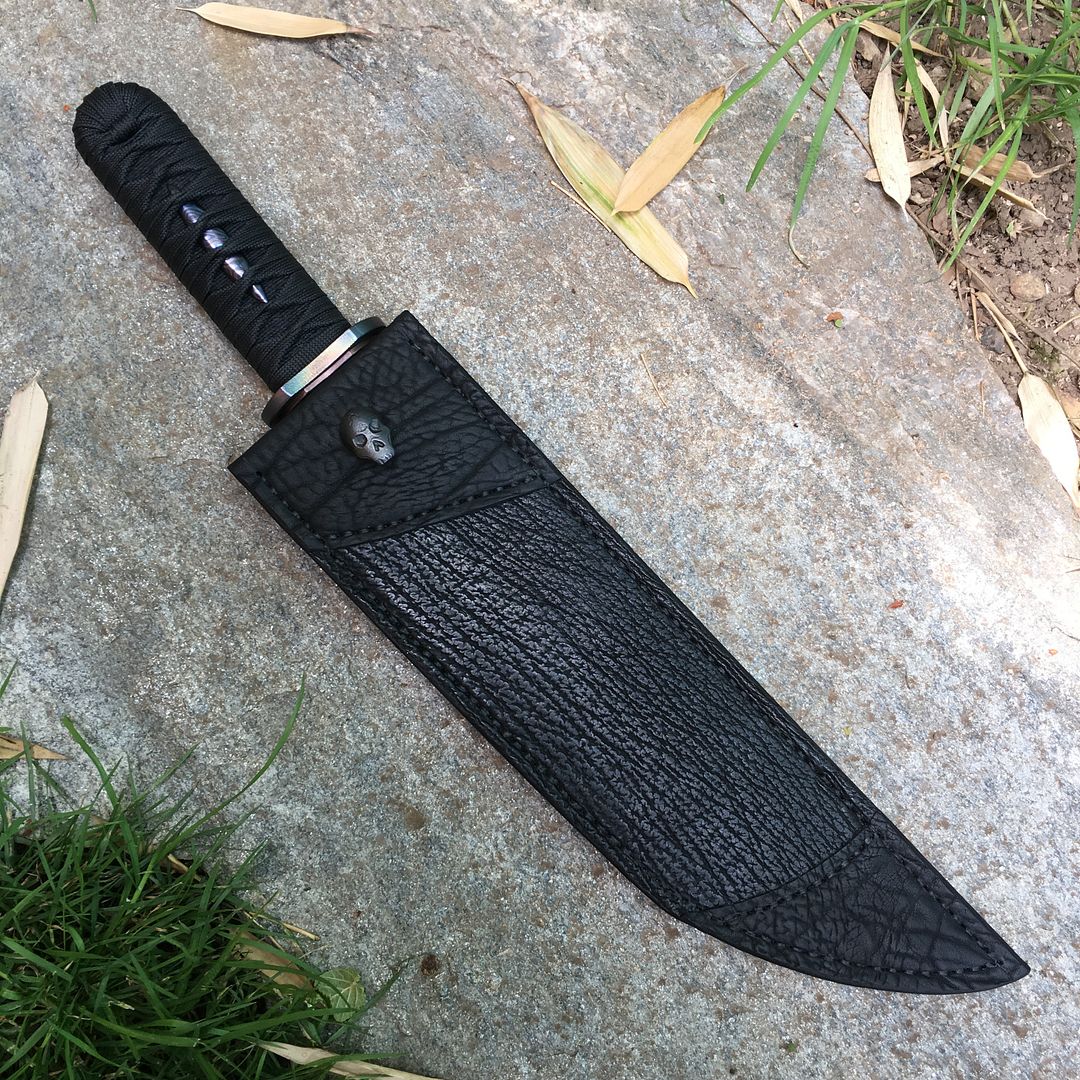

Here goes for the sheath!
Someday I will have a large table for laying out sides of leather, until then I get help. : )
Here are all the components cut and ready. Shark and bison.
Time to make the belt stud. Cutting up a chink of Zirc.
Squaring up.
Drilling for mounting hardware.
Tapping.
Profiled.
A little sculpting.
I decided now would be a good time to try carving for the first time ever. Why not start with zirc right?! :D
Feeling a little skully.
Looks good so far!
Finished up. Time to heat color!
Dark skull!
Glued up, stud mounted and throat/tip stitched. Ready to stitch the sides. All hand stitched by the way.
Stitching.
After the edges are dyed and burnished I apply my own beeswax blend leather finish. All natural, has great feel, and smells awesome!
Finished package! Story time.... Since Mr. Fogg's was inspired by a whaling knife, this knife is named Gojira (Godzilla) which means Gorrila/whale, Godzilla battles King kong, from skull island.......The shark and buffalo skin hearken to the surf and turf of both monsters, make sense? :cool: :D
