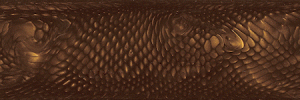

Juma plate comes in a golden dragon color/texture that might work for you. I don't know where they are located, but I found a US company called Atlas Billiard Supplies that carries it.
Here is a straight razor that Buddel made with it.
