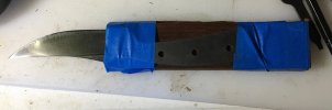

I also bought a couple of blades that needed sheaths for future projects, then I thought, what the hell, let's try putting some blades together:
Seems easy enough, non?

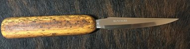

Time to do something with that Mora blade I got:
Messed it up by shortening the tang; I thought I was going to use a stag handle.
Also tried drilling it with a hand drill: no go.
So:
Some bocote I had laying around.
Glued up:
Then spent the next hour and a half doing some stock removal.
How I spent my Sunday:
I think I should have pushed it into the handle a bit more; not really sure how it was supposed to sit.
Didn't realize the half hole I made was showing until I had glued it up.
Looks like it was supposed to have a guard or bolster, but then again, look how far back the grind is?
Oh well. Letter opener.

I was looking at it last night and figured I could have saved myself a ton of grief and sawdust if I had just used a broom handle.
When school opens up again, I'll take it to the belt sander and give it some form.
On a side note, that Mora blade was kinda misleading when I ordered it on Amazon. They don't list the width and the picture makes the blade look like a regular size blade, not this sliver of steel I ended up with!
