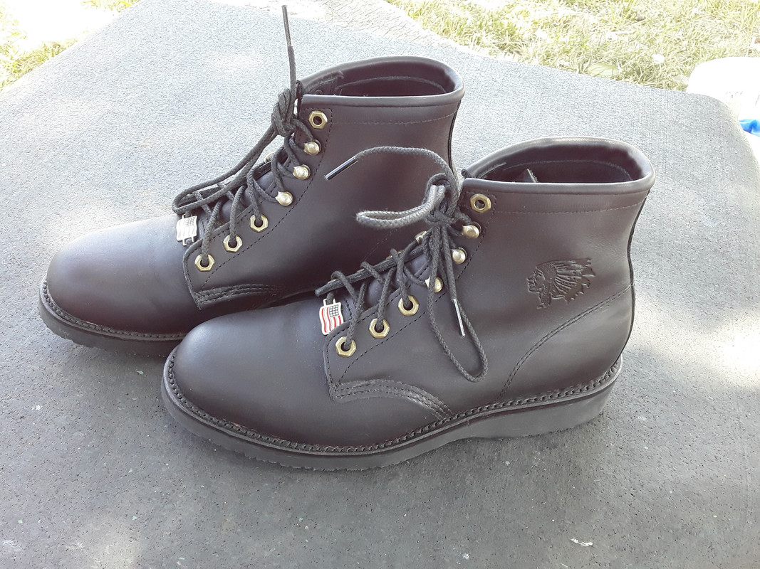

I've been needing a new pair of work boots and last week I found these nice recently discontinued Chippewas on sale for $99 and bought them.
They arrived Friday, and and after a little break in I decided to try them out today.
It only took 30 seconds to discover that the vibram gumlite soles on these are absolutely not slip resistant as they were listed, had to change back to my Justin's.
Adding my slightly picky taste for boots ( gotta be traditional, unlined leather, and American made ) to the requirement for slip resistant black boots at work I don't have many options.
Since I got a good deal on these and since I don't particularly like black boots for casual wear I really don't have much to loose.
I found a pair of Goodyear black wedge soles online ( manufacturer specifically lists oil resisting in the specifications) for $27, and then the quart of barge cement was $32 ( I was out and needed some anyways)
As far as I know it should be as simple as peeling off the original outsole, prepping everything, gluing on the new outsole and pounding the crap out of it with a mallet to ensure a good bond, then trimming off the excess and finishing everything up.
All said and done I'll have about the same in these boots as I would had I not got them on clearance, except these will be an oil resistant wedge sole.
If all turns out right these could turn out to be one awesome pair of boots , a sence of satisfaction, and the start of a new skill in my arsenal of repair knowledge.

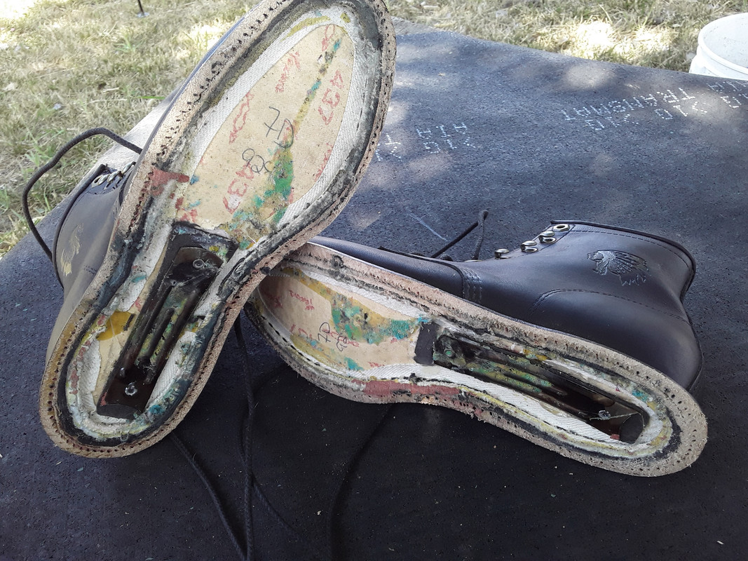

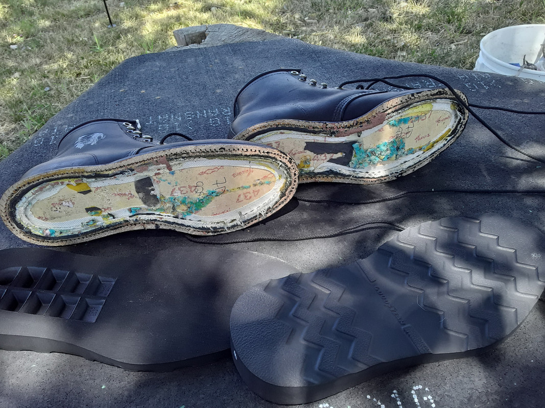

My soles came in and I got started.
I had hoped to just peel off the outsole and replace it, but while everything went okay on one it did not on the other, so I've gotta replace the midsole and all of that stuff.
I may need some different thinner leather I can use in place of that foam filler they used, but I'll look around and see what I've got

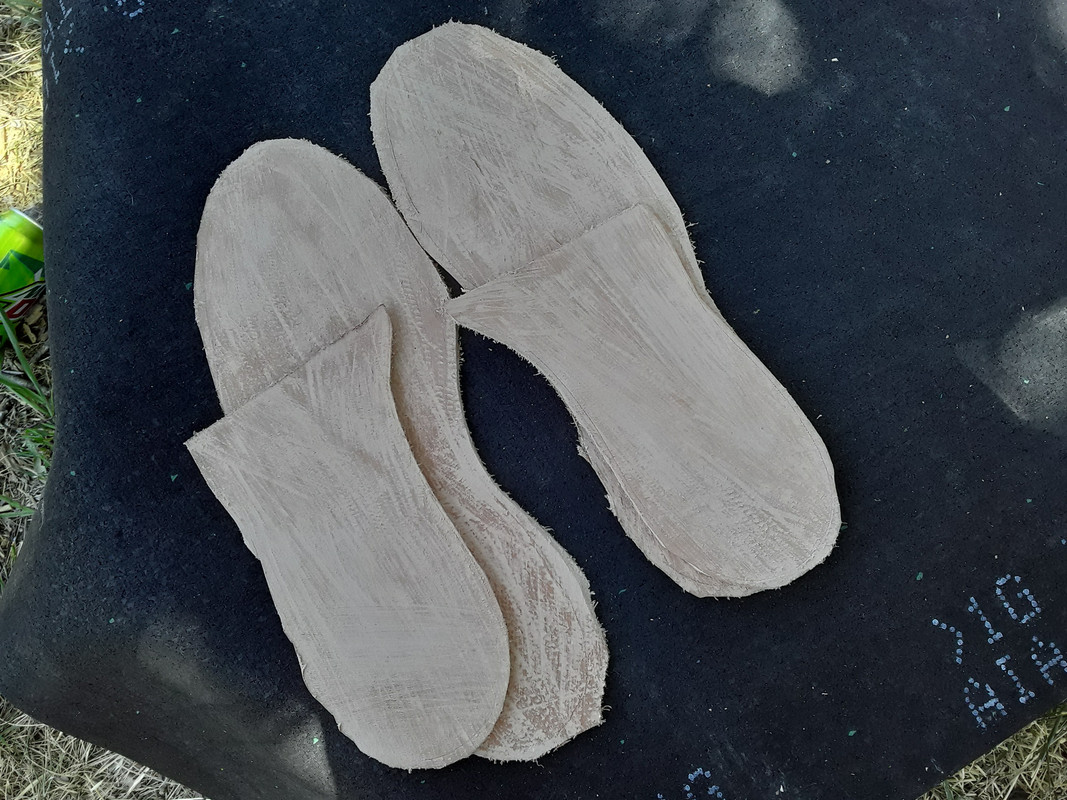

I've already got the midsoles rough cut out and the smooth side roughed up, didn't have the proper tool so I used a rasp. Wasn't great but it's good enough for the glue to bond to I hope.
Got the shanks glued back in and the the filler pieces cut out.
Now I've gotta come up with some kind of solid last to put inside the boot so I can pound everything well while gluing.
I just hope pounding will be enough and I can get it done without a press.
Putting this project on hold for a bit, I ordered a pair of V hinged lasts online and can start back up again when they arrive.
I could only find a 5.5 which is kind of small but for a resole it shouldn't matter.
I can always build them up with epoxy putty if I really need to.

Well when I eventually those lasts in they weren't going to work and I rerealized that without something solid inside the boot It would be hard to get a good bond between the sole and midsole that I could trust at work, so I tossed the boots in a closet and forgot about them.
Fast forward 2 years to today and I'm thinking about a chukka boot or something similar for home, a lighter weight / duty shop boot that's quicker to put on than an 8" and more appropriate in the summer.
I remembered I had these in the closet and decided to see what I can do with what I've got , and hopefully have something suitable for my needs when I'm done.
I don't know when I'll get them done since I'm gonna be really busy the rest of the week and hand stitching a midsole to a welt takes a long time, but I'm gonna try and do what I can in whatever free time I have and hope to be done by the end of next week.
At this point after realizing I couldn't make a work boot out of these I do wish I had just left them and put 'em to use as is, but it's too late for that plus I'm still learning something and hopefully I can say I've successfully resoled a pair of boots myself.
I found time to " finish " the one I started on.
Right now I'm not sure if the bond of the outsole went any better than it looks, but once can get the other finished I'll test them out and figure out what I might have to do from there.
