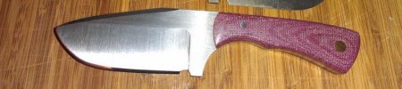

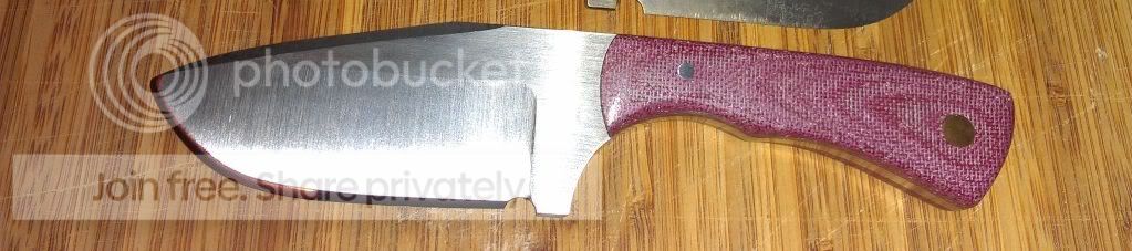

One that my wife digs (though not quite finished), with a kydex pocket (purse) sheath; OAL 7.25", 3/16" x 1.5" 1095
