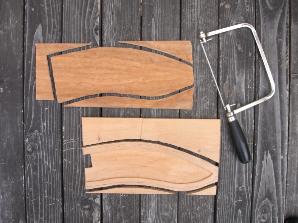

Darth I made me a wood sheath for my WWII. I made a post or a thread about it here but gosh durned if I can find it now. Mr. Steve Tall my resident historical expert can probably find it in 4- seconds, don't know how he does it.
I used a soft wood, mahogany I think only because it's what I had on hand. Almost a veneer, not very thick. I just cut some soft wood strips to make the spine, to allow for the thickness of the blade. I remember I used chopsticks on the blade side glued into the corners to keep the blade centered and also act as a guide to put the blade in the sheath. My plan was to cover it with leather at some point but I never got around to that.
I put a couple washers inlaid into the wood to attach a camera strap too and it works well. I got lucky and the blade kind of snaps in and is rock solid.
I may still have some pictures some place, I'll have to look around some.
