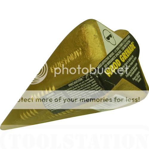

I have a thirteen pound all steel maul that i got from Bailey's Mail Order Logging Supply. I don't live too far from one of their two stores and i picked it up years ago. I'm 6' 5" and weigh 294 lbs and have struck wood with that maul every way possible. One time i split 24 inch cuts from an entire Elm tree and my uncle came by after i was done and told me you couldn't split Elm because its too stringy. I don't think you could run over it with a log truck and hurt it.
I use this
and a fifteen pound sledgehammer for back up.
Johnny
The Wood Grenade ROCKS! Just be careful, since it can come flying out of curly knotted wood pretty forcefully. The important thing is that it actually gets that stuff split! :D
