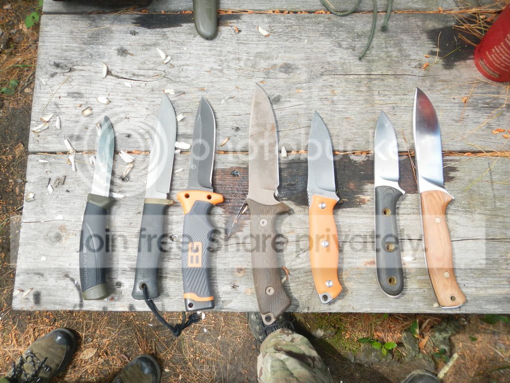

i had these knives out just today to play with them and whatnot and i did a bit of comparison cutting and a bit of abuse to see how each ones characteristics fared and from left to right we have a plain carbon mora, a fallkniven S1 ( VG10 laminated) gerber bear grylls ultimate (9cr13MoV ), spartan Harsey Defensa (CPM S35N), G.E. Chen Duty in 3V, and two of my own, first small bushcraft is in 12c27 and the larger wood handled one has been my work knife since 2010 in 440c. I spent the day hacking brush, making fuzz sticks, traps and batonning firewood with all of them minus the mora and even for giggles, i hammered each one about an inch and a half into an old stump and stood on the handles to see if they could take it... I'm currently 201Lbs buck naked and i stood or bounced on each one until it came out... broken or not, and they all did with all of them prying out a huge chunk of the wood rather than breaking, minus the mora which i obviously wasnt going to stand on at 1/16" thick, it woudn't have been much sense. To be honest i was worried that one of them might break but the worst that happened was the gerber bent and took a pretty good set (pictures on the "knife reviews and testing" forum since i just had to know how the gerber would hold up after hearing all the hate). I knew the 440c one would be fine since it's a full 1/4" at the center although it does taper distally toward both handle and tip, but the others i was not as sure since they were all thinner at around 3/16 and had finer tips, but they all came out with hardly a set to them. All that to say that it's possible to get a lot of hard use out of a wide variety of steels given the proper HT and geometry. could something as fine as the G.E. Chen survive if it were 440c instead of 3V? i can't say but with the geometry i used and Rob's awesome HT it is more than formidable and i've never felt like i've been lacking in the blade department since i started carrying it back in 2010.
