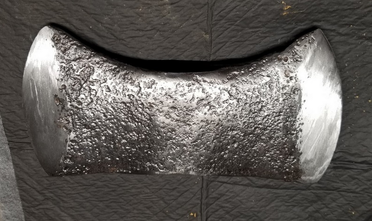

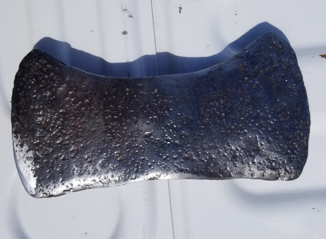

Hello All and Happy Thanksgiving,
I'm working on an old Kelly axe head which has a nice patina that I'm trying to preserve, but still clean the steel up a bit to highlight the phantom bevels. The old patina is a mixture of dark brown and black deposits. I'm using a brass cup type wheel but instead of running the risk of swirl marks, I'm spraying wd 40 and scrubbing with it by hand and using some scotch brite pads. I can scrub some areas and get a rust red deposit worked up, so real rust removal. After working some of this off there are also some black deposits that don't look so bad. These are also just in separate places on the face. Doing some reading, I found info about a black type of rust or deposit that may actually be protective. One article had a process to use tannic acid to cause a chemical reaction with the steel that produces a black coating that helps protect the steel. Ive tried a black tea soak with a dark gray result.
See below:
Does anyone have thoughts on the differences in types of rust and maybe which one to leave alone? Thanks SwedeFP

Yes,you're on the right track with your thinking.
Oxides are Inevitable,"Nature abhors clean shiny metal":)
Some form of stable,non-proliferating oxide is the best finish.
I wish i wasn't such a space cadet and have derived more out of all the endless discussions that i've ever held with other metalworkers on the subject...The Japanese(of course)were aknowledged masters in patinating,and i've seen some examples of conversion of red to black Fe oxides done with some of their traditional techniques...Very impressive,VERY black,some of them were.
(i want to say that such products as "Ospho",i.e. phosphoric acid-based goop that can do that).
Long,long ago a gunsmith friend who tried training me in keeping my firearms decent has lost patience with me and said that the right finish for the beasts like me would be "browning"
(like Brown Bess et c.,a very traditional and practical finish in the past).
I've looked into that a bit,and it was definitely cool-looking,(and i'm sure very practical).
Vs converting to Black it involves cultivating some stable form of Red oxide,then using it as matrix to hold an oil finish...Pretty looking stuff...
But yes,some type of off-the-shelf chemical patination like Brownell's is probably the ticket.
From what you describe probably a light wire wheel brush would serve you best, go slow & you can remove very little or everything & anything in between depending on your taste. Brass brushes used aggressively enough will actually deposit brass onto steel.
As a rough guide any rust that comes off relatively easily is bad, anything that's really stubborn to remove probably won't do too much further damage as long as it's oiled or waxed or cut of from the atmosphere some other way.
As has already been said, gun blue can look good if that's the look you're after.

Brent seems pretty bitter in general, don’t let it trouble you. Both posts I’ve seen usually contain some information up front and lapse quickly into an off-track, inappropriate dump on something.
in my experience, I only worry about the Orange/red rust. The other kinds don’t exhibit the penetration/corrosion that red rust does, and inhibit further growth.

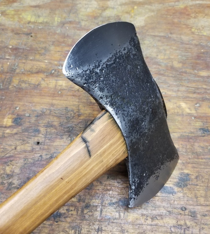

I love rust, rust is awesome! LOL. A light wire wheel and then oil the heck out of it. That usually gets me pretty close to bring out the patina. I have dabbled with the cold blue from time to time. But you can't replicate that beautiful natural patina hiding under that rust. Best of luck to you!!

I just tried the link and it opened up. It was about using tannic acid to stabilize rusted artifacts for preservation. I doubt I'd go to that extent by getting tannic acid. But, I have tried the black tea soak method and it was ok but not dark enough.

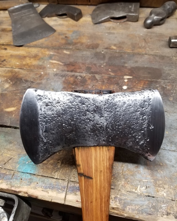

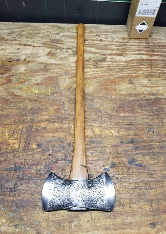

Meek1 that axe looks awesome. Don't know what it is, but that cleaned up pitting with patina and clean smooth sharpened bits just look mean and bad. Reminds me of a very worn but rehabilitated Kelly Perfect DB that Buckin Billy Ray Smith put on his YouTube channel not long ago-it was nicknamed Barbarian, and he did some awesome splitting with that axe. Just another testimony of how good of steel these vintage axes were made with.

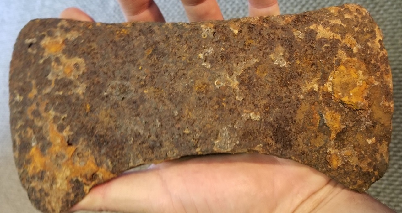

I am no authority on this stuff. All I have is my own hands on experience gleaned from tips by fellow metal detecting buffs. I have found many modern axe heads. Modern to me is 1900 to now, buried and dug up while metal detecting. I have used electrolysis on them to remove rust, or just left them in a pail, soaking fully submerged in cider vinegar. Check the head every few days until it's where you want it. Either way I wash off under a warm tap and scrub it up with a brass wire brush. In the case of my fur trade belt axe from the 1700's, along with a lot of other fur trade iron, I go further. I "bake" the iron on low, 200 or so, in my kitchen oven for several hours to ensure that the piece is bone dry. Then when cool enough to handle, I slather it with Conservators wax, as used in museums. It seems to suck right into the iron. Any more than two seperate coats can result in a waxy haze, try to stick with one saturated coat applied on warm iron. The wax comes in a smaller silver cylindrical tin. At least the stuff I used does. This seals and stabilizes my fur trade iron artefacts. The hundred year old user heads, do with what you want. Paint, oil, whatever. Just use them. They are likely light years better than the China junk.
Once you get the majority of the flakey rust off you can convert the red oxide that's left to black oxide by boiling it for 10 minutes. Cold blue products won't protect against oxidation like true black oxide does.
