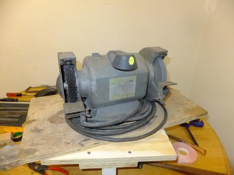

my drill press goes down to 600rpm. i know that to not really slow when talking about drum sanding, but it should work when i am just removing stock before final sanding.
that grinder i have spins like a demon, but i have plans to put a reostat on that thing so i can slow it down. kinda like a dimmer switch. i have used things like that in the past too. its not ideal and not what i want to do, but its what i have and what i can do for now.

Drill presses and hand drills have thrust bearings which are not designed for a side load. Routers, shapers, and spindle sanders have side load bearings. Mills have both. If you use a drill press to mill or drum sand, you could loosen the chuck which might go air born.

Won't work. Grinder or controller.....It will burn one or the other up. Most single phase motors can't be speed controlled. Dimmer switches and rheostats use one of two systems. Either they clip the sine wave to deliver square wave proportional power, or they lower the voltage to deliver less power. The clipped power is like turning the switch on and off many times a second. The load of any larger motor will likely burn up the triacs soon. The reduced power provided by a rheostat will quickly overheat the windings. Places like HF sell them and imply that they will give speed control to any motor...not so.
600 RPM on a drill press will be far better than a burned up grinder. Actually, it doesn't matter if you ruin that grinder, because it will still do what it does best in the shop..... be a door stop.
