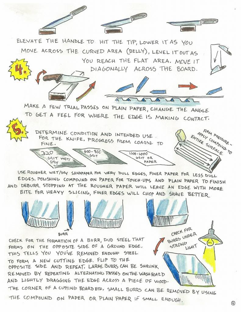

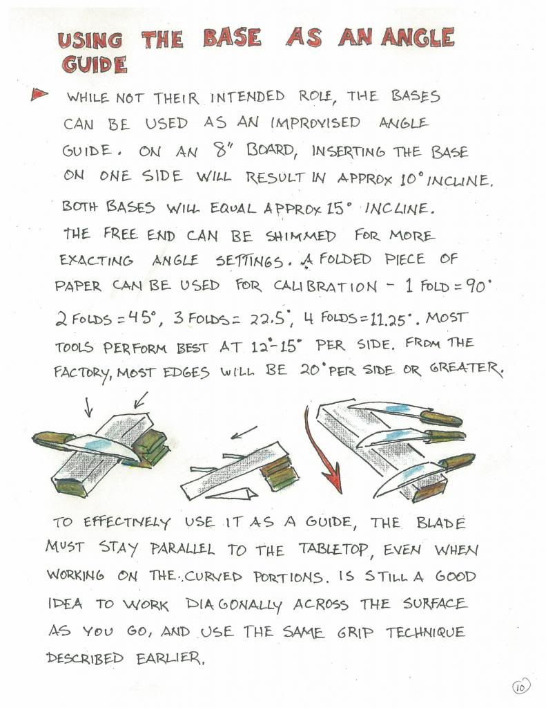

Included in the paltry price of a Washboard Kit are hand rendered instructions for this concept (on both a horizontal surface, and an incline) and much, much, more....:D
I must say that the instructions for the Washboard system are THE best instructions I have ever received with any product ever! They actually instruct! Martin, you should go show them how it is done over there at IKEA, lol!
Btw, I am using my Washboard right now to but the final touches on an edge before I ship it out.
Very cool illustrations. sharpening for dummies... lol
The devil's in the details, I always seem to grasp physical concepts better when presented as drawings, sometimes even more useful than video.
Occurred to me if you tilt your head 45* on that last incline illustration you get a decent perspective view of the progression around the tip when working with the block horizontal.
Next up might be a flip book - gotta keep it old school!

Can you believe I once got turned down for a job as a technical illustrator!? Something about needing straight lines every now and then...
Understanding the geometry of the belly and tip is important as it helps you figure out how to move the blade on the abrasive to keep the bevel flat. That's really what you want: For the edge bevel to be in flat contact with the abrasive through the entire length of the edge, starting at the hilt and ending at the very tip of the tip.
Watching the tip as you finish your stroke really is quite instructive. I found that I wasn't lifting the handle *nearly* enough to make contact with the tip. Once I did, my tips starting becoming sharper than any tips I had ever made, let alone felt from the factory.
