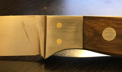

So, earlier knife #1 was a personal success. I went ahead and brought myself back to reality by goofin' up knife #2. While cleaning up the decarb on my grinder I ruined my plunge line. I'm grateful for the learning opportunity, but was curious what you guys think i can do better next time? I suspect i should have hand sanded this bugger post HT.
It is not ruined.
Back up the plunge a bit and do it again.
I was concerned i'd ruin the HT. What belt would you recommend for something like this?
I JUST redid a plunge line on a post HT yesterday... and it still had the scales on, lol. i was making a knife for my uncle but didn't like the final outcome, so i ground in a choil and centered the plunge line on it and it came out fine. just don't use gloves and keep it cool enough to be hand held and you won't ruin anything. keep your grit as fine as you can and use a new belt so you don't heat up your steel too much.
good luck.
Royce
Use a brand new 100 grit belt.
Many people grind the entire bevel post ht. You will be fine.

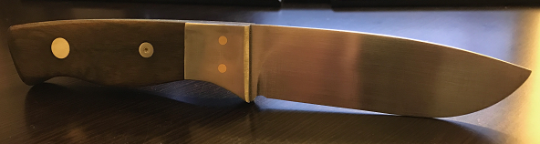

I'm not done yet -- I need to work up in the grit progression, polish, and sharpen. Here's a quick update and some thoughts:
1. hsc/// helped me square away the plunge cuts by sending me some tailored videos of a grinder technique. Thanks hsc///
2. corby bolts took me FOREVER to grind down. i obviously went too far on 1 corby, but not sure how i could have avoid this mistake.
3. the crack in the ironwood scale may be from over tightening the corbys or aggressively hammering the scales on at glue-up time. anyone have thoughts on which is more likely?
4. i gouged my blade pretty good, and have no idea how i did it. i stopped trying to fix it because i thought i may make things worse. thoughts?
5. i hate working/smelling ironwood. it looks/feels great, but this is likely my final ironwood handle.

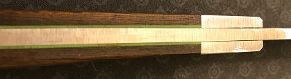

6. my bolsters didn't quite sit flush. i'm not sure if the epoxy or HT changed things slightly, but i was foolish not to test them before glue-up.
7. i used brass bolster pins because that's all i had, but i dig the look.
Thanks all. I definitely learned a lot so far.

like the rest of your work over time, it will become easier and your plunges will look better
Nice looking work and a tough project! I think you did great with it.
My tip would be to get some 1" wide scalloped belts and work on the underside of the bolster/bottom side of scales and into the scales to round it a bit more.
I really like your knife and I think you did a great job. As for your bolsters not being flush, I'll take a stab at that. This theory also pertains to full handle scales without bolsters.
When did you drill the holes for your bolsters? It appears that you have a nice distal taper going on from the pic looking down at the spine. If you drill holes before you taper or the holes end up out of alignment, you can end up with this problem. I always try and ensure my taper begins ahead of the front of the handle material so I minimize the possibility of that little space at the front of the handle. Otherwise, when you put the pins through everything, they hold it all in place and you can't close that gap in the front. I feel like I'm rambling...and hoping that makes some level of sense?
The last full tang I did, I tapered the tang and the blade. But, I was sure to run the taper of the tang up past where I knew the front of the scales would be. I cheat and use a big fat sharpie to mark both sides of the knife to help me see exactly where I'm at on tapering. Hope some of that helps. Again, nice work.
Jeremy
that makes perfect sense gudspelr -- in fact that is probably what happened. thank you
