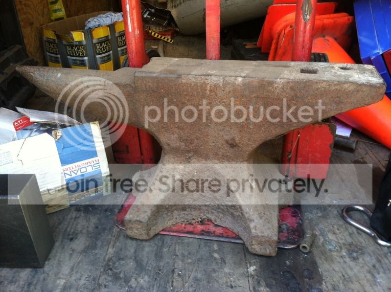

I called the guy and he said he had a 150# Fisher for sale still and a smaller Armitage/Mousehole. He said there was a guy coming at 1:00 to buy the Fisher....
I got there at 12:30....:rolleyes::eek::cool: (sorry man).... $300 and it was mine. Not a steal, but considering it's rebound and my love for Fishers it was cheap. :p It was made in 1907.
The trick was getting it in my truck without lifting it and the guy was 80 so he wasn't much help. Managed to get it on my handtruck and wheel it up my ramp into my truck!!

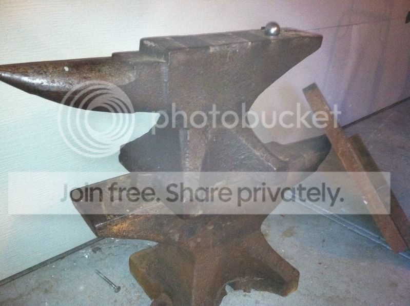

Here it is with my 1913 300# Fisher....
Look, they're buddies!
I picked up a 107# 1-1/2" plate for the base for my 300# Fisher last week and was going round and round about the height to mount it...:confused: The Fisher had so much better rebound than my 119# Kohlswa that I was going to mount the 300# 35" high for bladsmithing but that wouldn't let me use it for striking and using top tools.
I bought a 61# 1-1/2"x13"x13" plate for the stand for the Kohlswa last week too that I can now use for the 150# Fisher.
It's amazing. Both Fishers have around 95% rebound. Drop a ball bearing from 15" and all you have to do is slightly open your fingers to catch it on the rebound. While it's a good anvil, the Kohlswa only has around 80-85% rebound....:rolleyes:
Going to weld up a couple new stands next week when I'm cleared for lifting by the Dr.
I'll mount the 300# around 32" and the 150# closer to 35-1/2". :):)

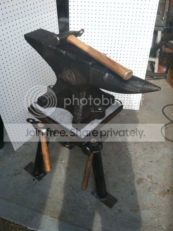

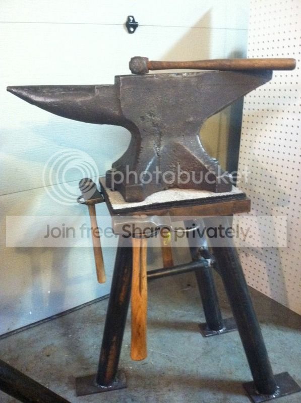

Made my stand today. 35" High to the face. Tri-pod style with a 1-1/2"x13"x13" top plate.
I have a 107# 1-1/2" thick plate for the stand for my 300# Fisher that I'll weld up next week. I'll mount my 300# anvil at 30" high for striking and using top tools.
Thanks Phil!
I put a piece of heavy(1/2") tar roofing material under it. I think I'll take my razor knife to it and trim it around the base so I don't get smoked out if I drop a blade on it. The thought was it would keep the stand from ringing, I snagged a bunch of random U-bolts from the shop and will add more after I use it if I find I need more tongs and hammers at hand.
I welded up the foot pads pretty well. Some of the stands this one is based upon have sand and oil in the legs to stop ringing. I am not getting any ringing as is, but it's a Fisher and they don't ring, so not much to transmit into the stand. I can easily drill a hole with a hole saw and add sand and oil if I get bored.
I only had a 120v Millermatic 135 to weld it with so I set up a heat gun on the 1-1/2" plate an hour before welding it and had it pre-heated to 400 degrees or so and the little welder got pretty decent penetration I'll do a couple more spot welds with a 220 welder on the connection to the 1-1/2" plate when I buy one in the next couple of months.
