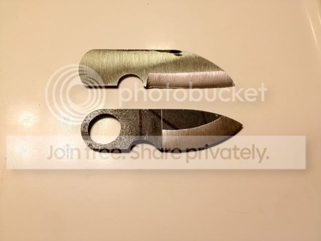

Off topic, below is a couple pictures of the 2 I ground today. The top one is titanium an is the first one I ground. I had a lot of trouble keeping the grind line straight as you can see. Not to happy with it but I'm just getting started in this hobby. I'll probly throw some jade g10 on it after I anodize. The next one is also a neck knife made from 154cm. Not sure what I'll do for heat treat on this, I found a company locally that does heat treat so I am thinking about giving them a shot. Let me know what you think fella's...
I have no idea as to your grinder question, but I will say that it looks like you're off to a mighty fine start with it. Congrats!

I'm suggesting you try a better brand such as 3M or Norton. I believe your grinding looks great for a start. I suggest as well,getting some inexpensive steel - non carbon - and use it for some trials. Frank
Thanks Frank. What kinda steel? Just some cheap stuff from the hardware store?
