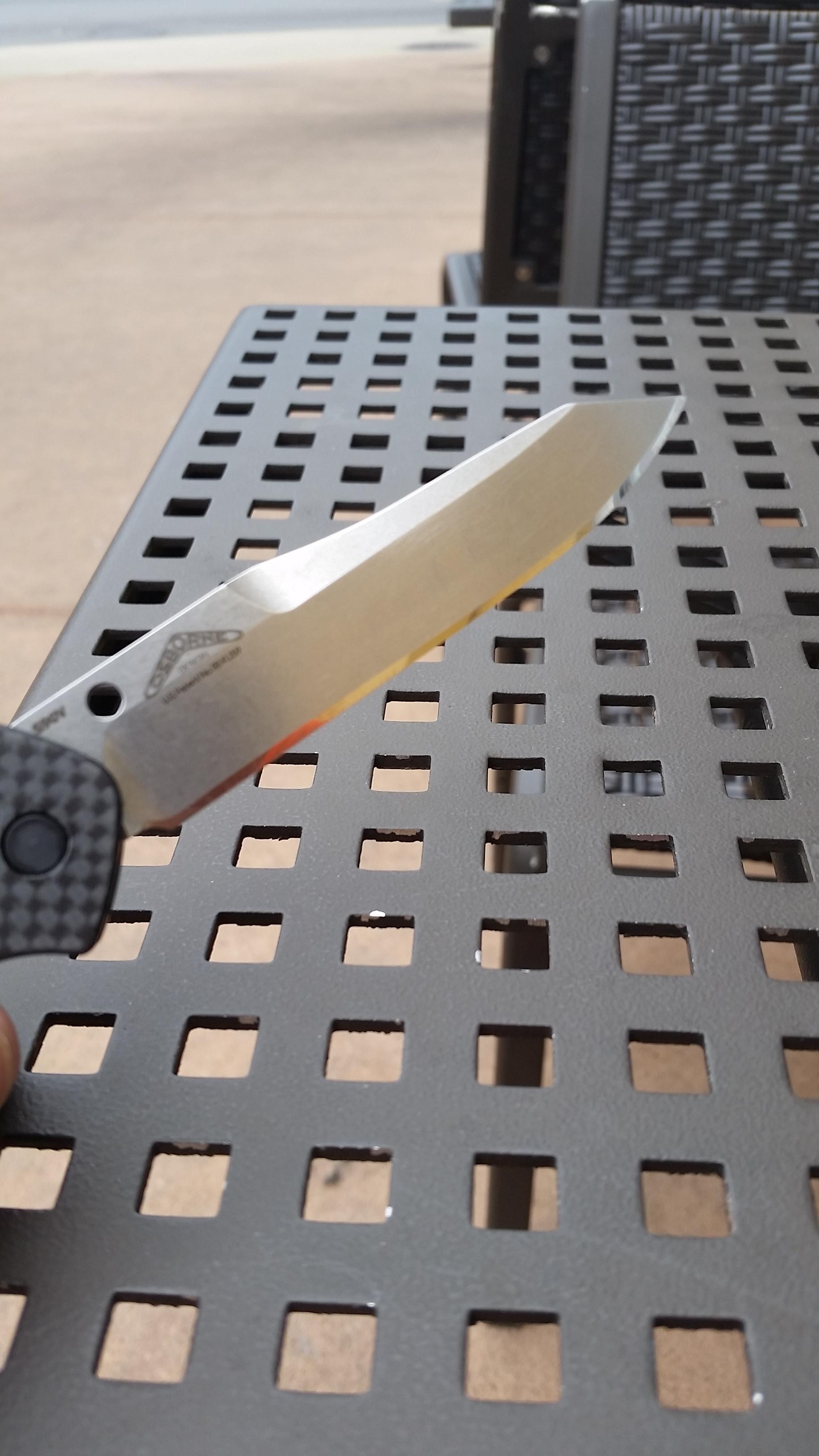

Wow this thing cuts.
Finally took my 940-1 ( was at about 26° factory per side) down to 18° per side.
It took about 2 minutes to shave off nearly 8 degrees per side.
Took it up to 6k for a pretty polish.
Jeez...cut through S90v like it was 01.
