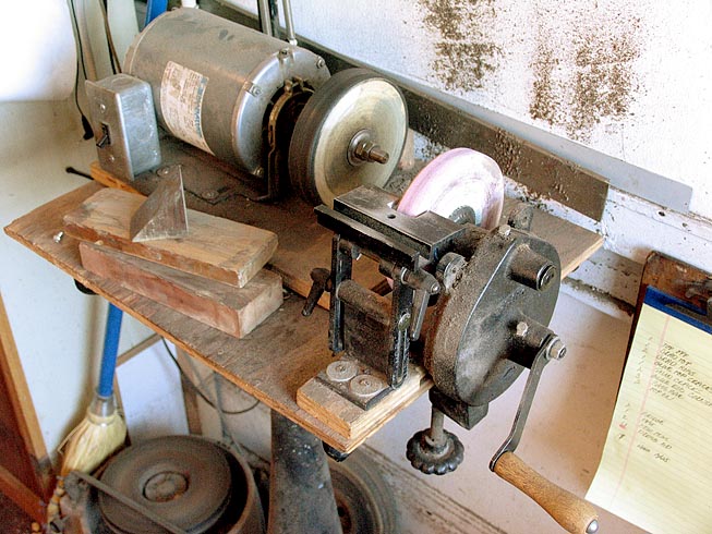

Some guys on woodworking forums use these to sharpen their chisels, since the low speeds won't heat the steel so much. They put the more expensive white wheels on these grinders, which grind cooler but wear faster (more friable). They also seem to unanimously recommend the adjustable tool rest/guide sold by Lee Valley, which will probably cost more than the grinder.
Here's a photo of somebody's setup, which shows the Lee Valley tool rest which can be adjusted to any angle for wheels up to 1" thick:
