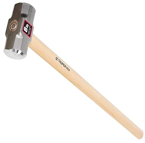

I've been sitting on this project for a few months... dropped in to Lowe's and pulled
the pick of the litter on sledge handles....not perfect but time to get it done. ($9.00). The
handle is a "Truper" from Mexico with American Hickory. (the same folks that bought out
Collins in the early 2000's). I removed all the stickers (see photos for worrisome California
legalese). Sanded coarse/medium/fine. Nice fit off the rack. Coated with BLO/Tung oil. Reasonably
good hang. Tight.
What I learned.... just for experience I thought I'd sharpen the metal wedge before application,
as this one seemed especially "blunt" ...seemed to make the insertion easier without cracking the
handle (which is usual for me !). I may make this routine.... your mileage may vary.
Looks and feels o.k..... but, haven't whacked anything hard yet. :cool:

Survivor... I too try to go American when I can.... this haft is definitely not without it's
detractors.... no cracks, no chips, no knots, some run-off, middle of the road grain spacing..but
grain in the proper orientation to sledge face. I've had better luck with House than Link...but,
pricier. I'm going to make an attempt to check the bins at Ace, True Value, HD, and Lowe's on each
subsequent visit. May be able to find a Prince after looking over a lot of frogs. I have not seen the
Vulcan brand here is Az. , but, have not been looking.

Thanks Steve ! Your data is never off topic. Thank you for all you provide this forum.
From what i've read on the Truper web site it seems like they have systematically grown
in to a major.... with "strategic relationships" with HD, Lowe's, and Ace Hardware. I could
not determine the providers of their "American Hickory". Thanks again.
Charles

Ha Ha! I still can't believe Commiefornia requires that sticker on a wood handle. Nice hang, though. Is that a heavy duty rated handle?
A17... Thanks... "heavy duty rated handle" ???? I was not aware a rating system existed.
I just saw "American Hickory" and thought it was good. What indicator is provided for the
heavy duty rating ? Thanks again.
