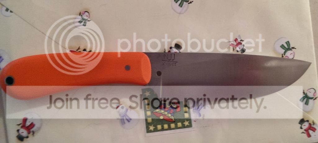

So, I finished this blade and was testing it like I always do and this little F#$*#$*&(#*$& crack appeared out of nowhere! GRRRRRRRRR! I didn't see or feel it until I was hacking up a 2x4...
Anyways... just had to vent. It's 0.140" 1084 4" blade and 4.5 handle... This is my first cracked blade... from now on I am going to test them BEFORE I put the handle on :)

Thanks for the tips guys. I think I will drill a hole at the end of the crack and just use it as a shop knife, still sucks though...
It was quenched in brine, I have done all of my 1080/1084 in brine heated to about 120 degrees. Not bad though, one cracked out of all of the blades I have done :)

Here is my fix
I wonder how long it will last?
If the rest is sound, I'd imagine it would take a hell of a lot to break it.
Think about it, it's got more meat than many folders, and they don't break that often.
That's a fine looking knife btw. It looks very sharp, I like the tip a lot, the handle looks comfy and your mark is kinda cool.
Looks good. I like the proportions of the knife too.
The fix looks good. Kind of cool that the hole has the same diameter like the pin
It should hold quite well. With the fixed crack all what happened is that the tang became a bit longer and the blade a bit shorter. :)
