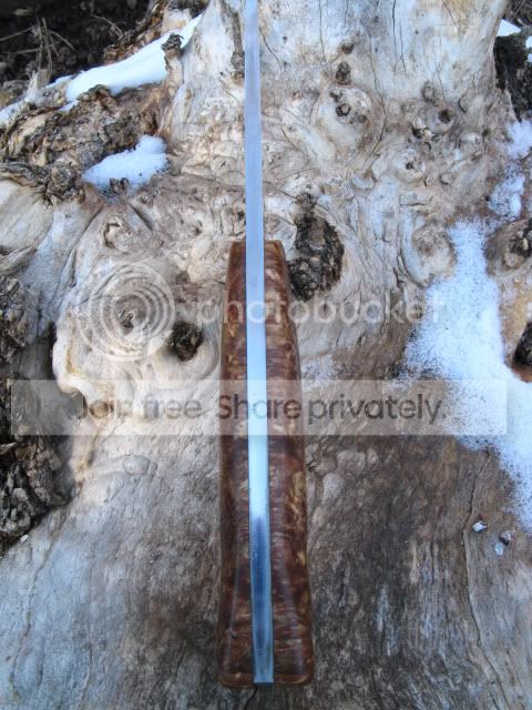

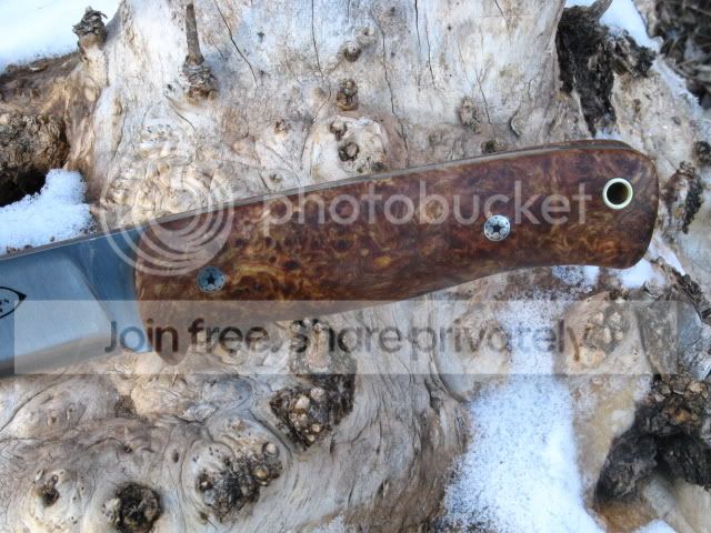

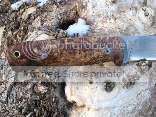

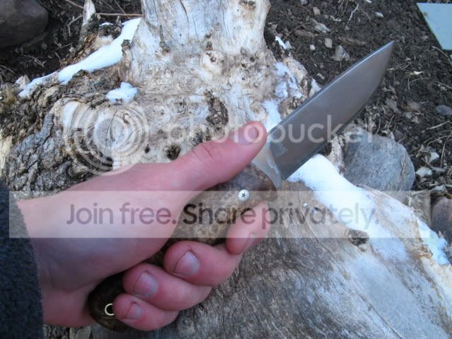

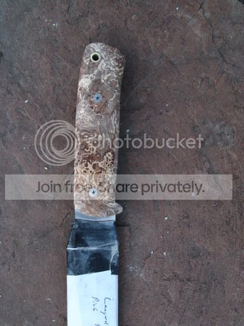

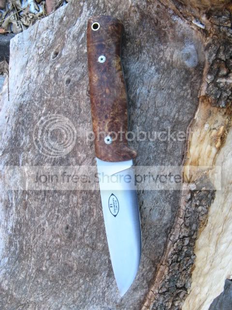

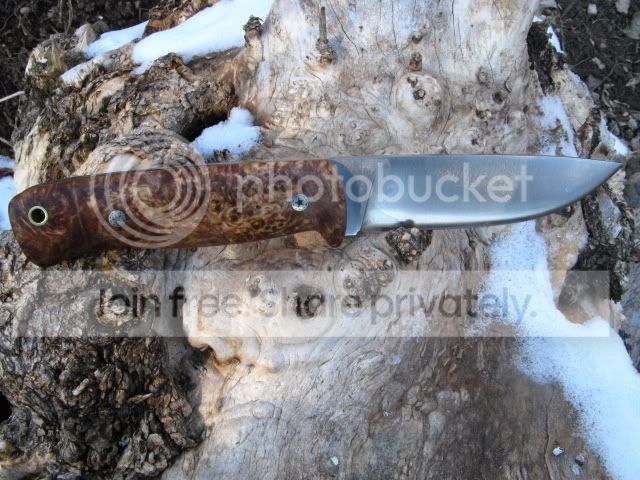

You can rehandle a regular F1 but you have to mortise the scales. I did that on my S1 because the handle sucked.
Ilbruche, how wxactly did you mortise the scales, with a chisel?
Did you do both scales equally or 1 with a flat scale on top?

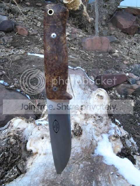

I did it with a Dremel using the little depth guide and the circular cutter.
Trace the tang on both scales and cut out 1/2 the blade width on each scale.
You could do it on just one scale if they were thick enough. But I don't think it would look as good.
I've reworked the handle since this picture was taken.
Great! My dremel has crapped out, that thing was handy as heck though, I should get a new one.
I want to put a slightly more sunstantial handguard on as well.

Wow, thats amazing, did it come with those sweet pins?
Did you contour the scales yourself? I really want to do that and get a great custom fit in the hand.
