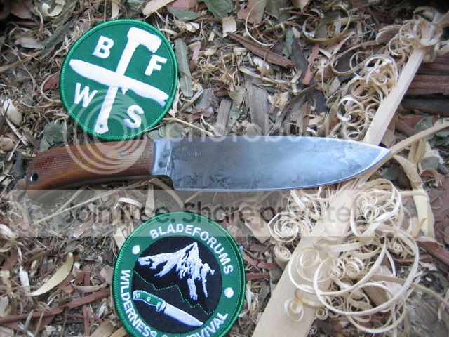

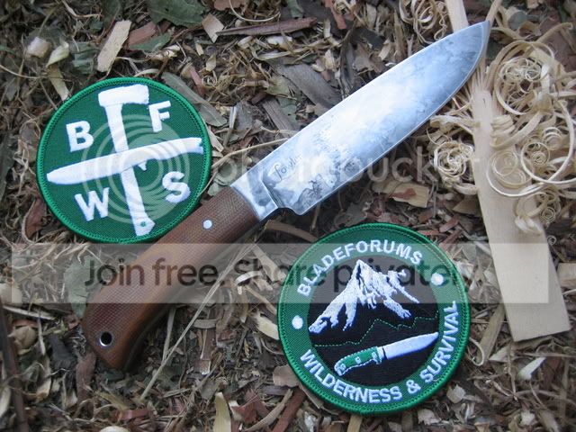

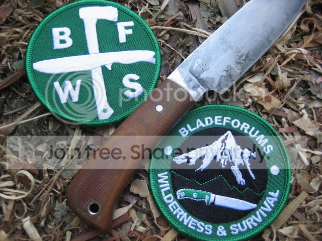

Here they are. New patches and new knife.
Stephan Fowler Knife
Nice! That knife looks great and the patches do as well. I am saving these three pictures... I am about to make my first blade and I like this shape a lot. Can you tell us the specs of it?

Mikel -
Steel: 1084
Thickness: 3/16
Blade: 4 1/4"
O/A: 8"
Grind: Flat with a convex edge
Finish: High grit hand polish with Hamon
Handle: Natural Canvas Micarta
Sheath: Brown Leather
Any other questions feel free to ask.
