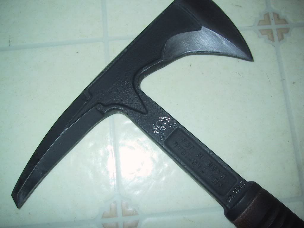

here's the head

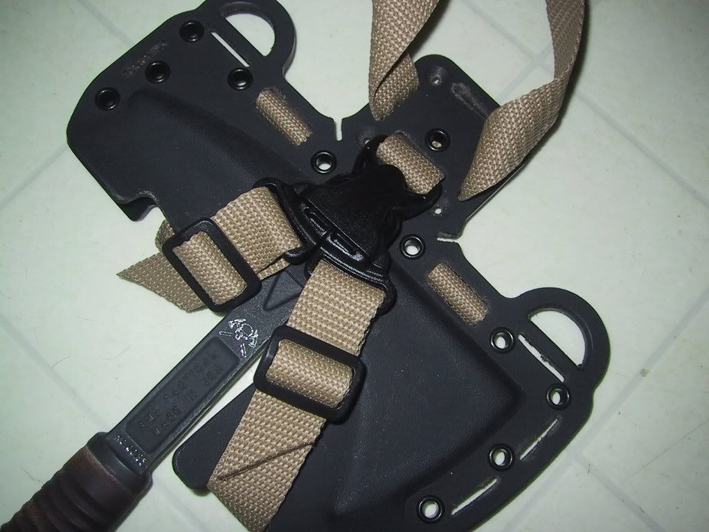

here's the front of the sheath

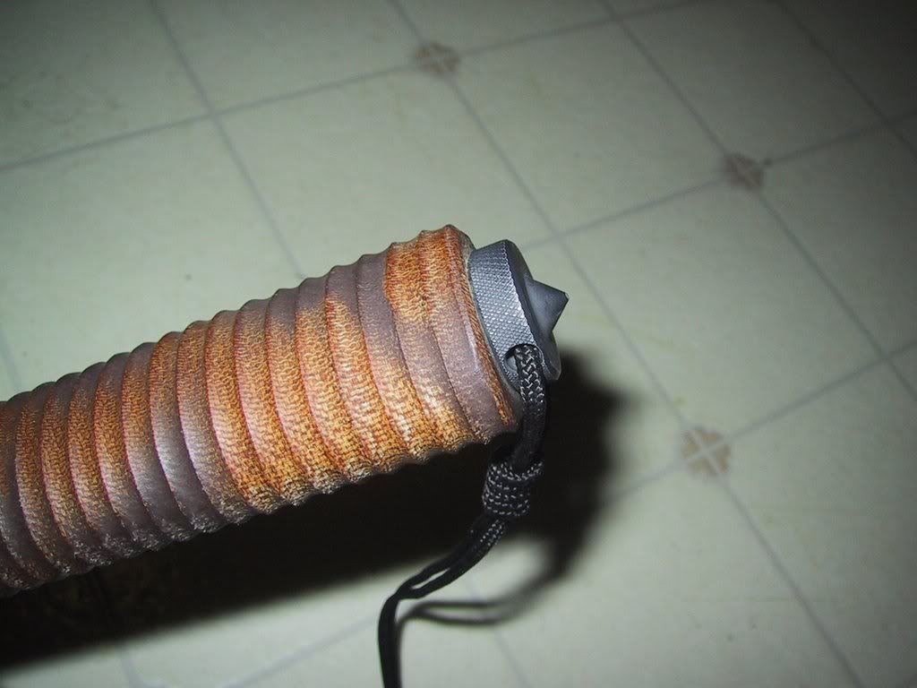

here's the pointed pommel that unscrews to reveal a sharpening stone.

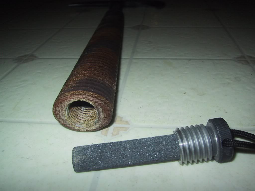

here it is unscrewed.i'm not sure what exactly the "sharpening stone" is made of.it doesnt really seem like a stone but will work.it also isnt attached to the bottom inside of the pommel and will rattle around inside the hollow handle and in fact mine broke in half from the vibration of impacts when striking objects with the SHRIKE.this pic is before the sharpening stone broke in half.

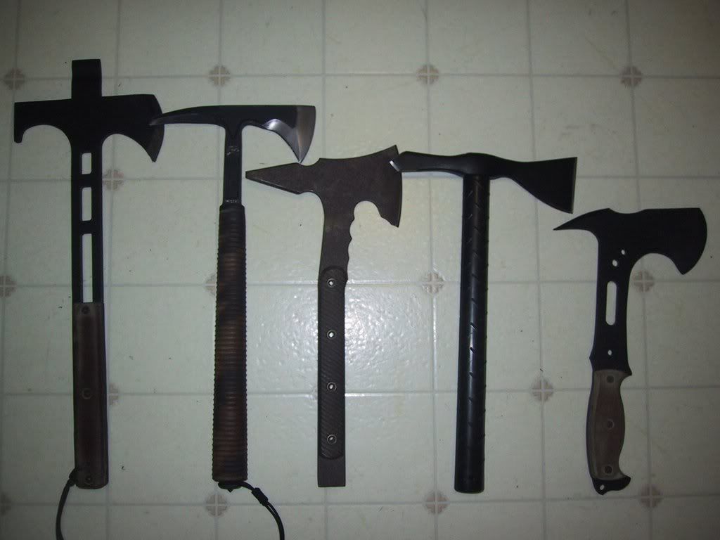

here is the SHRIKE next to some other pieces for a size reference
RANGER ENTRY TOOL,SHRIKE,SWAMPRAT,VTAC,RANGER RD-HAWK

the geometry and angles of the grinds on both the front edge,the beard and the spike seem to be right.i took the SHRIKE to some pretty thick steel as hard as i could and it did real good.
actually it was a BRINKS key safe and it chopped it to shreds.there was absolutely no damage,chipping or even denting to the edge whatsoever an it actually held its edge really well.to me it seems the steel and the heat treat where done right as it better be for this price.i was impressed.

first one is the sharpener breaking in half.also the fact that it rattles around inside the hollow handle.the whole in the handle is maybe 3 inches deep and the sharpener is about 1 1/2 inches long so it slides up and down inside the handle a bit which i'm sure contributed to it breaking.
i think the pommel that screws on and off should have a rubber O-ring to help keep it from coming loose because with repeated blows the vibration loosens the pommel which also serves as the lanyard loop.i did have it come loose on me but it mever come completely off.i do not know if it would eventually come off completely or not as i didnt use it long enough to find out.

the sheath is incredible.it actually is way more than i'll ever need as a civilian but it wasnt designed for me.it is extremely secure in the .125 thick kydex by itself to the point it is a chore to pull it out or place it back in the sheath.to me that is a good thing and will ease up over time.
add to that the double nylon strap retention system and it is very secure not to mention the many places to triple secure it by using 550 cord.this thing is beyond jump capable.you could jump from the moon and not loose it.the plastic hardware/buckles arent generic either which is important.
it comes with a over-the-shoulder nylon strap carry system that works good but more importantly the sheath will accept a TEK-LOK but you need to supply your own,at least i did.
bottom line is there are endless carry options and ways to rig it to whatever with this sheathing system.
my only complaint with the sheath is that while it is hard to get it in and out and very secure while inside it rattles while in there.it is still very secure but rattles quite a bit.thats not a problem so much for me as it is annoying but may be a real issue for some.

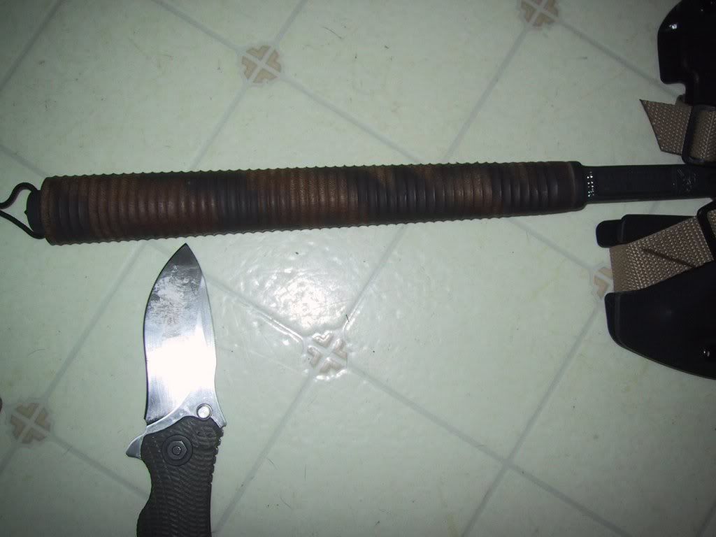

one last picture i forgot.this picture shows how far down the tang reaches into the handle.where you see the point of this knives blade is approximately where the tang reaches to and ends at.
