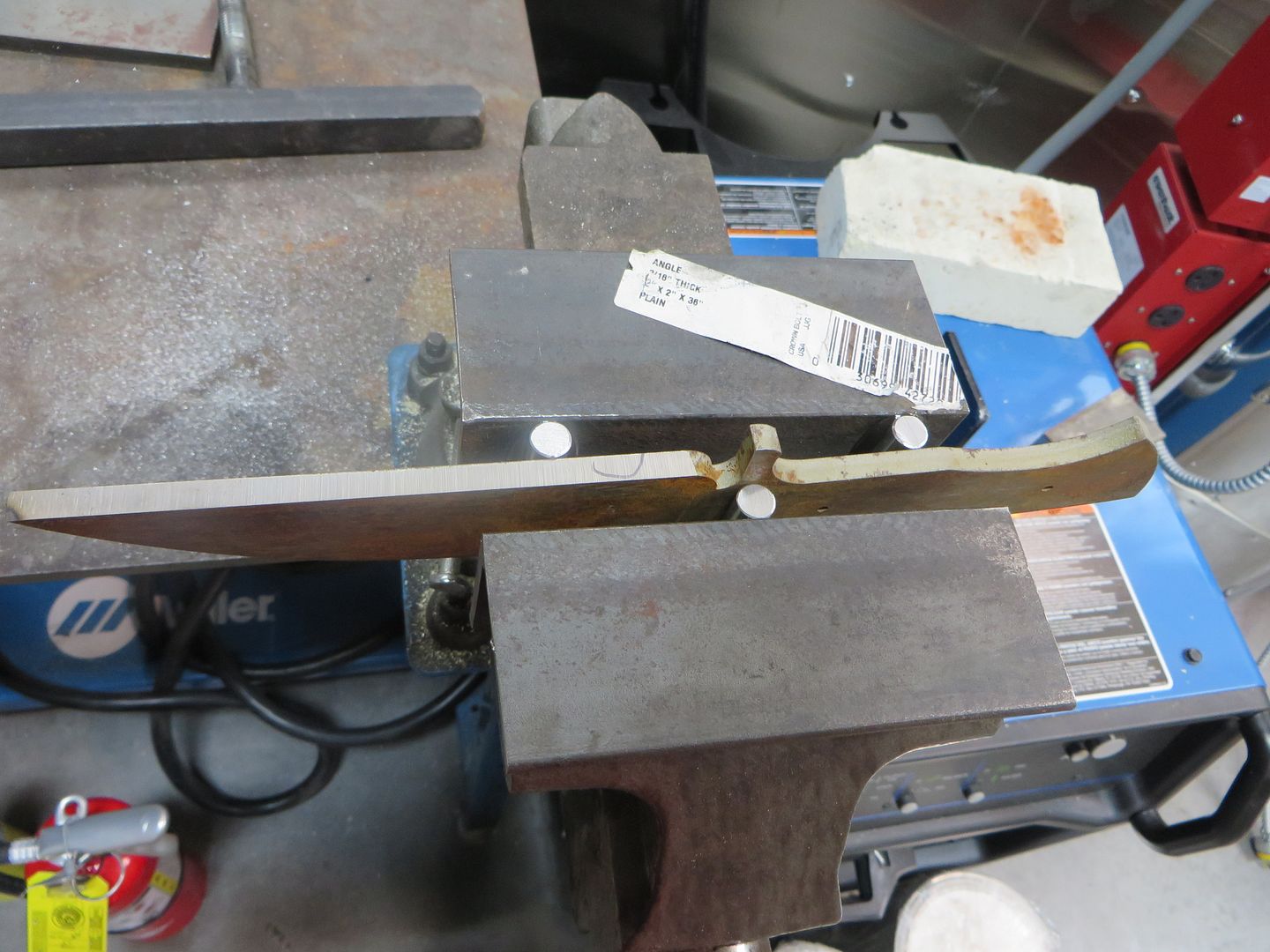

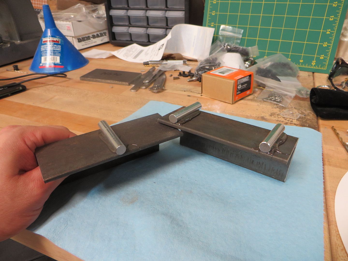

It may have been you that gave me the same advice not long ago. I made something similar. I used this on a large batch of 50 knives that I had water jetted out of 52100. I just used a piece of scrap angle iron and jb welded a couple of pieces of drill rod to the angle iron so I didn't have to try and balance all those moving parts at the same time. This way I can tighten the vise up looking straight down the bend and correct it as needed.
They do a little if I really put a lot of pressure on them. I usually don't put enough for it to matter. I do this before I surface grind them so it's no big deal for me. If you don't surface grind then you might want to use something bigger and softer so it doesn't mar your finish.
Like a wooden dowel.
So since I'm the op I figured I'd chime back in and say it is still noticeably warped after I cut the blanks. But a couple minutes of bending and checking on my granite surface I was able to straighten them.
Excellent idea! I have been using iron pipe held on the vise with coat hanger wire and getting them to line up and the blade in can be a hassle. I have a couple pieces of angle iron and some 3/4" mild round. Think I give it a go but weld the round on because I do 95% of my straightening with a hot blade.
