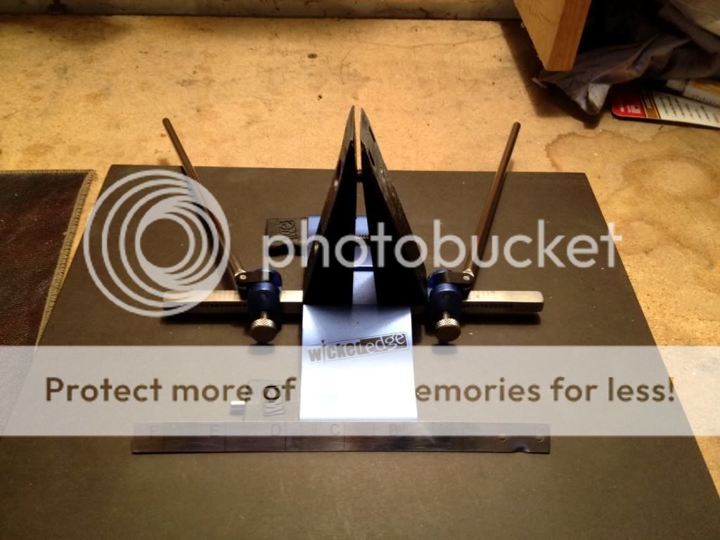

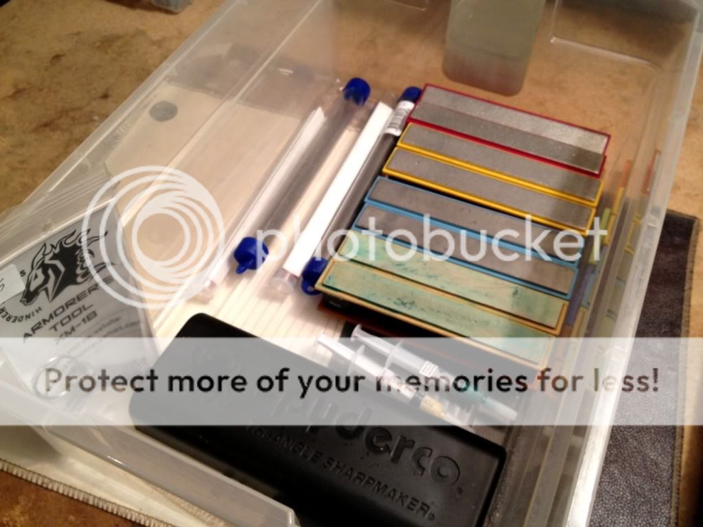

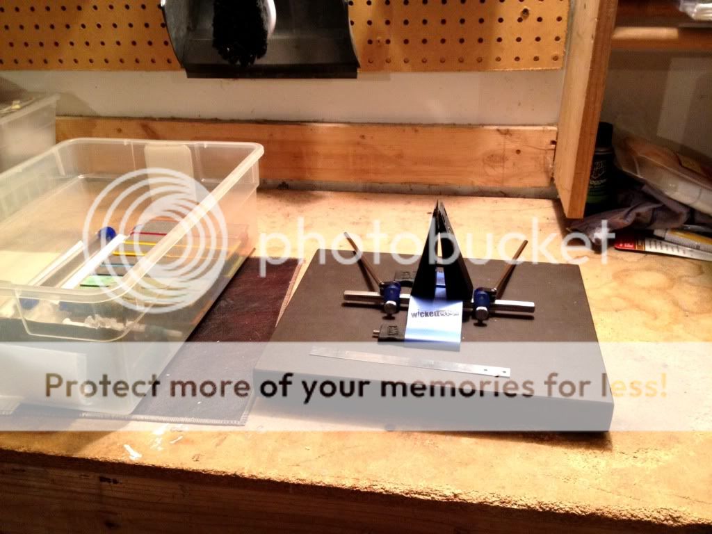

I did some clean up work on my work bench/gun cleaning bench/knife sharpening bench this past weekend. Here's my WEPS along with my tub-o-knife sharpening tools/accessories:

Man, talk to Clay! Those vise jaws look like they're bent BAD. That would explain your clamping problem for sure.
When it's working properly (and I'm fairly sure yours is NOT from those pictures) you can literally pick up the whole shabang by the clamped blade. I can do so with mine (paperstone base) no problem. And the rubber lining would just attract grit and scratch up your blades. :) Give Clay a call, if those pictures aren't deceiving me, those jaws look like they bent out badly.
I don't think they're bent.
Very well could just be barrel distortion from the camera lens, I suppose. The insides of those jaws should be perfectly straight. :)
The first pic shows them lining up perfectly.
When the jaws are apart the one on the right is free to move around. It's probably not perfectly parallel to the fixed jaw making it look off.
When the jaws are apart the one on the left is free to move around. It's probably not perfectly parallel to the fixed jaw making it look off.
Thanks - I just snapped these quick photos with my iPhone - lighting isn't that great at my garage work bench.

You're most likely right as I look closer, CTF. That is an ODD optical illusion right there!
