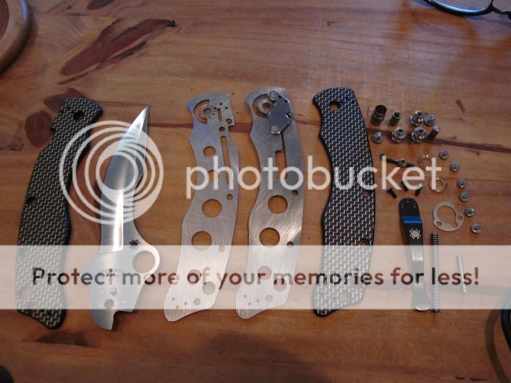

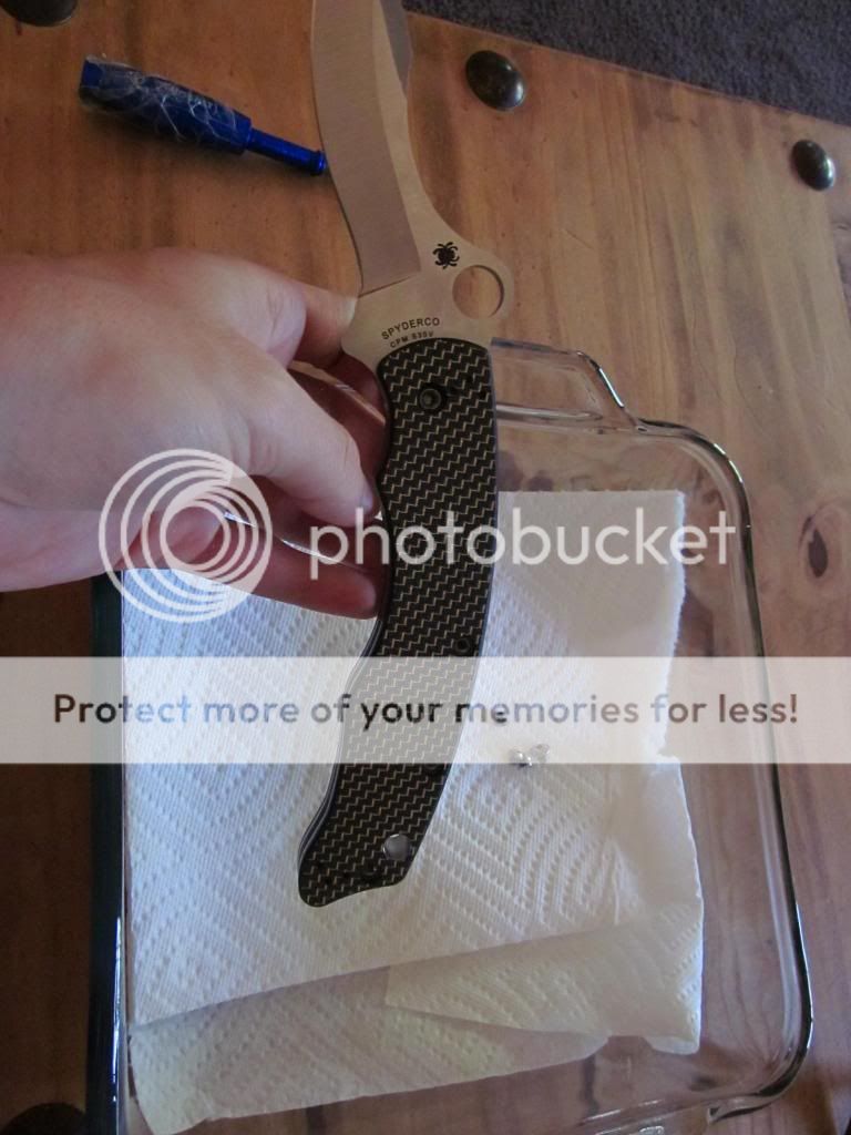

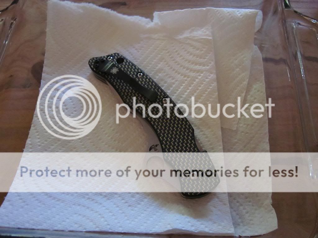

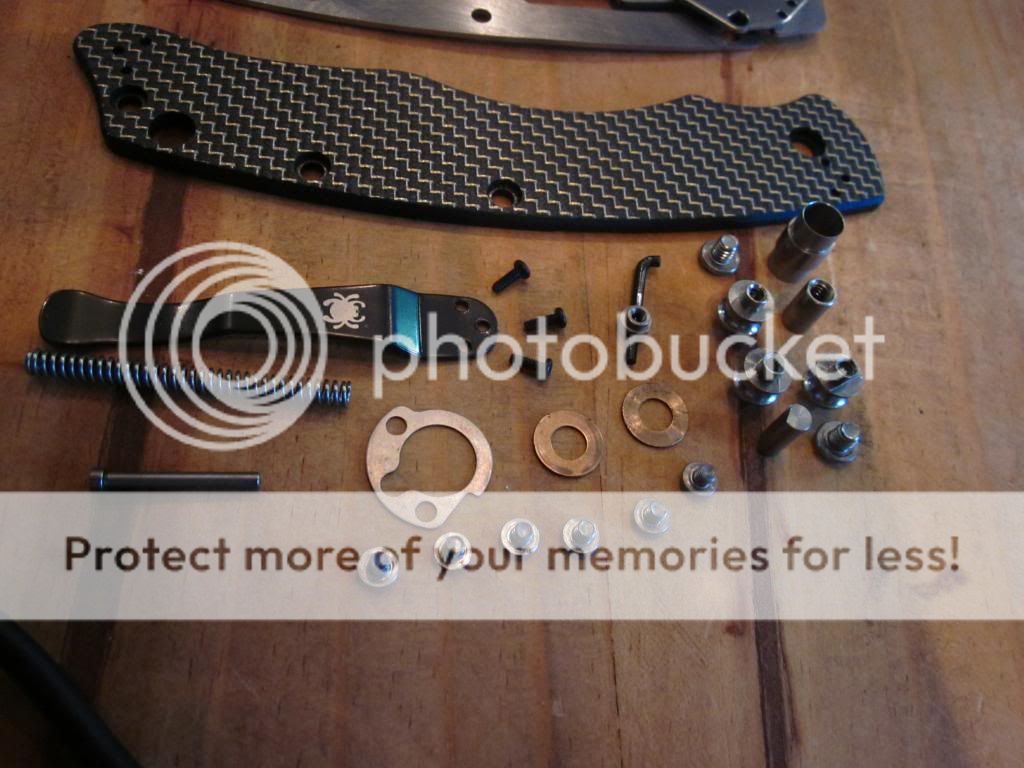

Well I've started the journey of taking the Szabo apart. I've gotten to the screws so far and will be updating this thread regularly as I get deeper into the knife.
I have the screws out and am having a time trying to get the liner/scale off. Gotta love these tight tolerances.

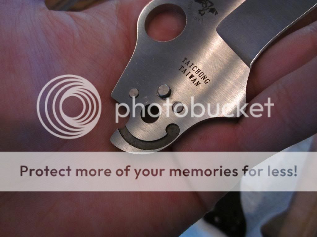

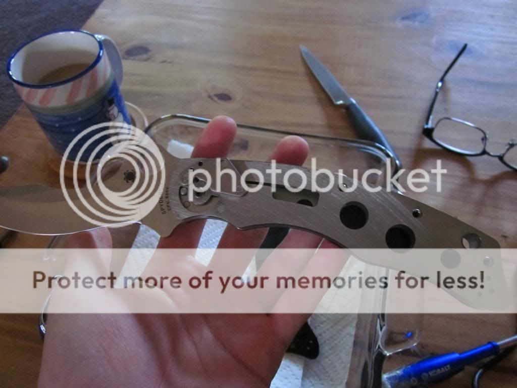

Here's some pics of the internals. It's pretty odd to say the least. Makes you wonder how they came up with this mechanism.

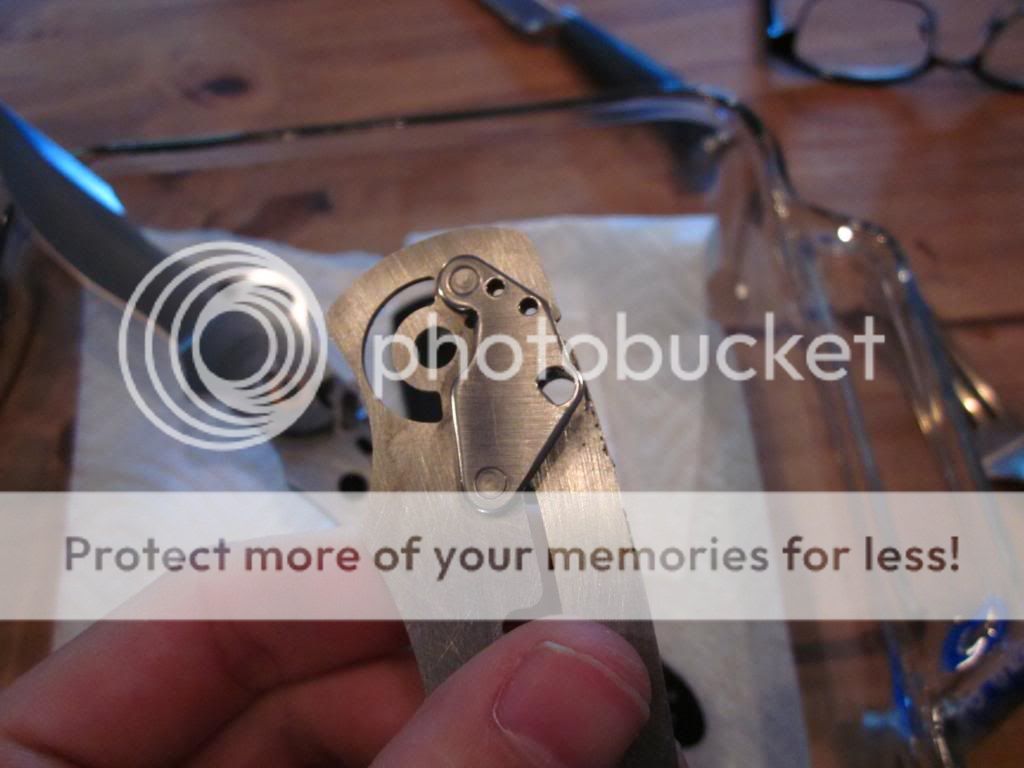

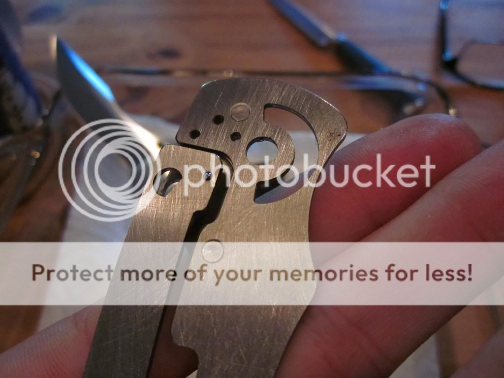

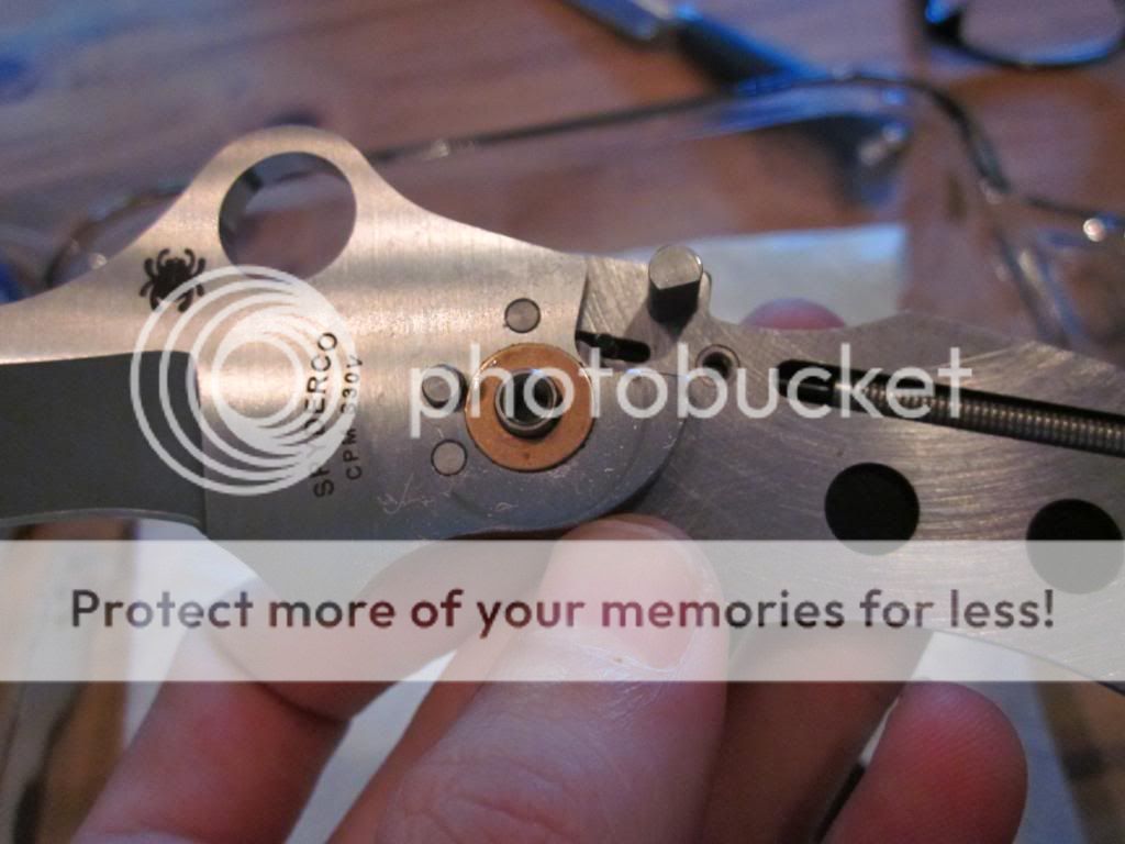

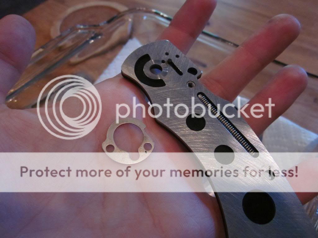

Other side of the blade. The self-close Mech. Bar rides in that channel and seats itself in the larger area at the end of the cutout to act as a detent in the closed position.
The self close bar pushes against that small steel plate which rotates with the blade via two small steel pins in the blade. It's in the open position in the pic.

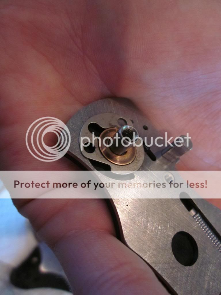

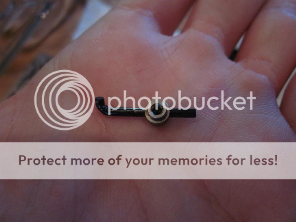

The spring and bar that guides it. These will fly out when you take of the scale they sit under so watch out.
The bar
The many parts that go into this knife.
This wasn't quite as hard to take apart as I was anticipating but it was a bit of a chore. I would NOT recommend anyone who isn't a tinkerer to take this knife apart. A lot could go wrong if you don't know what you're doing. This will also totally void your warranty just so you know.
I'm going to put it back together and wear a more of a noticeable detent track in the blade so I can drill a detent hole. I'll take some process pics of that as well.
Hope you guys somewhat enjoyed seeing the guts of this interesting knife.
