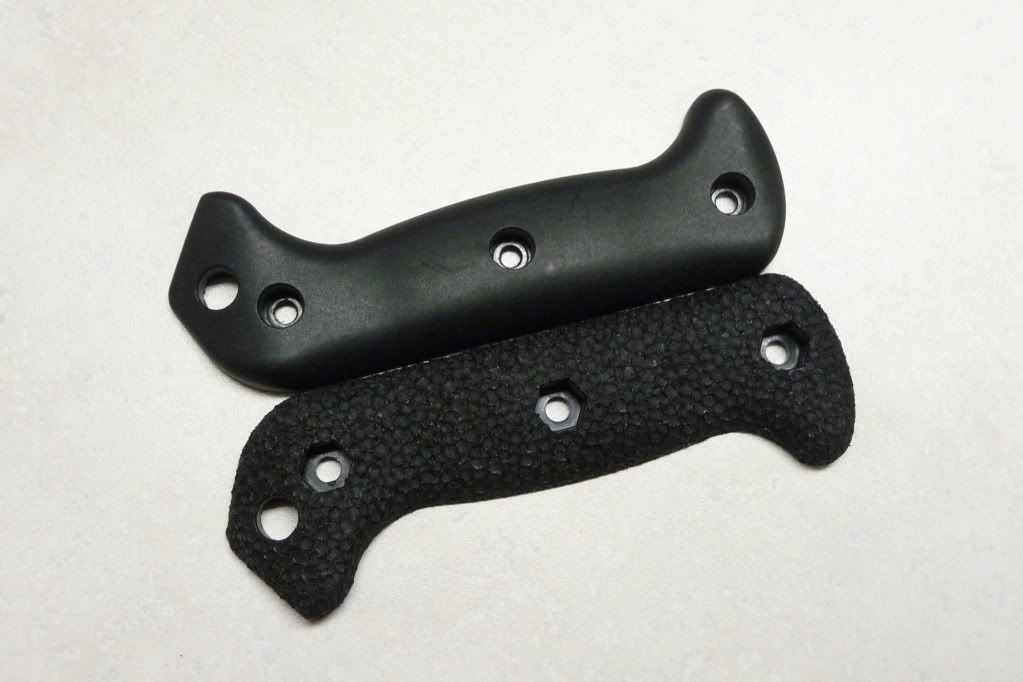

Got out the Soldering iron tonight

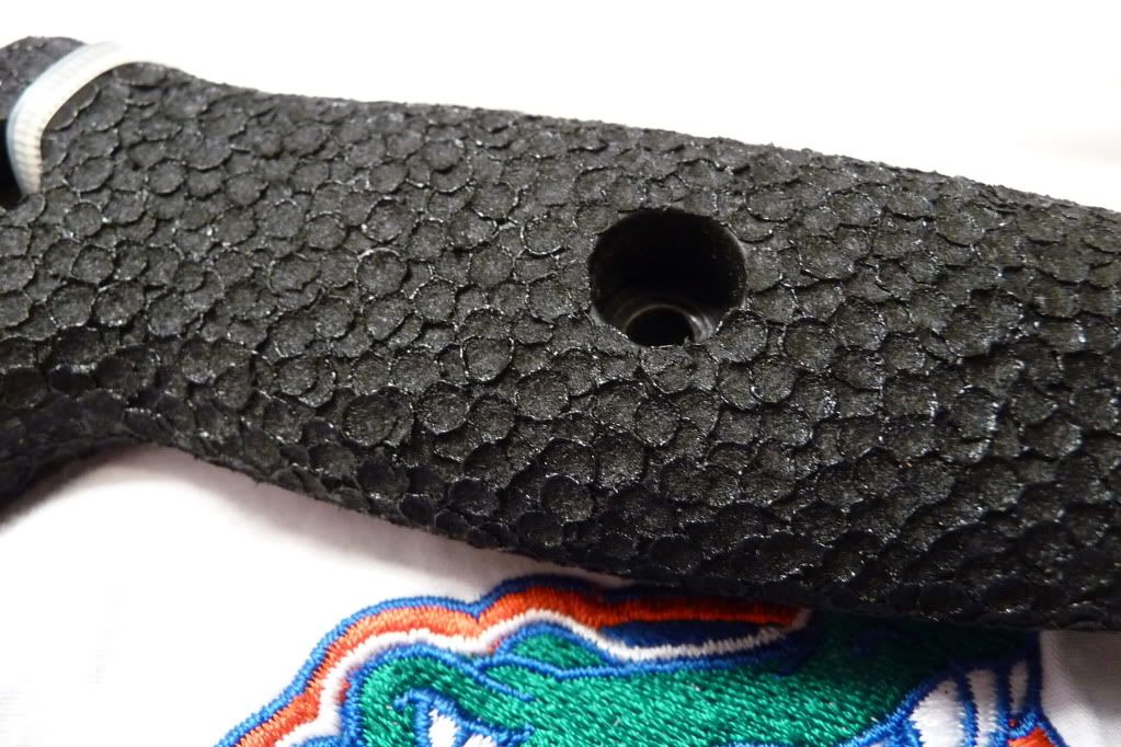

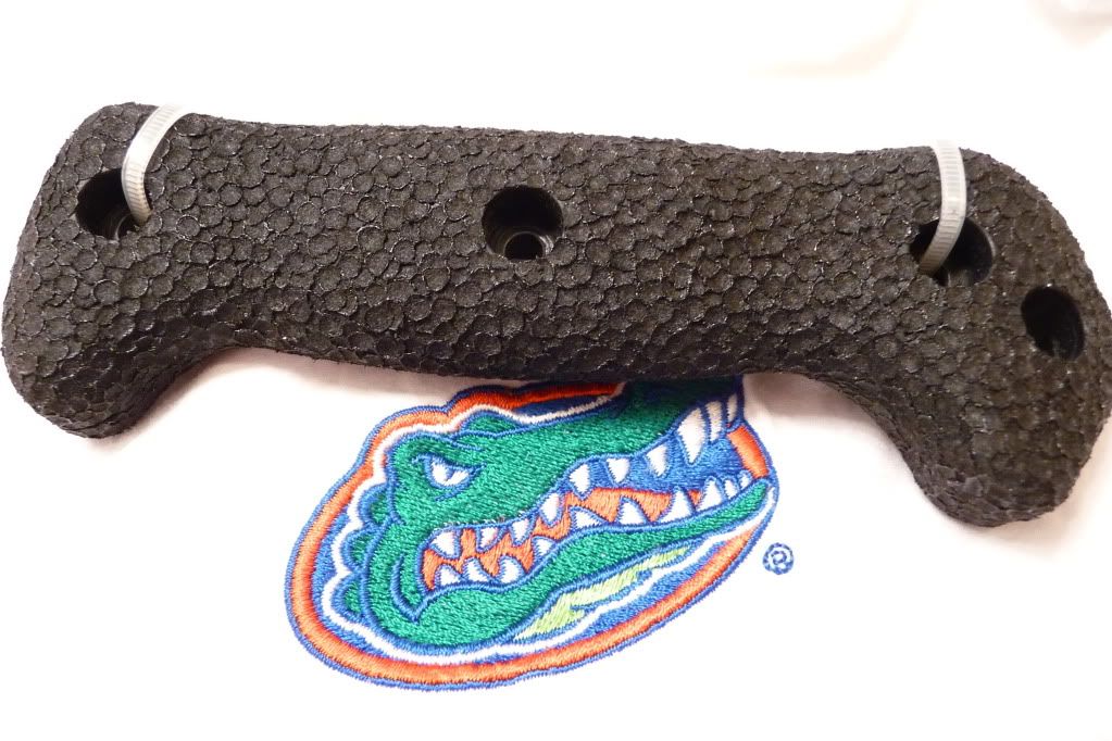

I just did another set tonight. I figured I might as well get it out of the way for when I order the BK5.
I used a different tip for the soldering iron and it looks more like a golf ball pattern on these scales. Pics to come in a little bit! :)
2nd set of the grivory scales stippled.
oh man i like the second one better! which solder tip you use? or did you make your own tip?
On the first set I used a tip that looks like a masonry trowel and the second tip I used looks like used No.2 Pencil eraser (blunt but a little round).
If you want to test how it will come out just pop the scales off and test it on the inside.
