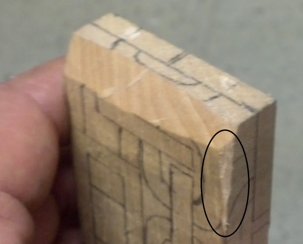

Actually, it isn't chipped at all, it just bent.
Edit to add: I was not chopping. I was not prying. I did not twist the blade in a cut. Making a couple of cuts across the grain on knot free soft wood stretched the steel of the edge, leaving behind the ripples you see in the pictures. I had the same thing happen on a custom jackknife when I hit a very hard knot whittling hard pine. If you've ever tried using a straight razor for something other than shaving, you know what it is like to use this factory edge. I have in fact made similar cuts with a single edge razor blade without damaging it. I shudder to think what would have happened if I had tried shaving a strip off my knotty ash branch I usually use for testing new knives.

Here's a couple pics
This is what I cut
This is what happened
Just to test I cut the same wood with my Enzo Birk and no problem.

Crappy cell phone pic, but this is the amount of carving that turned mine into an accordian.
The block is 2" wide by 1" thick. The circled area was done with my thumbnail just to see if the wood was really as soft as I thought.
Maybe they overheated the blades grinding them this thin, or maybe these were supposed to be sushi knives.
Honestly this is kinda pathetic, I wonder if any steel would stand to anything more than spreading butter with that grind. I get that its a light duty knife but how light can duty get? I'm struggling to understand the purpose of such a fragile tool, and such an expensive fragile tool at that.
If its at average hardness like it looks to be then it will never handle the grind given to it, S30V is just not that good and does not possess that level of edge stability. Run it harder or pick a different steel seems like the obvious options.
quoted myself from the other thread just to echo knifenut's comment. i'm pretty sure that a better suited steel could solve the problem. still have to take my caliper to it...
i'll take a look at my takeda if i have time today, with a ruler and a caliper. i said i had no knives that acute but i think that my gyuto is in line with what i read. it's sharpened flat on the grind, the grind is quite highand the thickness on top of the bevels is way less than on the nilakka. this knife is very delicate but still handles chopping food on a cutting board all day long.
so maybe the problem is more the steel than the geometry. the takeda is aogami super (super blue)at 63hrc.
