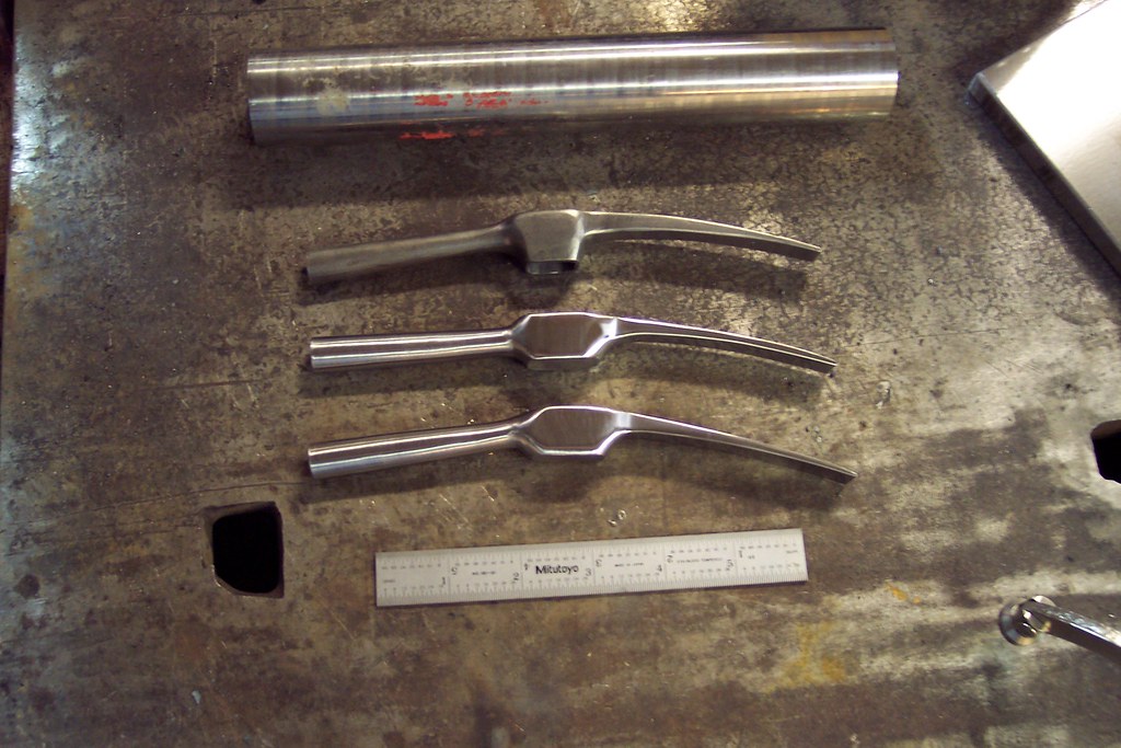

Rivet hammers? I would love to see them if you can snap a photo Mike.
It is good to do different things, I call blade work and free hand forging "sanity work" :)
In the hammer photos the top is a piece of 4140 that the hammers were forged from. The top hammer is the original the bottom two are mine. The finish is done with a deburring wheel, I love those things.

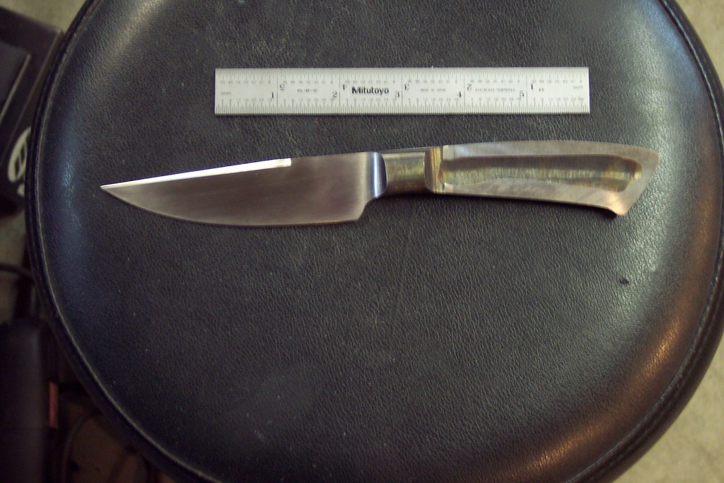

The bottom photo is a 52100 integral hunter I'm working on for a collector. It was laying on the table so I thought I'd snap a shot of it as well.
AWESOME!
Interesting design, what is the peen end for? I love deburring wheels too, been getting into the silicon bonded abrasives also, you apply moist to a cotton wheel, let dry, then use. Rough it all out with a 60 grit then run it on the 80 grit and it looks more like 400. Bit messier but MUCH cheaper than the deburring and scotchbrite wheels. NICE integral too.
Nice little hammer Sam and Mike great looking Rivet hammers and that integral is look sweet.
