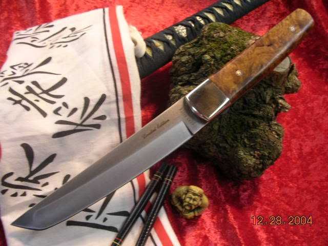

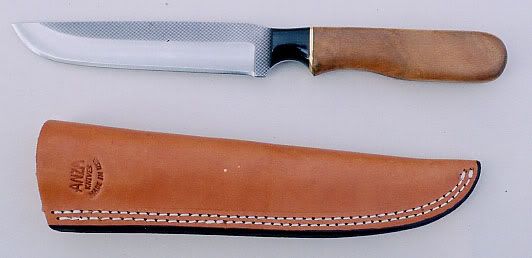

Here are a couple that I especially like:
A custom Anza in Coa:
A Bark River Tanto in Ambroynia Burl:
I also like anything spalted, almost anything in burl, cocobolo, desert ironwood, etc. etc.
The only material so far that's caused me to gasp in horror, dark buckeye.
-Bob
