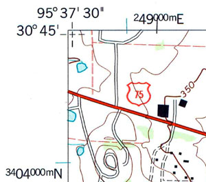

How do you transfer the UTM to your paper maps
Manually?
Modern USGS topo maps have the UTM and Long-Lat coordinates on the map edges.
Use a straight edge to plot yourself accurately on the physical map, or in the field just trace along with your fingers for a rough estimate.
There are also clear plastic mapping template aids available at survey and outdoor stores - some handheld compasses even have the map templates printed on the compass base.
