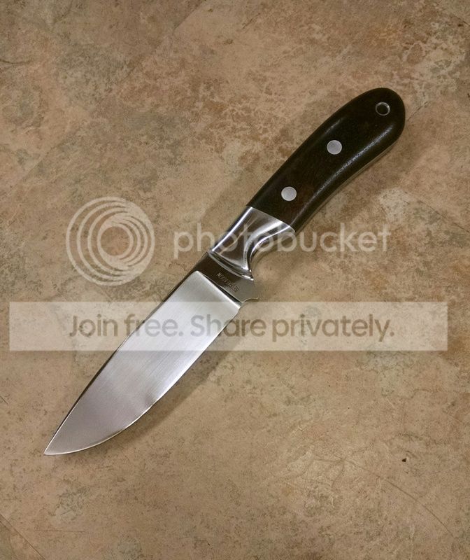

A friend of mines son graduated high school yesterday, this was his graduation gift.
Apologies for the photo quality, I need to set up a light box of some sort.
I would appreciate some feedback on overall design, proportion and whatnot, but specifically:
The rear angle of the bolsters?
The sharpening notch/choil relation to the plunge line?
Forward pin placement?

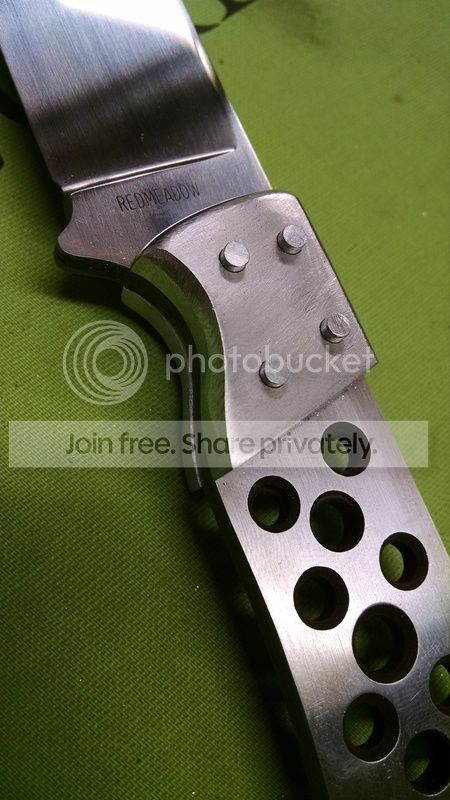

Method of bolster attachment? Being aluminum and not soldered, the 4 pin holes are tapered slightly and pins peened with a thin layer of epoxy underneath. Suggestions for a better method?
My feelings are indestructible, so fire away please.
OAL- 8 7/8"
Actual edge- 3 7/8
Steel- O1
Scales -Walnut (Not stabilized, Vinegaroon, Danish oil)
Pins/Bolster - Aluminum
I like everything I'm seeing here. Everything you asked about looks spot-on to me. Great looking knife.

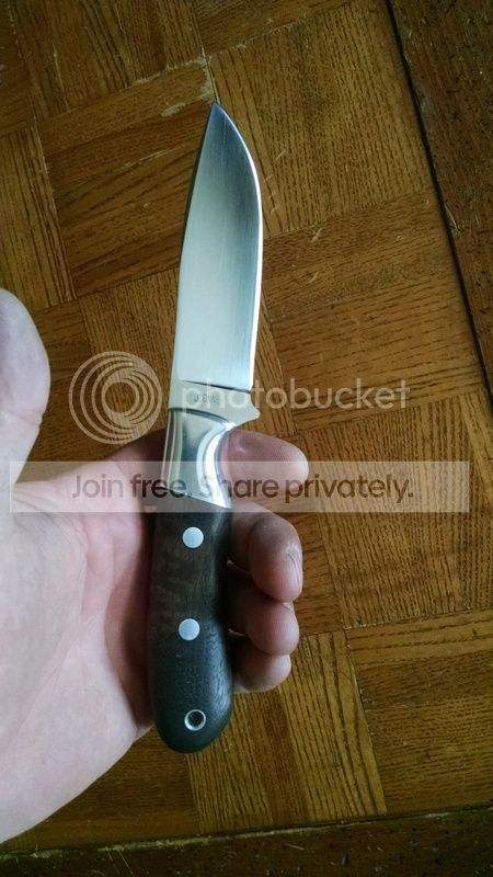

I'm humbled by the compliments, thank you. I've been struggling with proportion and pin placement, and have been trying to learn the small details than can make or break a knife when it comes to balancing pleasing the eye, function and strength.

I think everything you had concerns about looks fine to me. Just my personal preference here so please take it as such, the finger choil looks like it was ground just a hair to deep into the bolster, but this could just be the photos and reflections. Doesn't take anything away form the knife though and no doubt your friends son will be stoked to have it :thumbup: Handmade is infinitely better than anything off the shelf in my book!

Thanks Augus7us, I'm working on a similar knife and that's one of the things I changed very slightly, a bit more shallow. This one fits the hand extremely well, but you're right, with any glare, it looks like it rolls in a bit much. That fine balance between fit and pleasing to the eye is what I'm really focusing on lately.

P.S. since you asked, I would have changed the placement of the pins, but everything else looks outstanding to me.. and that's not shot at yours, just would have put em in a different place if it were me, but what the hell do I know? i'll post mine when it's done for the same critiquing.

Thanks rustyrazor, if you don't mind, what would you change about the pin placement? I don't consider your P.S. a shot at all, I'd like to know what you think. I struggle with distance from the bolster and the butt, especially when using 1/4". I'm thinking about switching to a 3/16" in the front with a couple of rows of 1/8" or 1/16" towards the butt. I think that looks great when done right.
Nicely done. If I would make any changes they would be the already mentioned finger choil and leave out the center pin. Hope it sees lots of use. Jess

as i said, personal preference... i think the pin should have been moved back further from the bolster... not sure why. Maybe for me at least i think it would make the symmetry a bit better from bolster, pin, pin, hole? I'm assuiming the holes are evenly spaced, but it looks like the first one is just too close to the bolsers. like i said, what do i know, just my opinion, and you know what they say about opinions? lol
