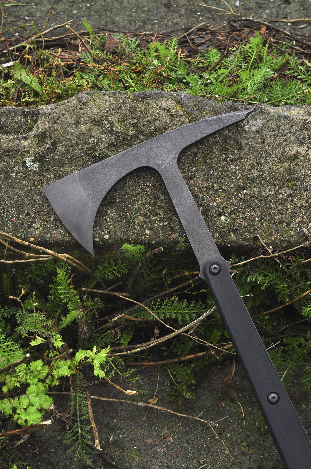

Specs.
Lenght - 15 inches.
Thickness - 5/16 inch
head length - 9 inches
Blade length - 3 1/2 inch
Weight - 21 oz.
Technology.
Steel
My basic hawk, slightly improved - with handle slabs.
14 1/2 inch long
8 inch long head
2 1/2 edge
~20 oz.
Single piece 40hnma steel.
40 HNMA is a aerospace grade steel, equivalent to 4340 according to AMS-6359 standard.
When comparing with 4340, 40hnma has lower amount of
sulphur - 0,030%
phosphorus - 0,030%
it gives the steel much better impact resistance.
But why we use 4340?
According to "Manufacturing technology for aerospace structural materials"
"The 4340 is the benchmark by which other high strength steels are judged. It combines deep hardenability with high strength, ductility, and toughness.
It combines deep hardenability, high strength, ductility, toughness. It also has good fatigue and creep resistance"
It can be harder, tougher and much more fatigue crack resistant than 4140.
Heat treatment
We used uniform multistep heat treatment.
Normalising
two grain refinement cycles,
quenching cycle
tempering cycle
Hawks are about 52-53 hrc.
Handle slabs CNC'd out of black paper micarta. Matte finish
Price - 135$, US shipping included
5 available

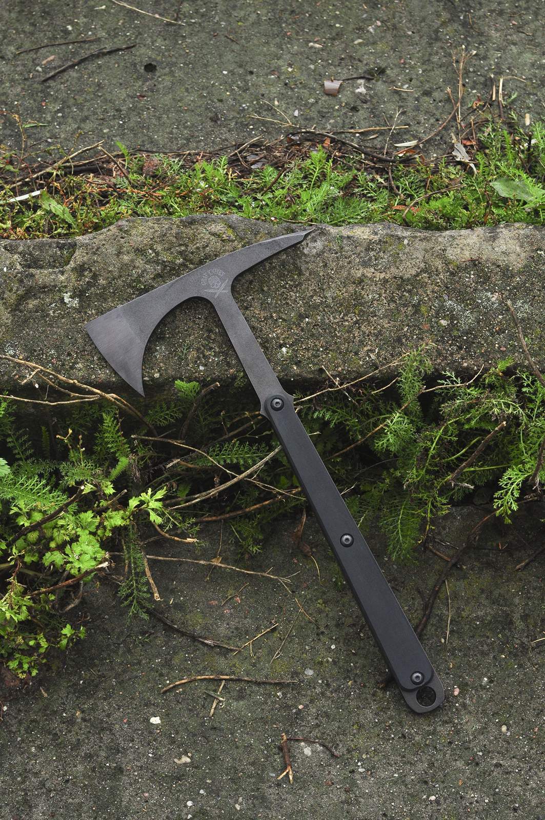

Lenght - 15 inches.
Weight - 21 oz.
Technology.
Steel
14 1/2 inch long
8 inch long head
2 1/2 edge
~20 oz.
sulphur - 0,030%
phosphorus - 0,030%
Heat treatment
Normalising
quenching cycle
tempering cycle
5 available
