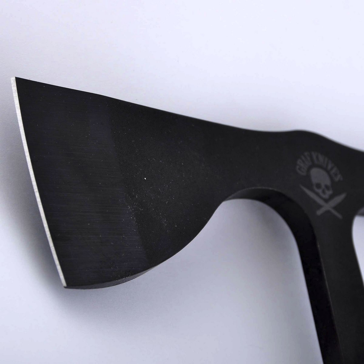

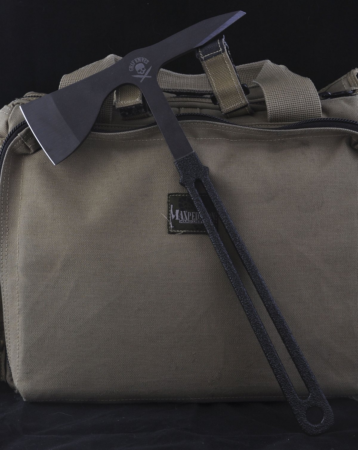

This tomahawk is a modern single piece interpretation inspired by classic design of Peter LaGana.
Specs.
Lenght - 15 inches.
Thickness - 5/16 inch
head length - 9 inches
Blade length - 3 1/2 inch
Weight - 21 oz.
Technology.
Steel
Single piece 40hnma steel.
40 HNMA is a aerospace grade steel, equivalent to 4340 according to AMS-6359 standard.
When comparing with 4340, 40hnma has lower amount of
sulphur - 0,030%
phosphorus - 0,030%
it gives the steel much better impact resistance.

Hawks are about 52-53 hrc.

Industrial black oxide.
In other hawks we use zinc coating, but it is too shiny.
That is why in this hawk I've decided to use black oxide, for a uniform black look.

Line-X - Industrial polyurethane coating.
This is high friction, pure polymer coating.
It gives thermal, electric and shock isolation.
