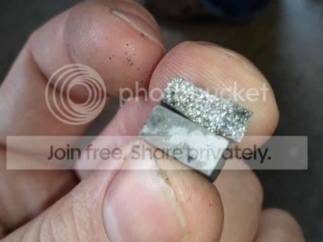

Grain is observed in two main ways.
1) By Examination - Break the knife in half and use a magnifier or microscope to examine the grain size. (It should not show on the surface unless there is something terribly wrong.) The break will look like a knocked down brick wall if the grains are very large. It will look "gravelly" if they are large. It will look "sandy" if the grain is fine.And it will look "matte" if the grain is very fine.
2) By Observation - Sharpen the knife and see how it cuts, if despite all sharpening attempts the edge remains toothy, or chips out easily, it probably has large grain size. If , on the other hand, it sharpens well and takes a hair popping, paper slicing edge, the grains are most likely small and well arranged.
Here are a 1000 words.
Fine vs. Coarse grain...
Rick , thanks for posting those .The coarse grained one is going to be brittle which is the biggest problem with large grain.
Overheating ? A little just gives you large grain and is correctable. More gives you grain boundary problems as elements , good and bad , will diffuse into the grain boundaries and sometimes can be correctable. Even higher overheating starts to oxidize the grain boundaries => scrap !!
