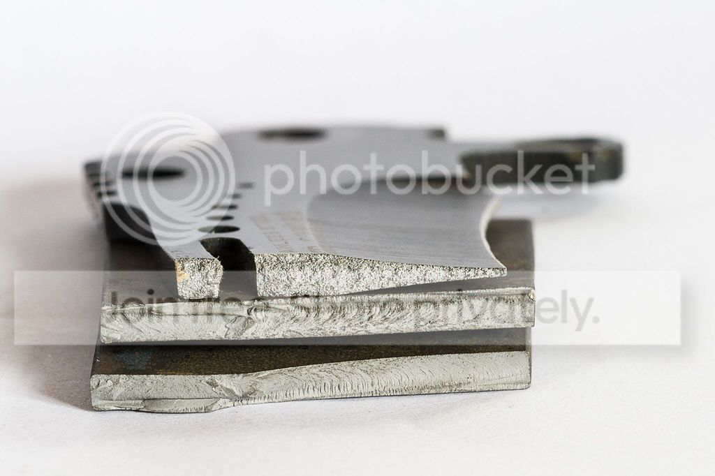

my first attempt at hardening stainless. It's AEB-L i didn't use foil and i didn't temper it.I wasn't sure it got to full hardness after the plate quench (also my first try with aluminium plates )the sample broke with 2 light taps with a hammer. does it look good to you guys?

It's kinda hard to tell from the pictures, but the knife in the bottom picture has huge grain. This is a good exzample what a minor tweak to heat treat will do to grain size. Same material but slightly different heat treat.
A good reference for grain size is a file. Break one and look at it. It should look like the bottom picture of JT's pic. What was your recipe?

wait you didnt foil wrap a blade at 1900f + soak time you likely burned out a pile of carbon so its not likely that you even came close to hardening the balde

Just finished the new oven build and have been testing it out. Let oven slowly heat up to 1950c then put in the sample for a 15 min. Soak quenched in aluminum plate while blowing air between the plates and checked with hardness testing files. I'm trying to find foil here in Austria that isn't going to break the bank .

First off I would get some stainless foil. I would send you some but I see you live in Austria! Next, get your oven up to 1560 and then put the blades in for 10 mins or so to equalize. Then ramp to 1940 and soak for 15 mins. Plate quench still in the foil. I put the plates between my drill press to get good pressure. Then ramp the oven to 1975 and soak for 5 mins and plate quench again while in the foil. Then when cool to touch remove the foil and put in dry ice/denatured alcohol mix. Then temper. Try another coupon and see how it looks.

How I look at this probably different than others, so fwiw.
After 15m at 1066C/1950F and quenched (to room temp), RA is probably more than 25%. First hammer tap likely converted some ra to mart, then fractured/severed on 2nd tap. Grain size looks good based on highly irregular & small details of broken surface. As grain size increase, also increase tendency of fracture path to follow grain boundaries. Bright surface and bumpy like beach-sand (as Jim posted) is example of fracture follow cluster of grains, since many facets are facing you, so more light reflection, therefore brighter look.
Look to me there is a burned-layer (decarb & possibly scale) about 0.25mm thick. Compensating on the safe side, grind 0.3mm off all surface of blade (faces & edges). *note - to check hardness via filing, grind 0.3mm off the edge creating a bevel angle about 120 degrees. This way, if not hardened correctly, you can re-ht while the blade has a thick decarb layer to minimize additional decarb. Also keep in mind, drilled holes surface will have decarb (soft layer).
When I need to rapid liquid quench aebl and others, I use a thin layer of clay and compensate for decarburized surface layer.
You can even grind decarb off just only for the cutting edge. Your blade has decarb jacket (san-mai feature :D).
