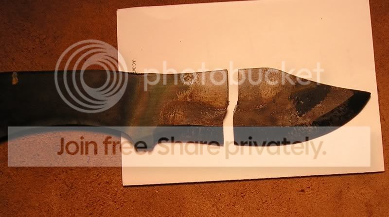

When edge quenching, how far up the blade should there be fine grain structure??

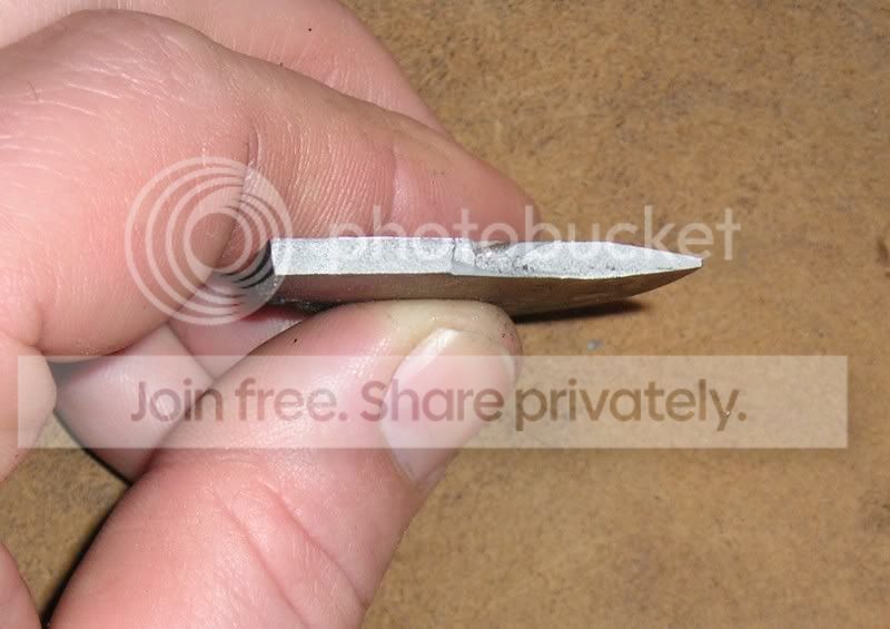

I was testing a blade to see how far it would bend before breaking, and when it broke it was finely grained only about 3/16" from the edge....

The higher up the blade you can get the quench line, the more likely you will have a fully hardened edge. 1095 has to cool FAST, keeping any part of the blade above the oil will slow down the effectiveness of the quench, and may lead to pockets of pearlite in the edge. Another thing to think about is when you are looking at a quench line, you are looking at the sides only, the unhardened portion extends further down in the center of the blade.
How wide was the blade you were quenching? If you wanted to edge quench say a 1"wide hunter with a 1/8"thick blade, aim for a visible quench line at least 2/3rds of the way up the blade (but I would quench the entire blade). If you are looking at a 2"wide chopper 1/4"thick, try to get the line halfway up the blade.

With proper normalization the grain structure should be fine through out blade. Edge quinching shoul only convert the cutting edge to martensite (hopefully tempered to remove the brittleness).

1095 has to drop from 1450F (775C)to below 950F (500C) in less than one second. If you are edge quenching it ( I never edge quench) the retained heat in the spine will keep the edge from dropping that fast. The very edge may make it, but the rest will become pearlite. You would be better off to clay coat the spine and do a full quench. The results will be the same as an edge quench, but with far more control over where the transition will happen.

If this were 5160 that snapped like this I would suggest a higher temper temp. I have learned to bump it up to 450 on my blades.
