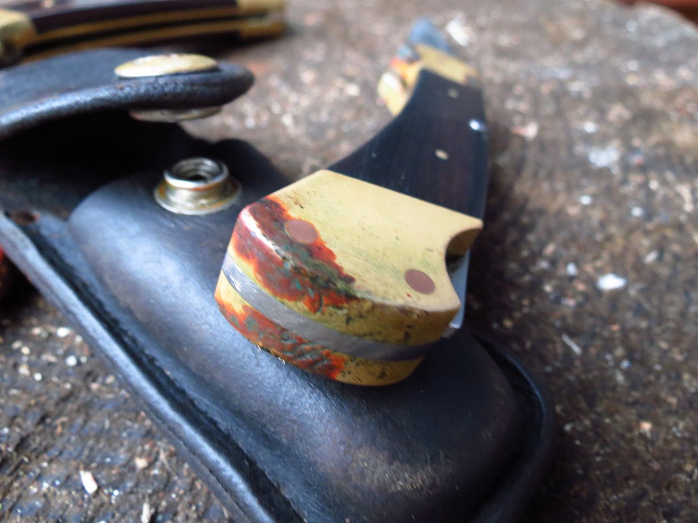

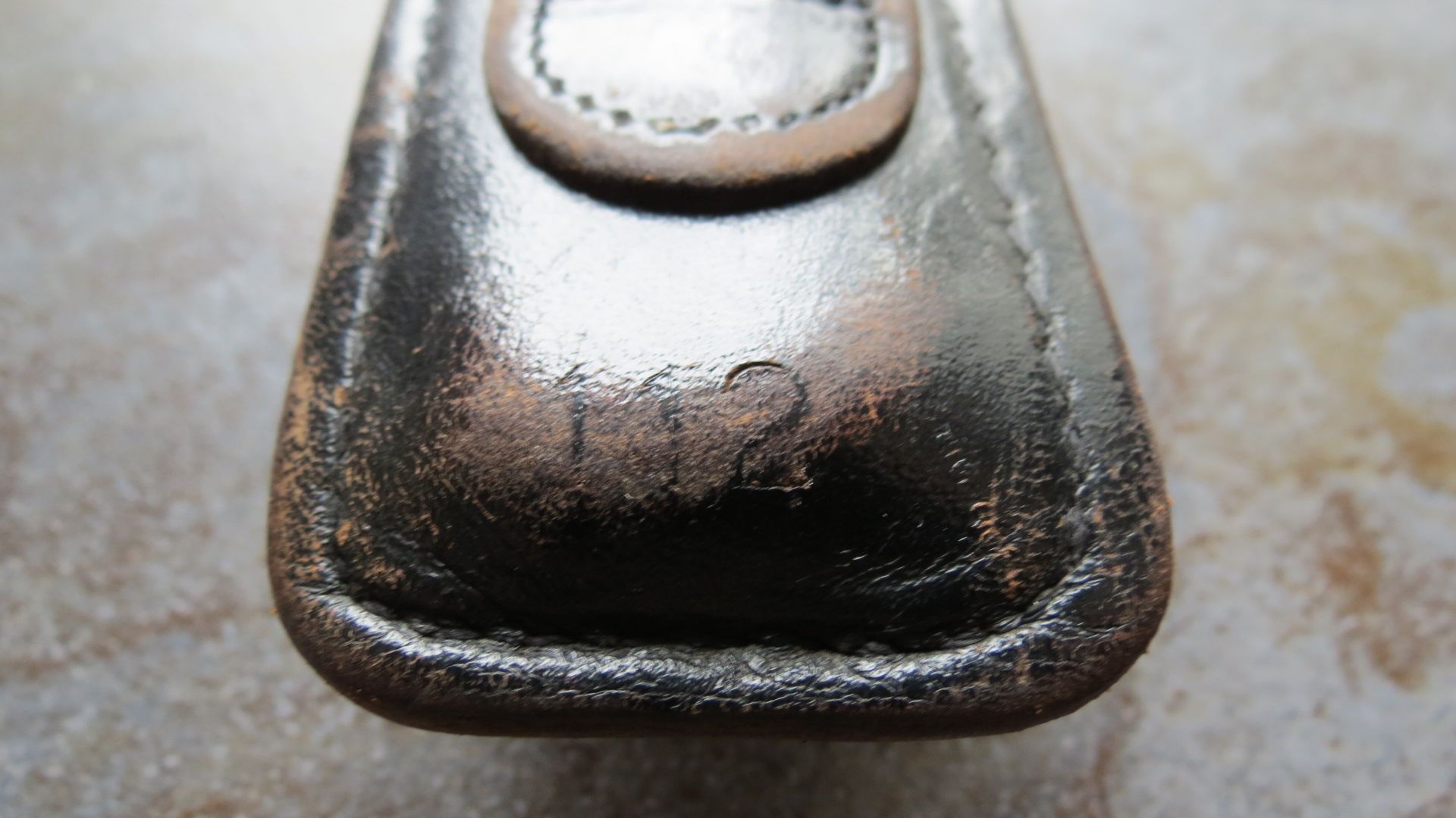

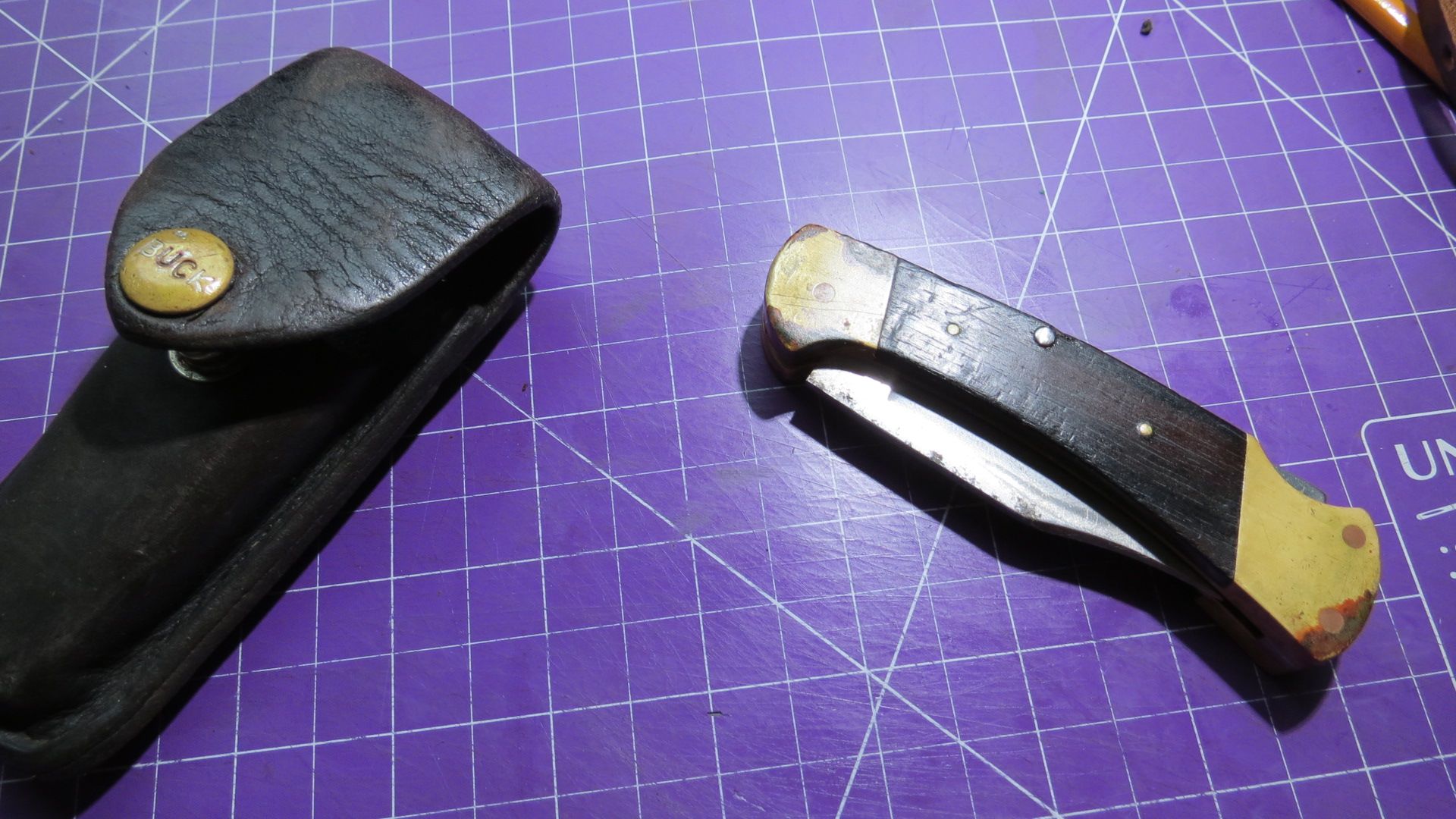

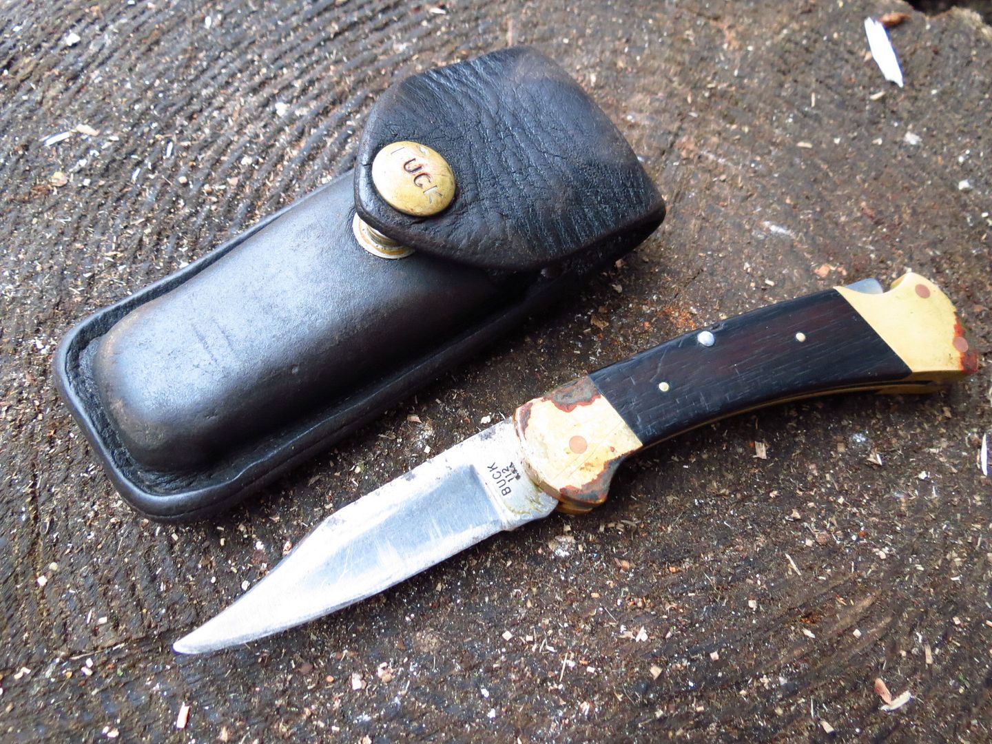

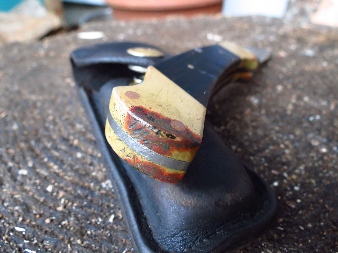

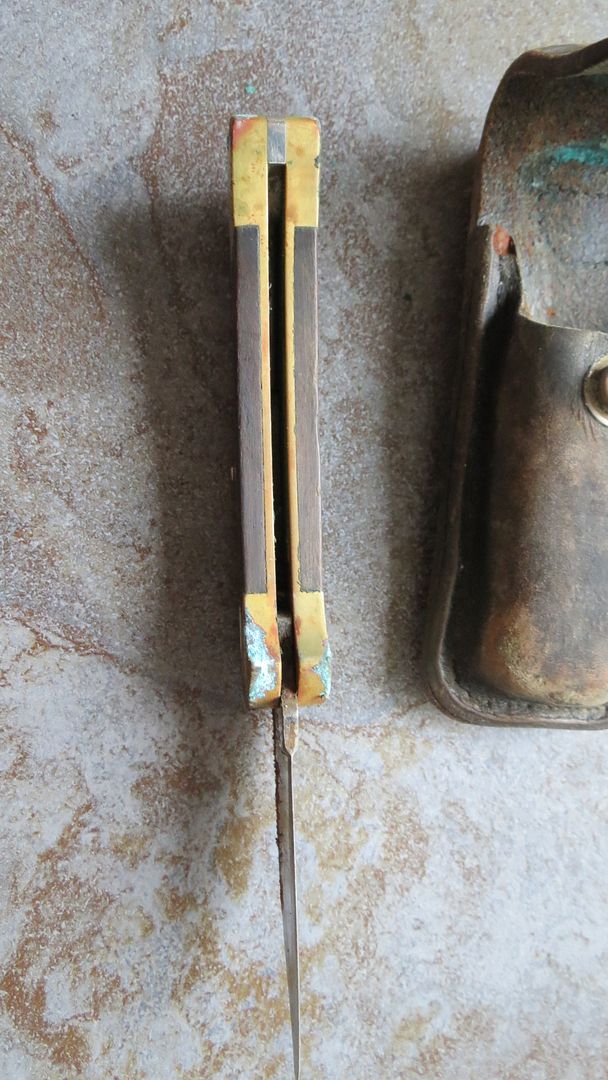

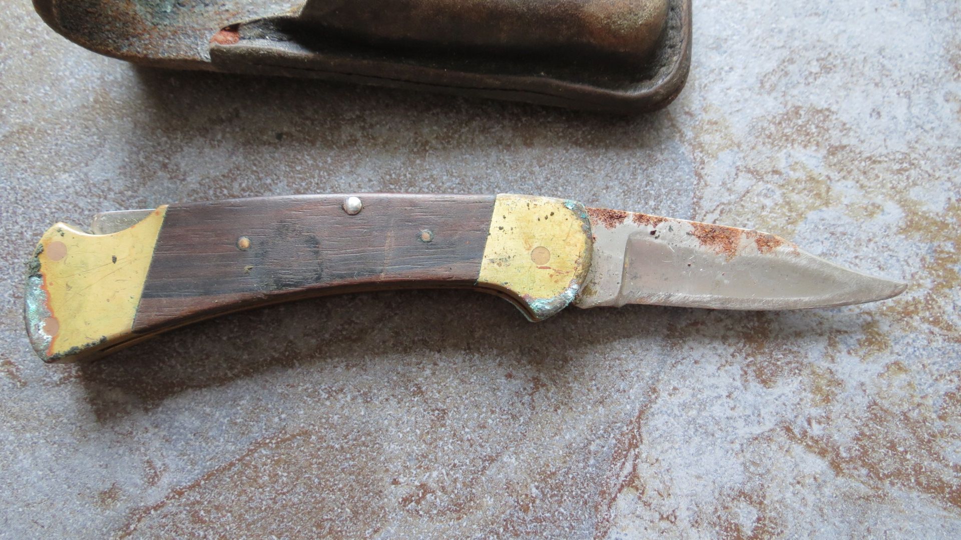

I recently came into possession of my Grandpa's Buck 112, which he wore and used constantly from the time be bought it until he couldn't use it anymore.

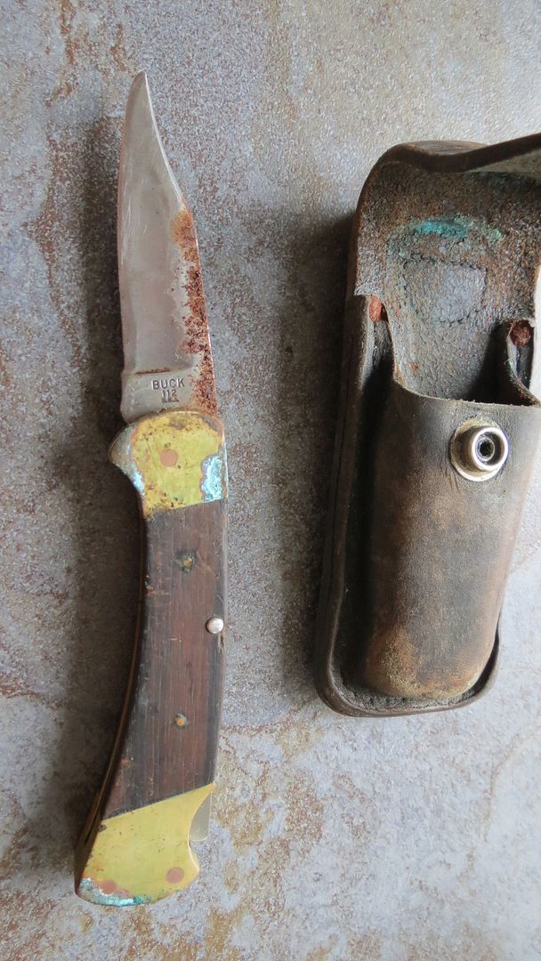

My Grandpa was a logger here in the PNW, he took care of his tools, but he used them hard. Unfortunately, this Buck 112 along with a few dozen other items (including a couple more blades) were packed away and left in a storage locker for roughly 4 years (until we moved back to the PNW).

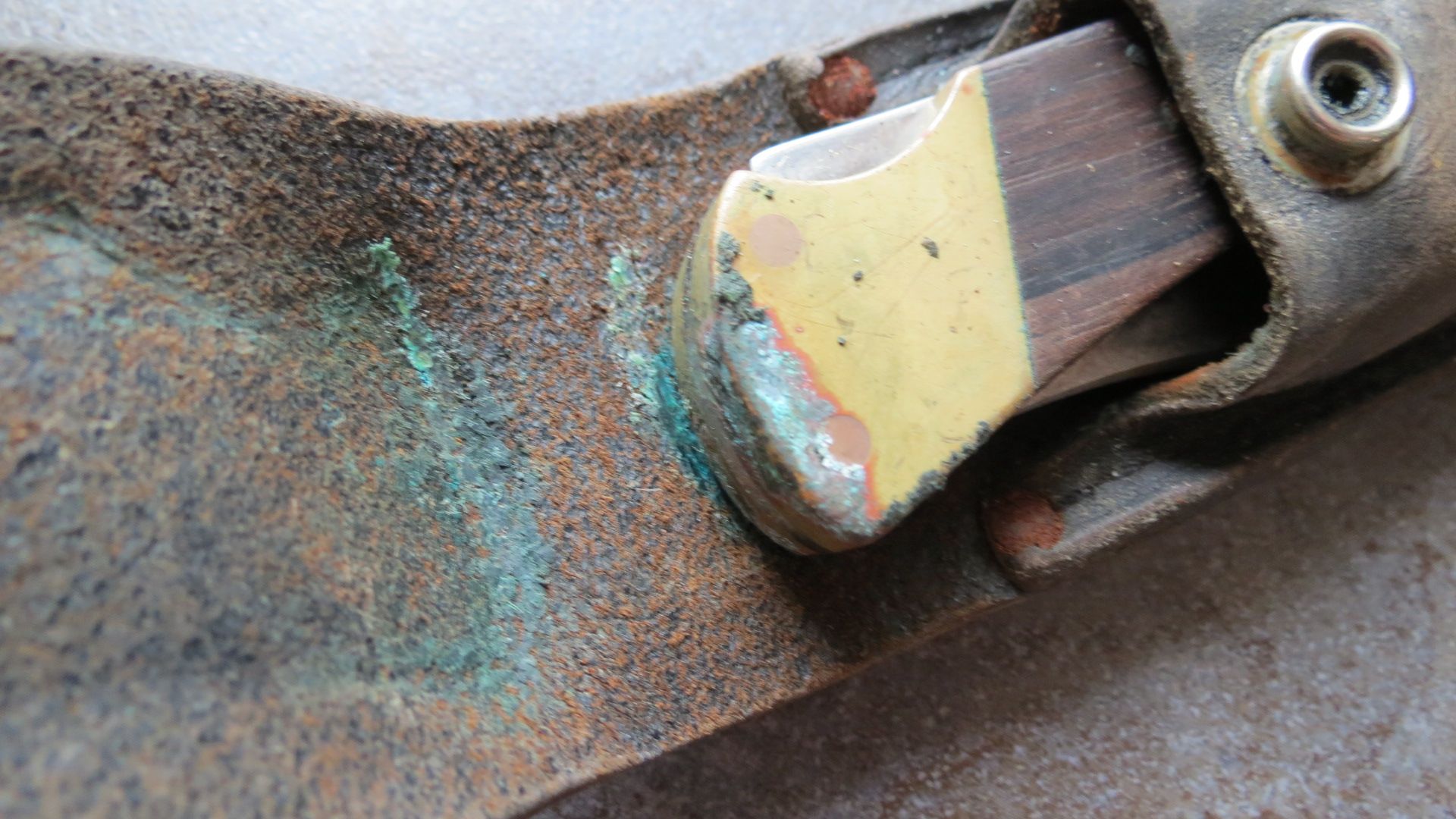

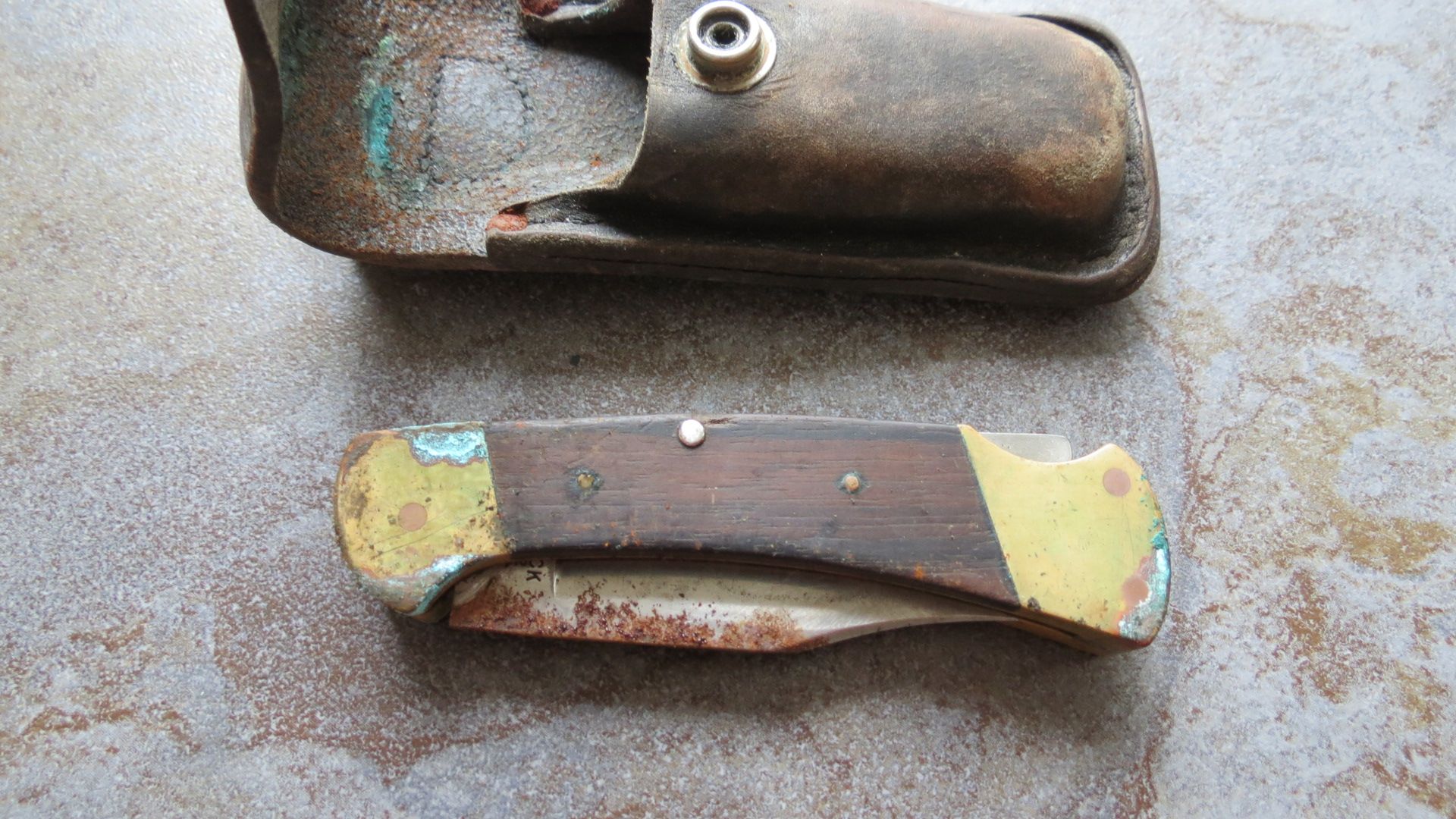

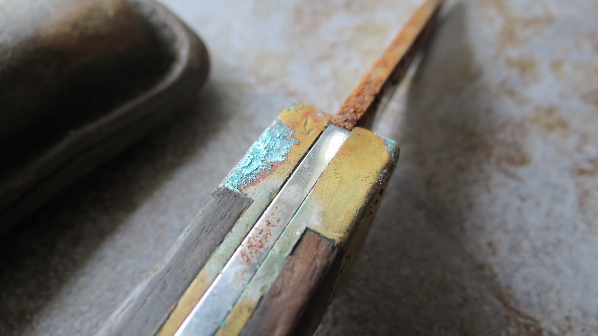

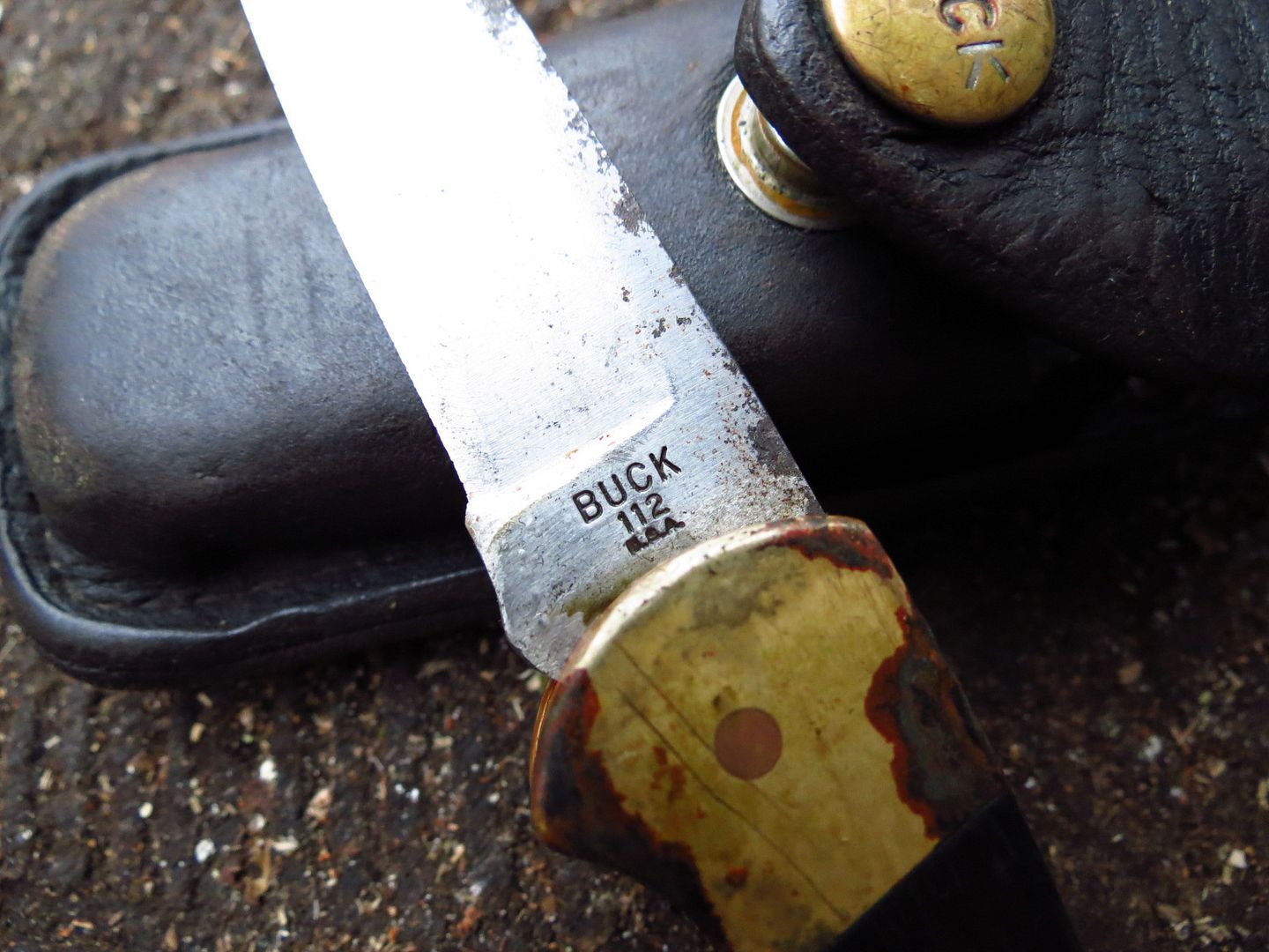

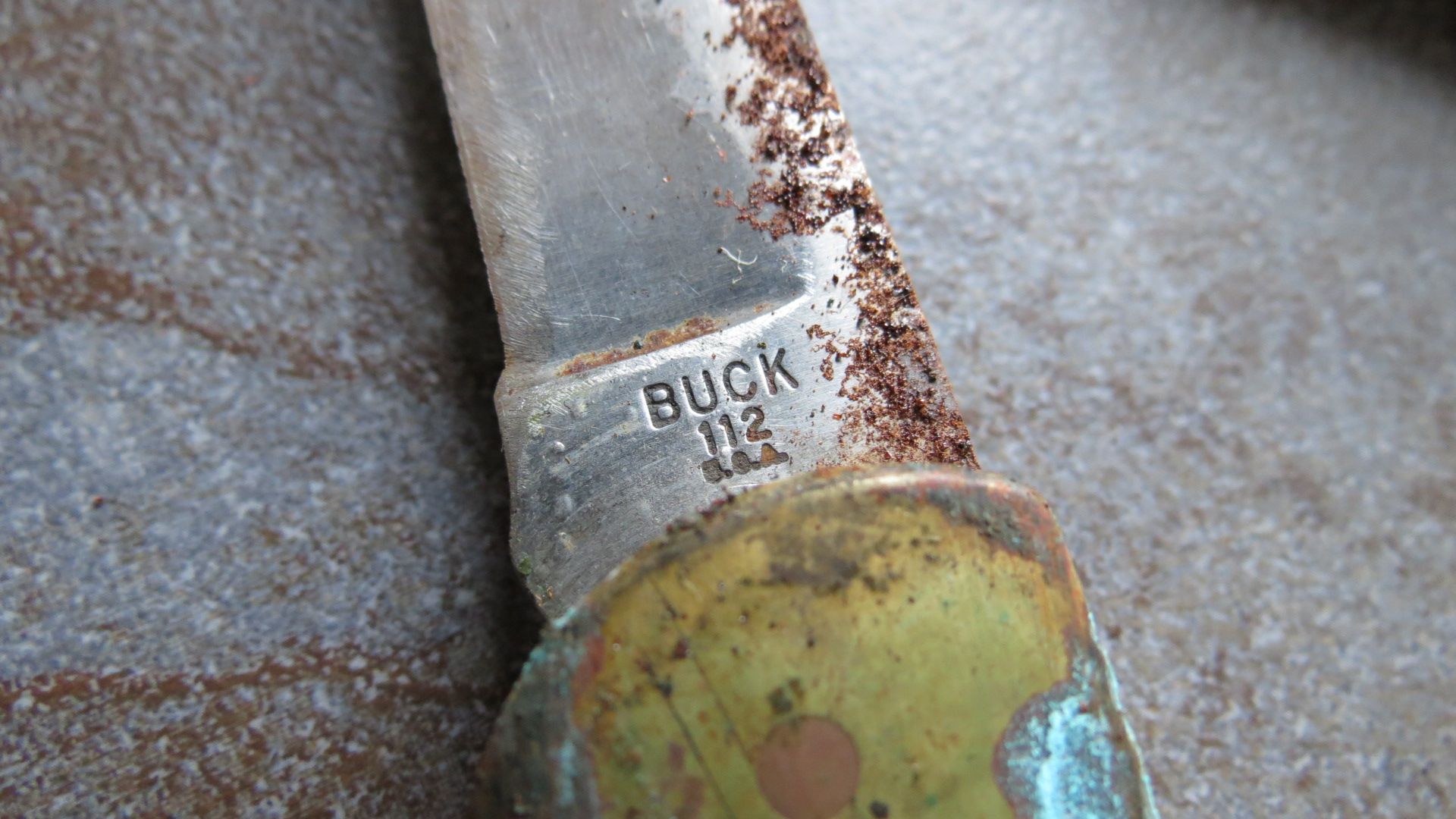

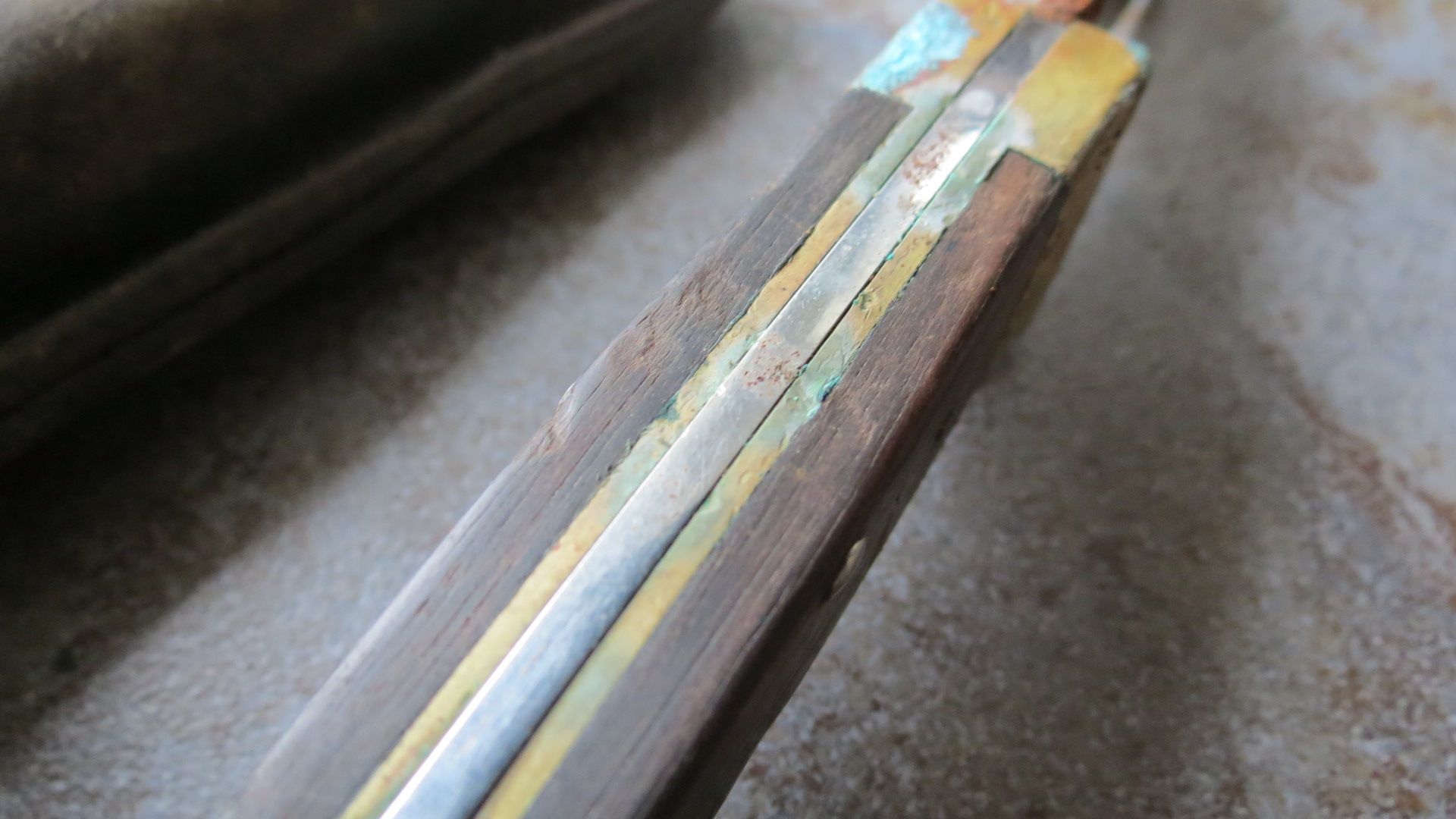

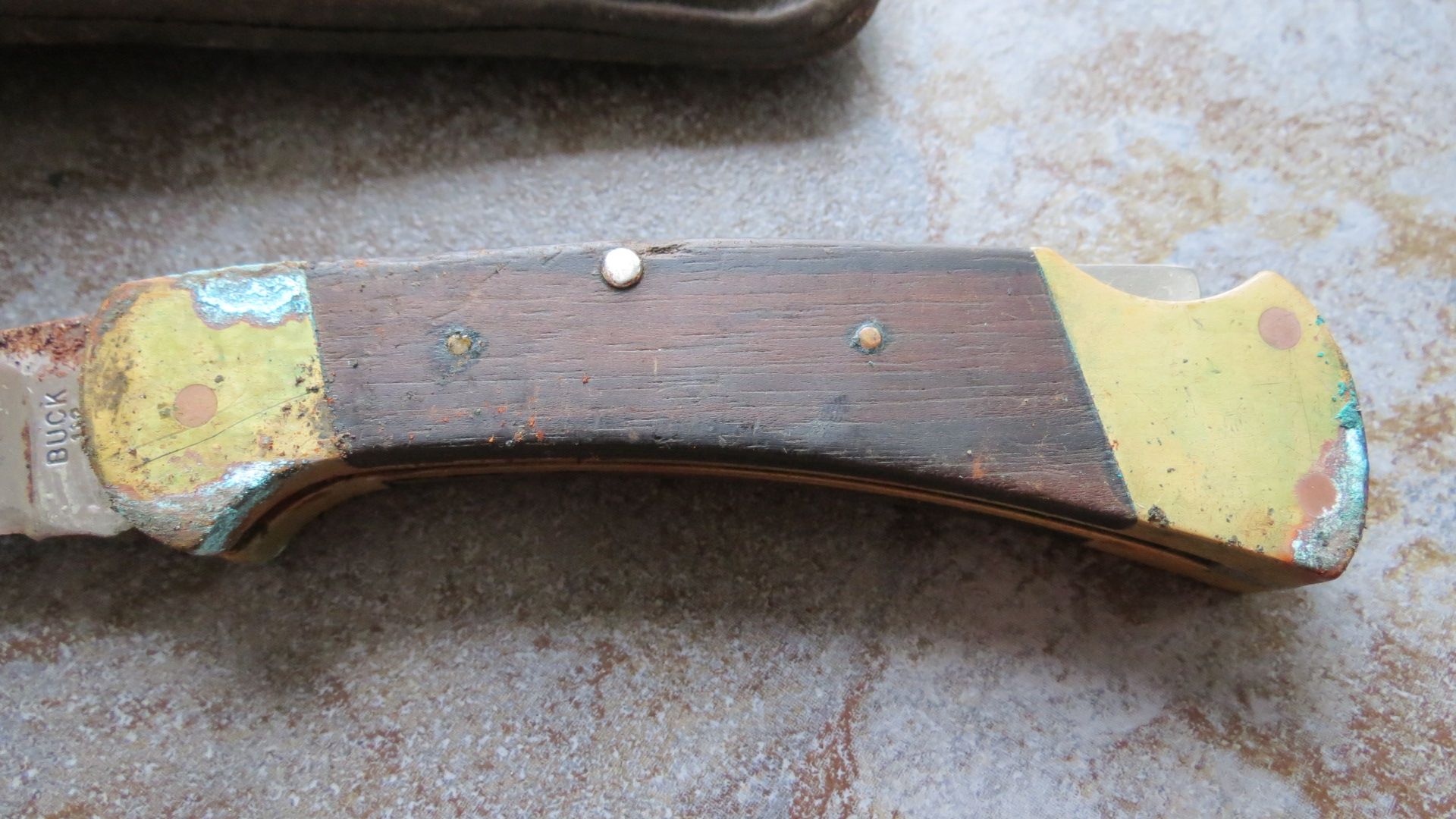

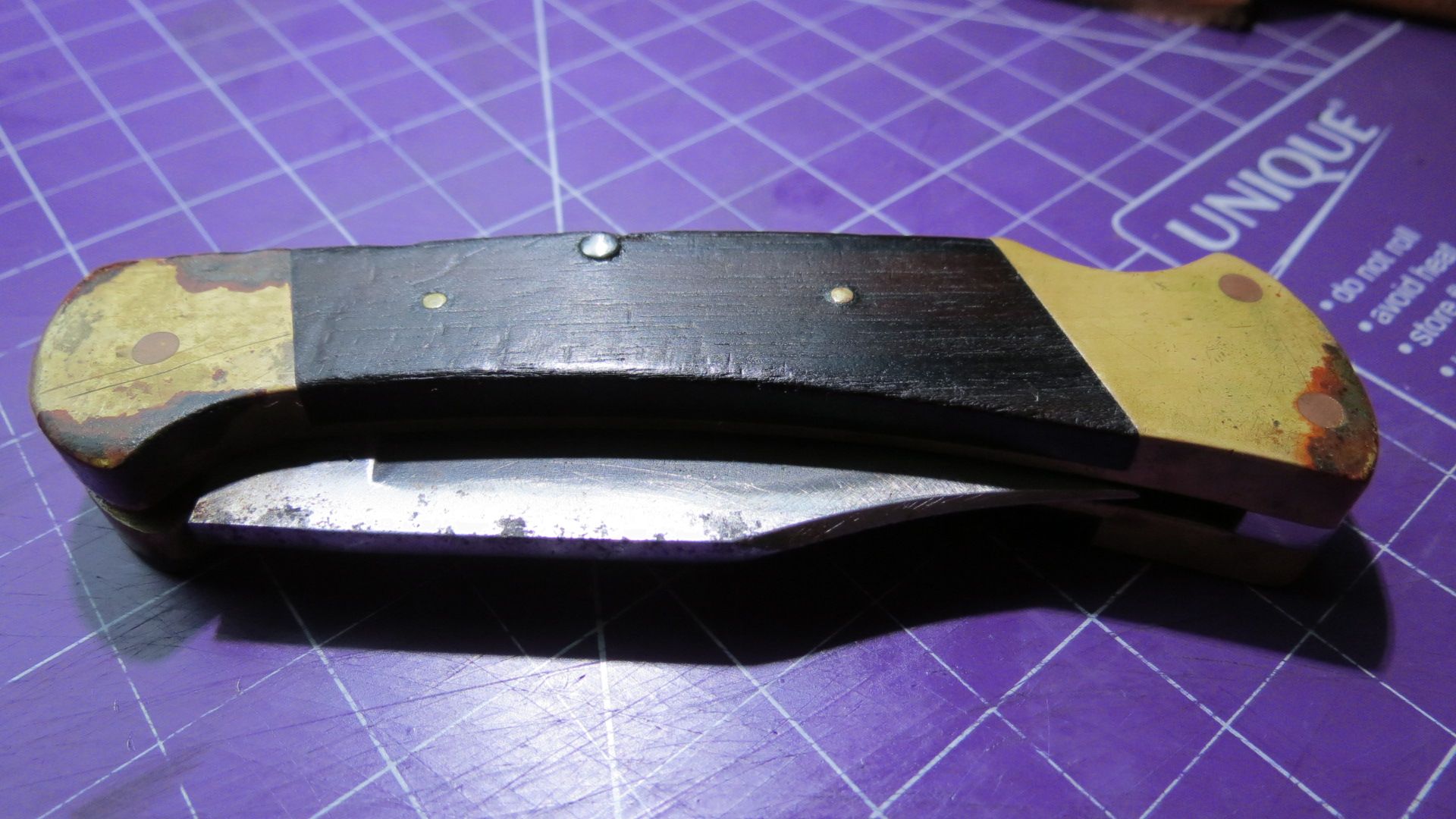

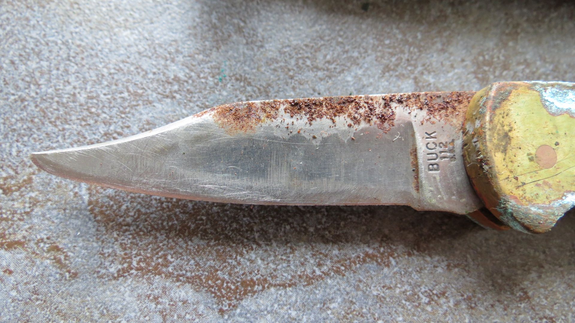

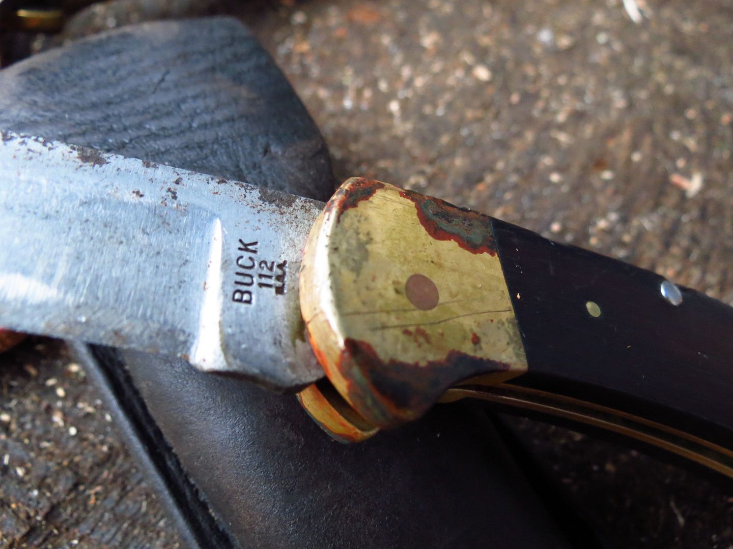

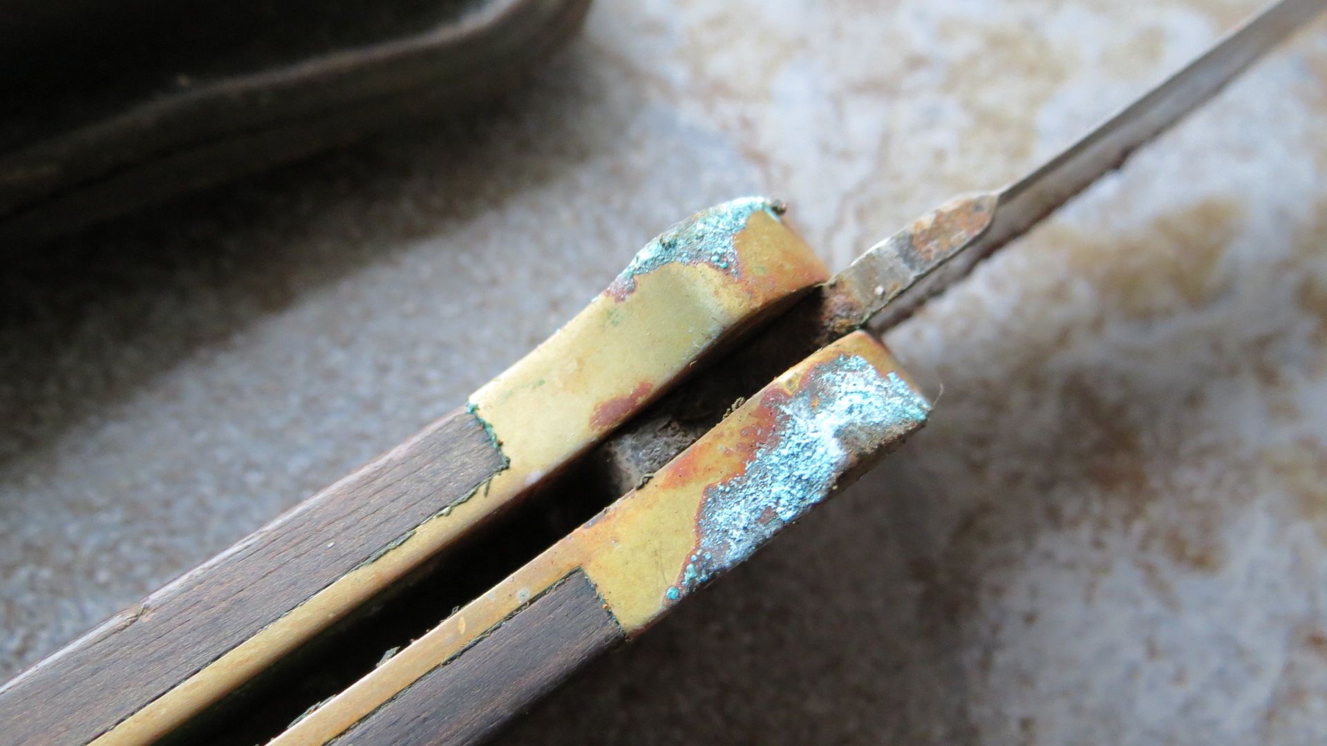

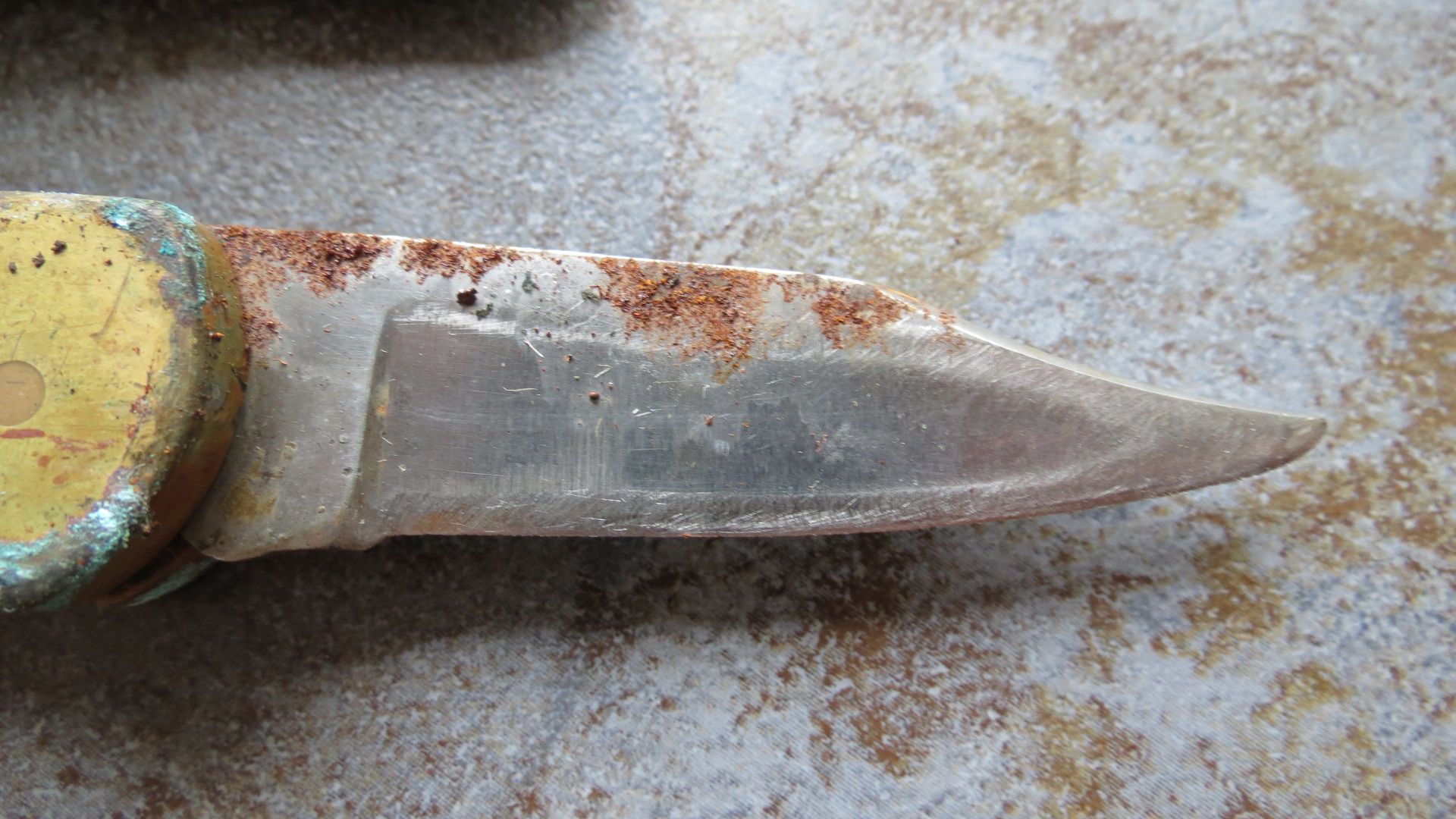

It was not oiled or cleaned before storage, and red rust had accumulated on the blade. Green oxidization on the brass, and the pivot was full of grit. When the blade was open, I would have to force it back down, the spring tension just wasn't enough to get past all the grit and grime.

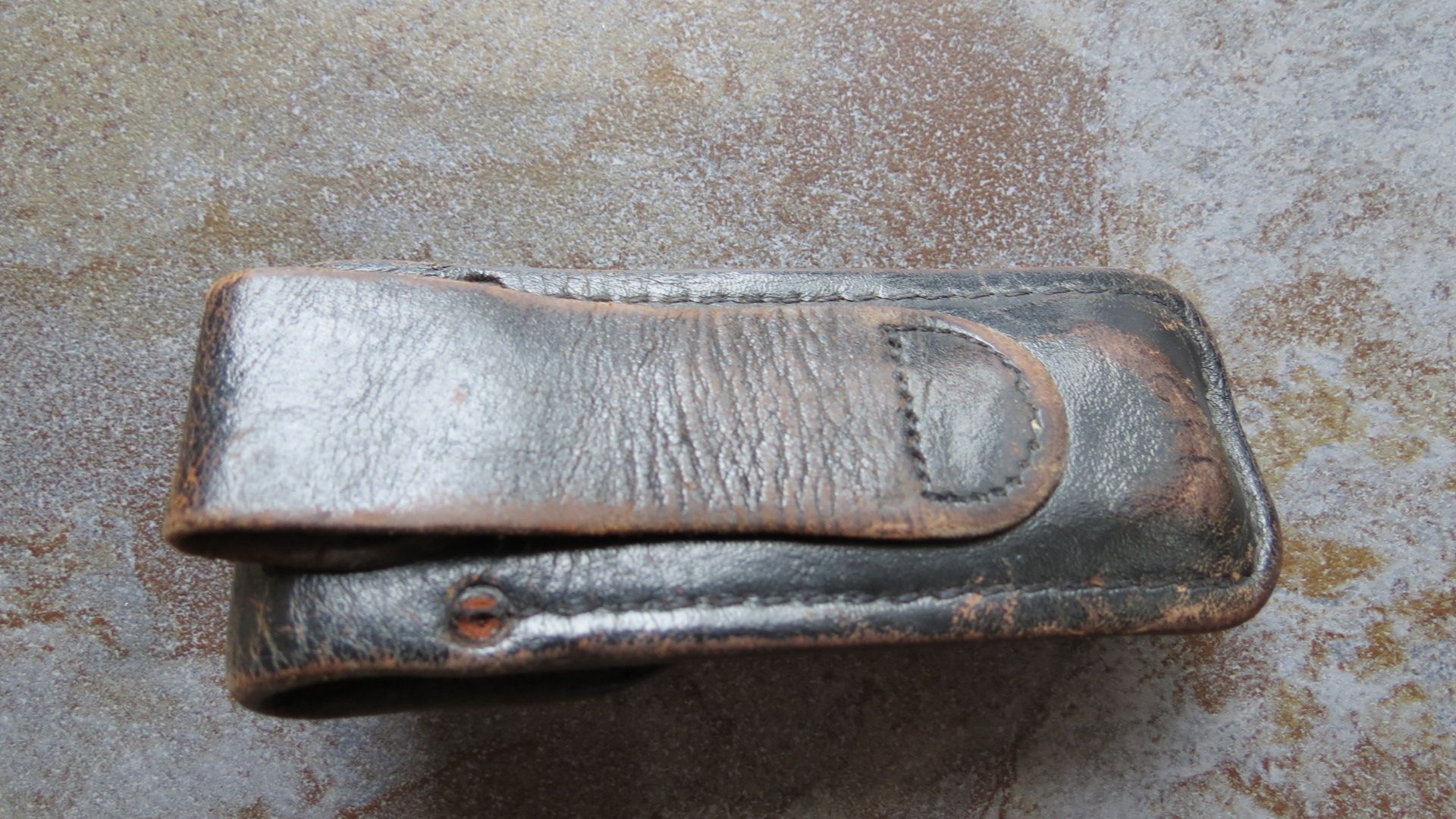

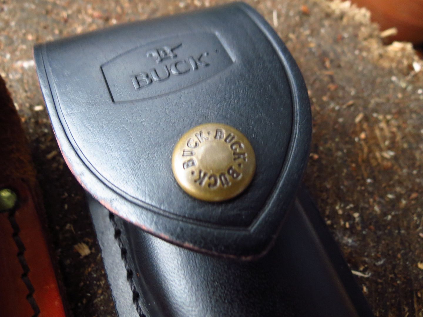

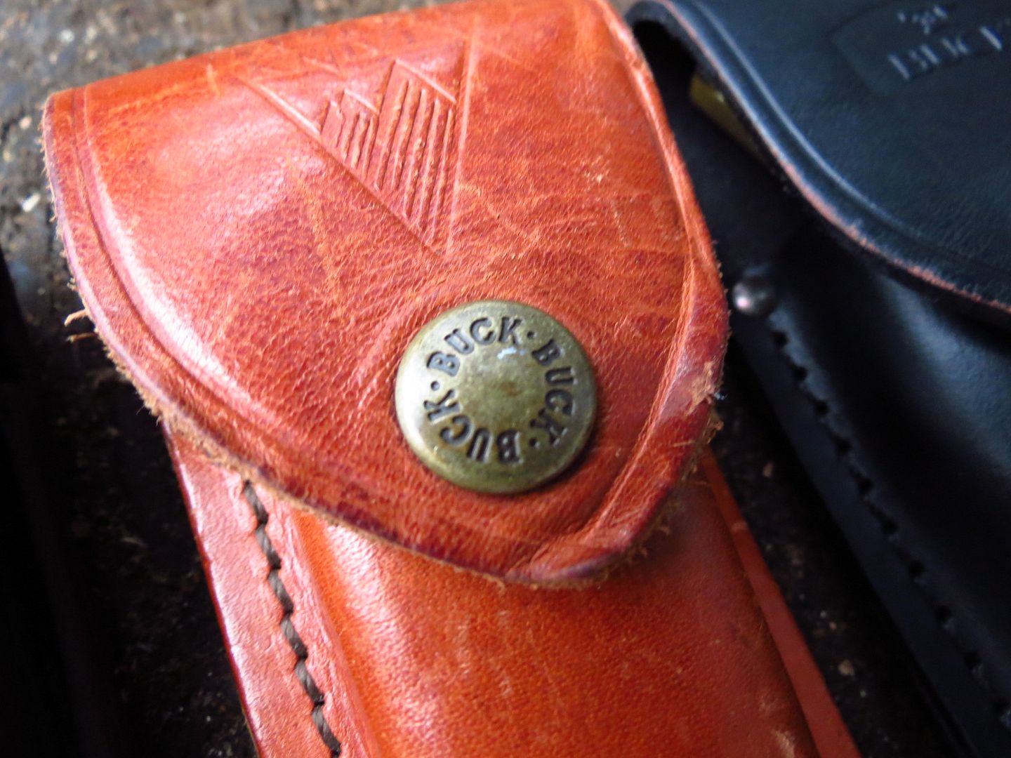

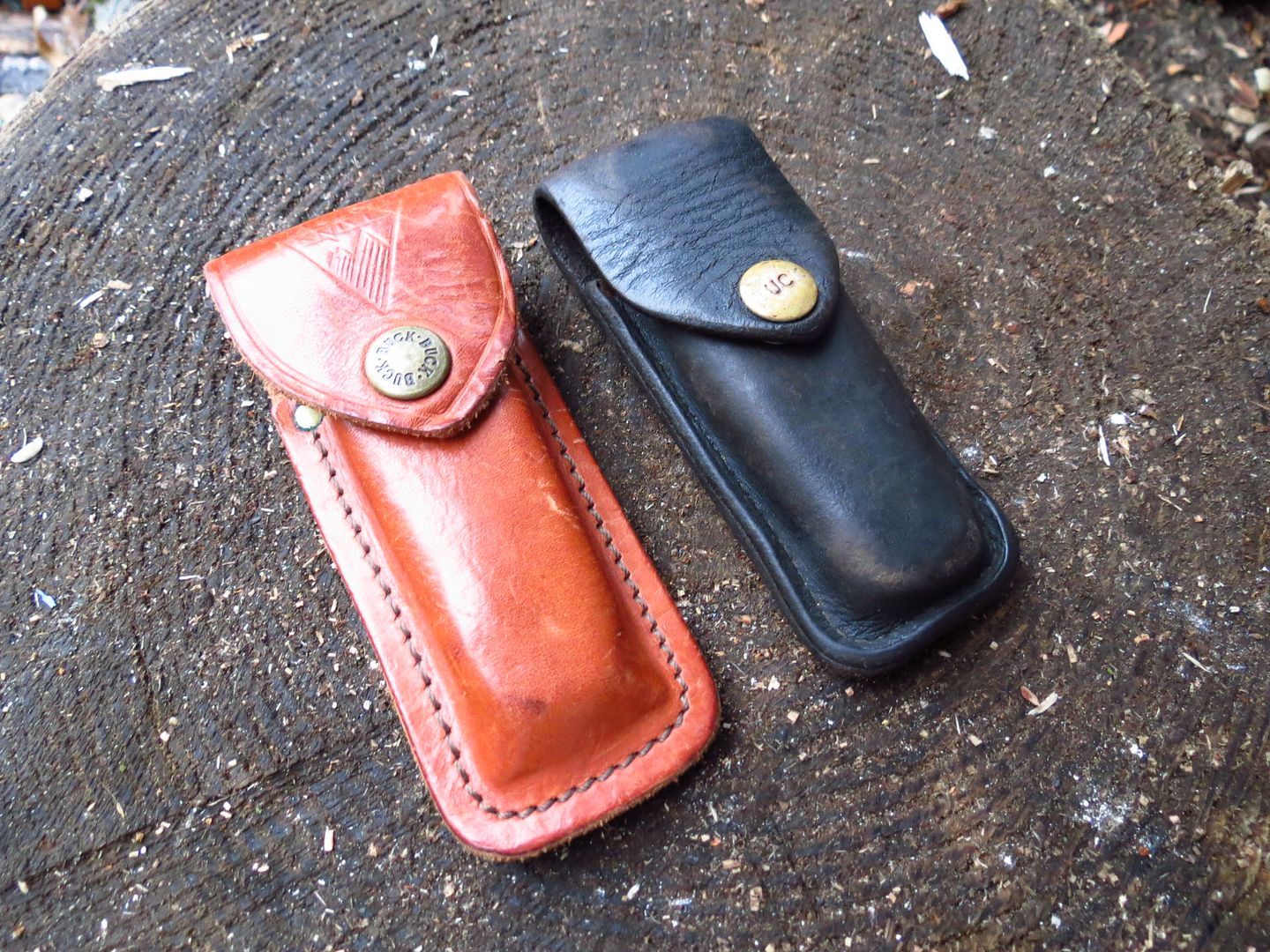

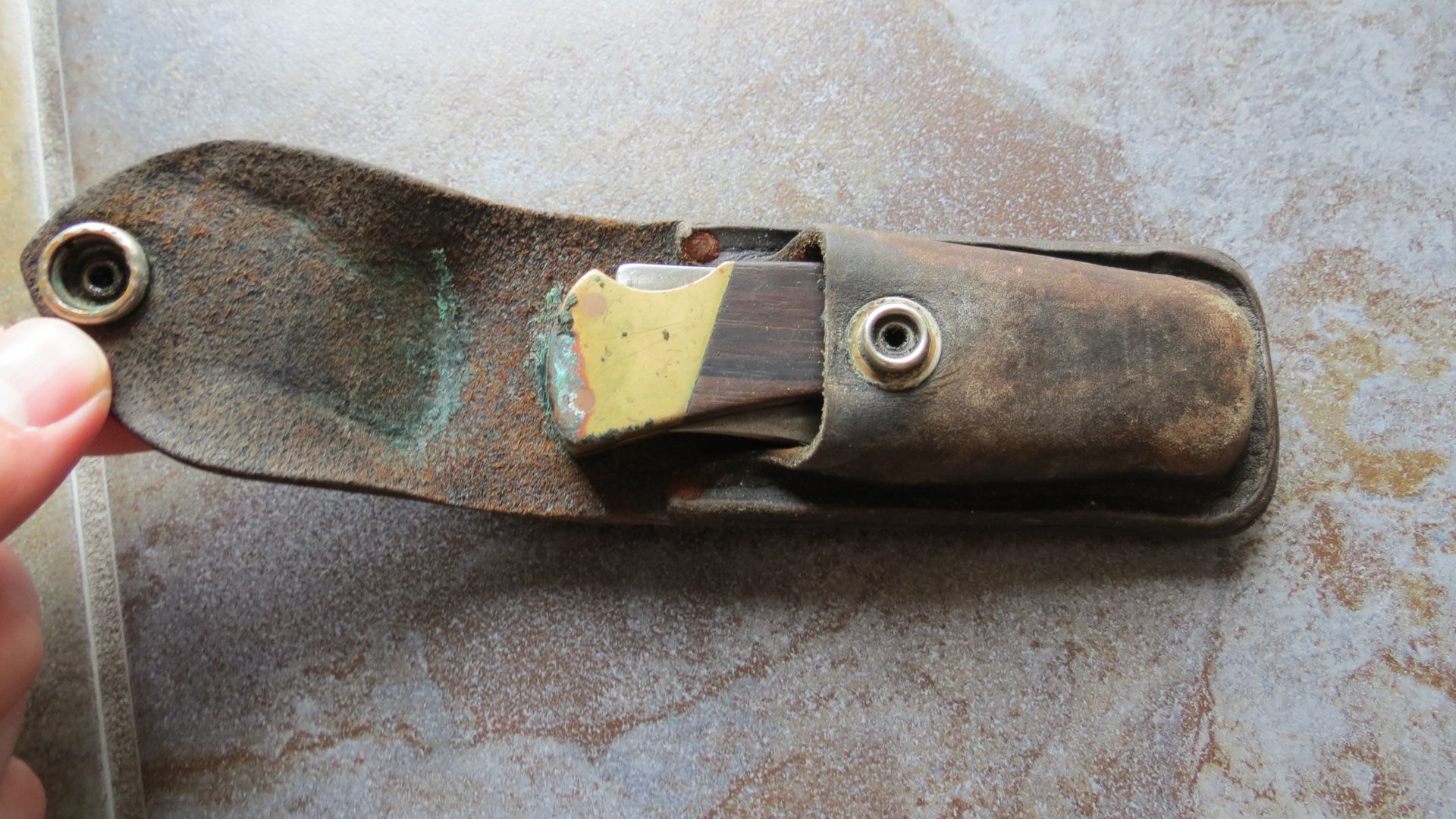

The leather sheath was dry and cracking.
I decided to essentially preserve the entire package. Remove the red rust, clean the grit from the inside, remove the green oxidization without destroying the patina underneath, and preserve the leather sheath.
I tried my best to take pictures of the entire project, but I got a little carried away so there aren't many WIP pics, mostly before and after shots.
What I did to it below...

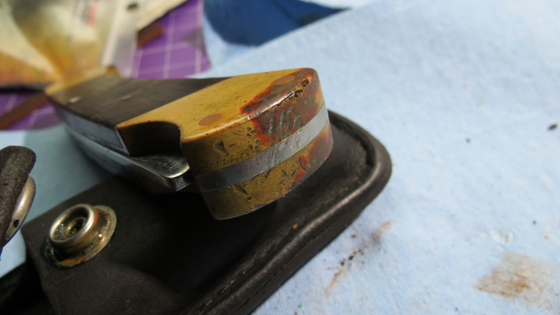

I used 100% pure neatsfoot oil on the sheath. I have never before seen leather absorb so much oil so quickly! It was just drinking it in.

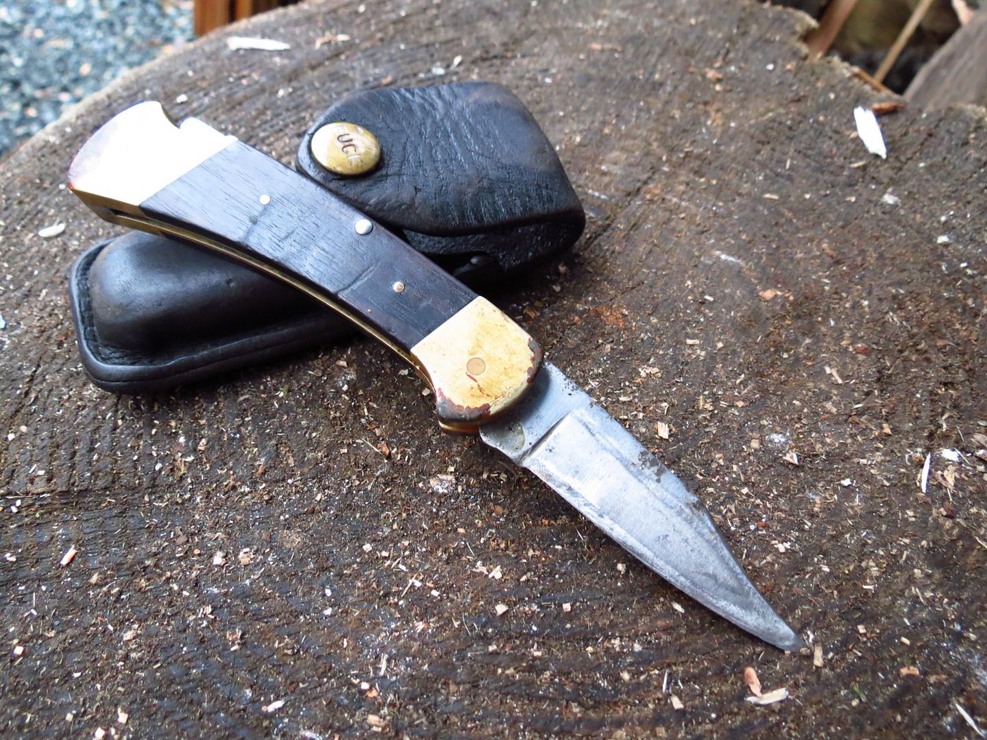

For the red rust, I used a small piece of veggie tan leather to rub most of it off, then used my thumbnail to scrape the harder to get rust off, followed by a tiny amount of oil. I could have used some polishing compound, but I wanted to preserve as much patina as I could.
The oxidization was all taken off with my thumbnail as I didn't want to hurt the patina underneath.

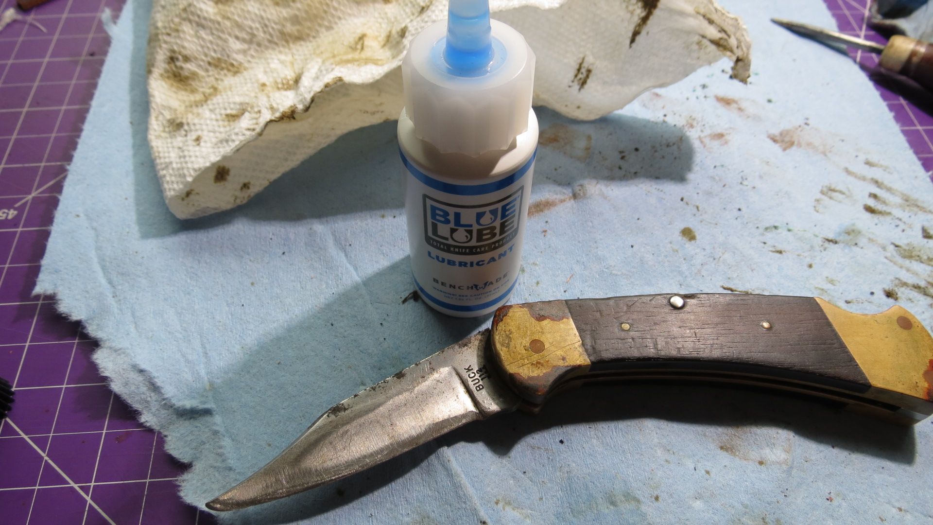

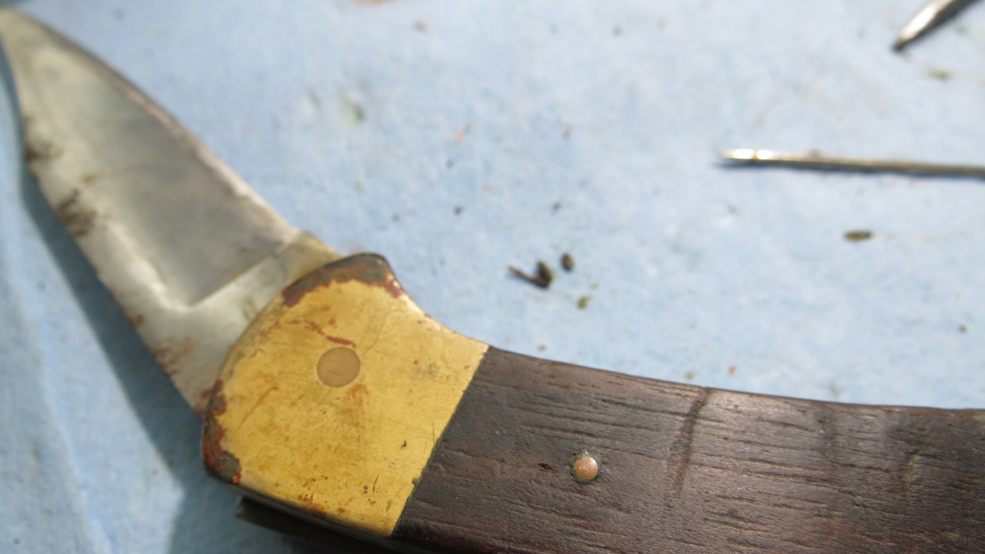

I flushed the pivot with Benchmade Blue Lube Cleanser, and removed the grit and grim from inside with a large sewing needle and strip of leather.
After it was cleaned, I applied a few drops of Benchmade Blue Lube. At this point, it was smooth and easy to open and close. No up and down play, and very little side to side.
After that, I put a couple drops of mineral oil on the scales.

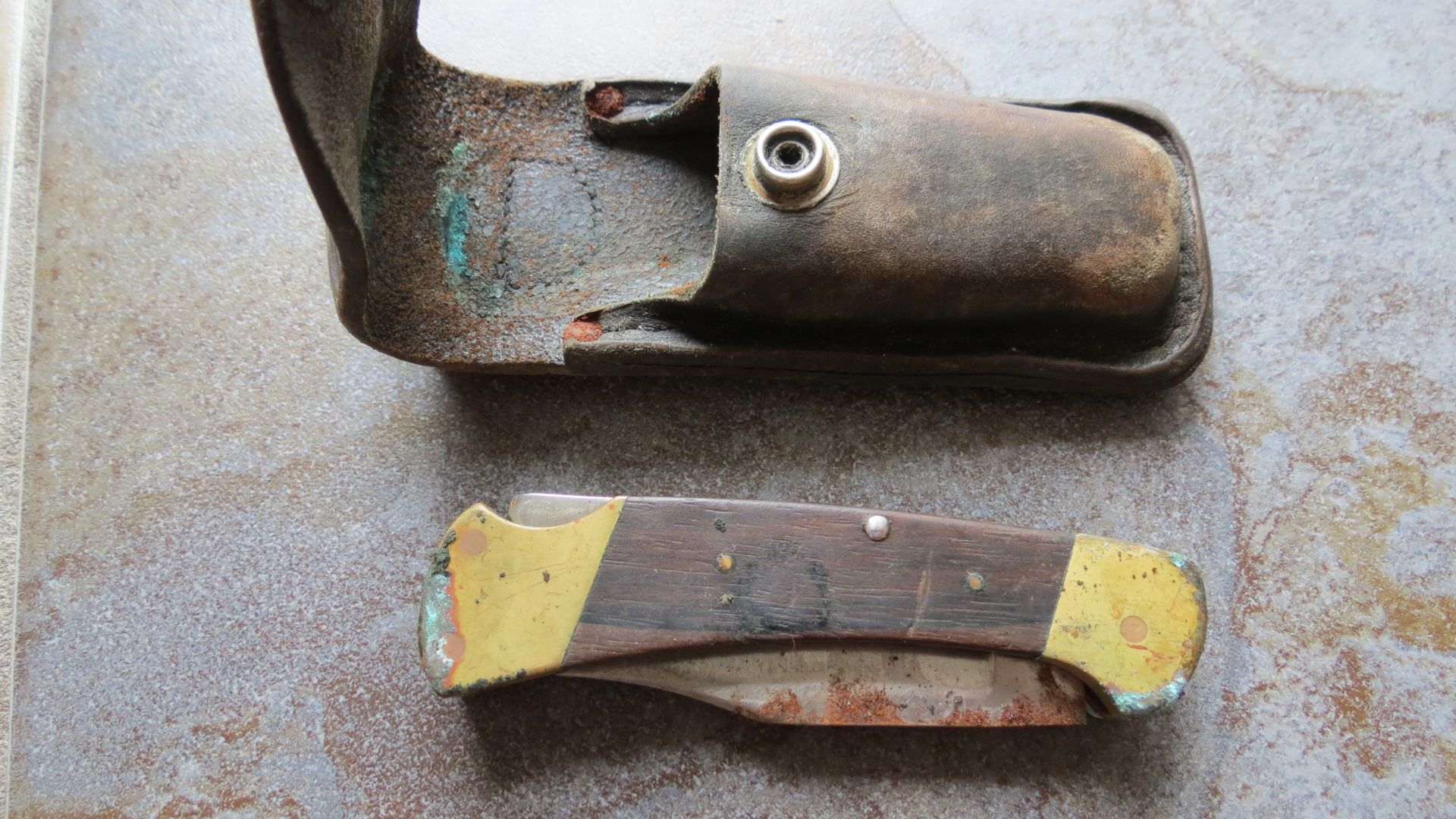

Before pictures...
And some WIP pics.
I'm not sure what this is, but it was caught under the back spring...

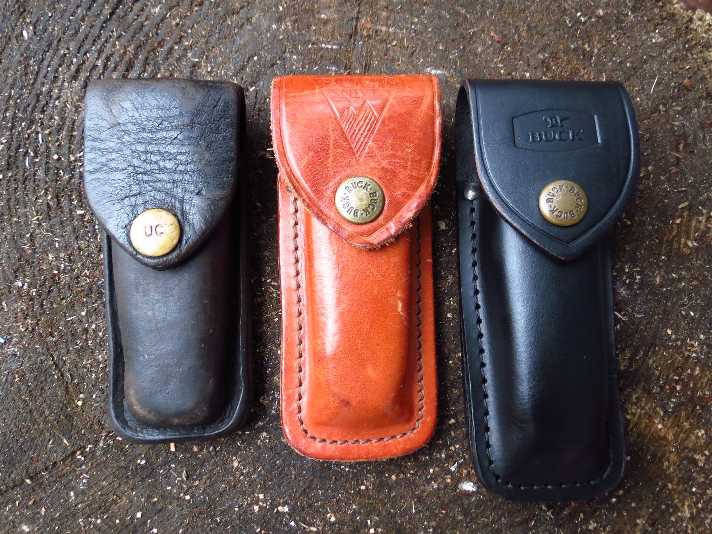

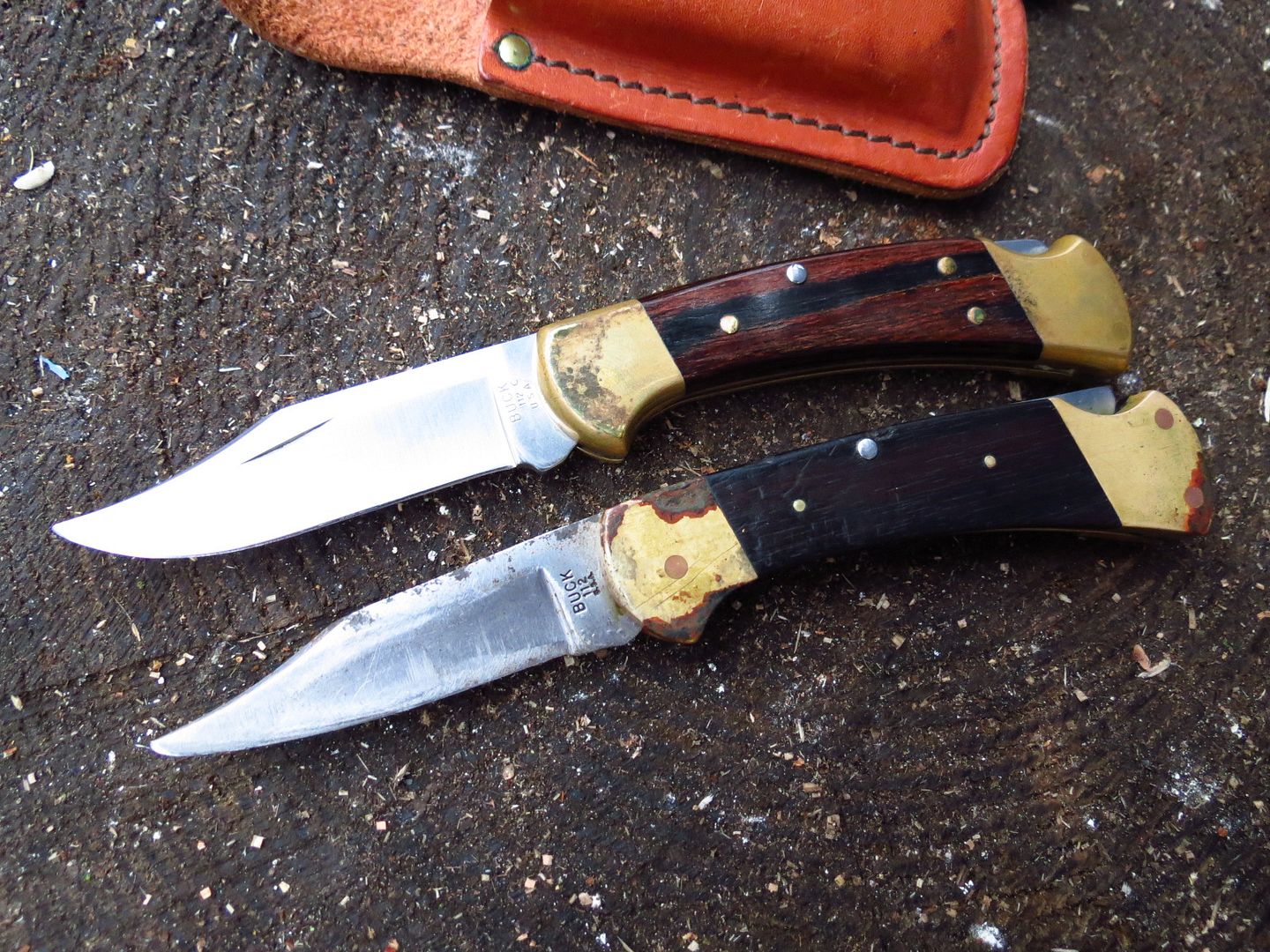

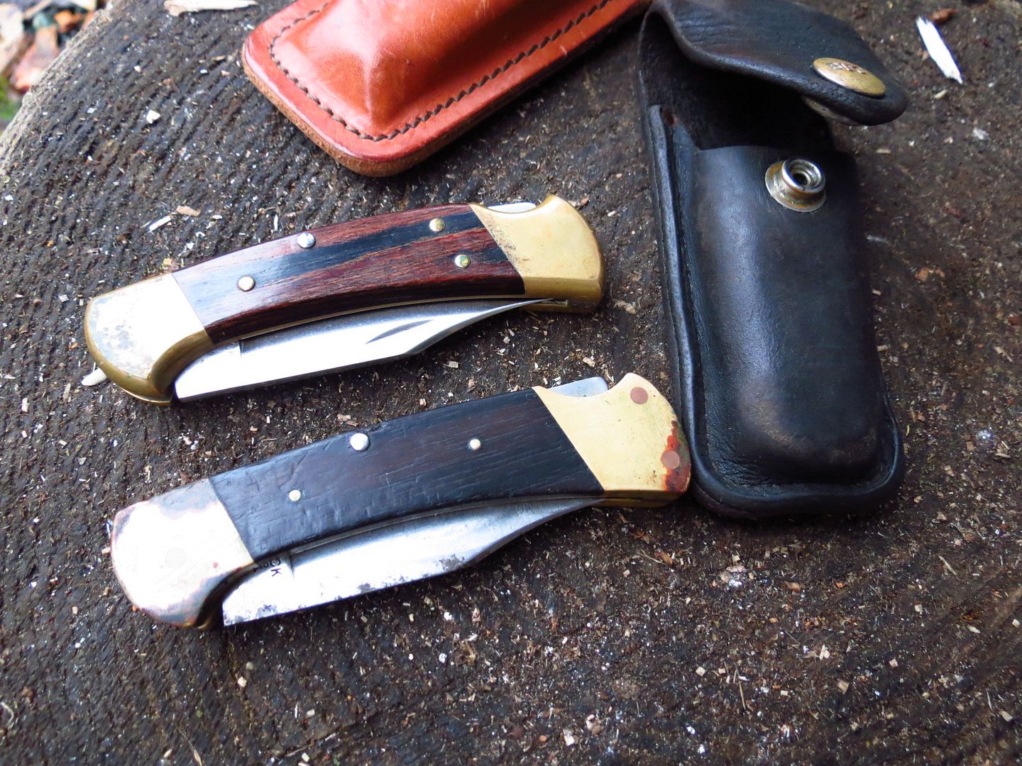

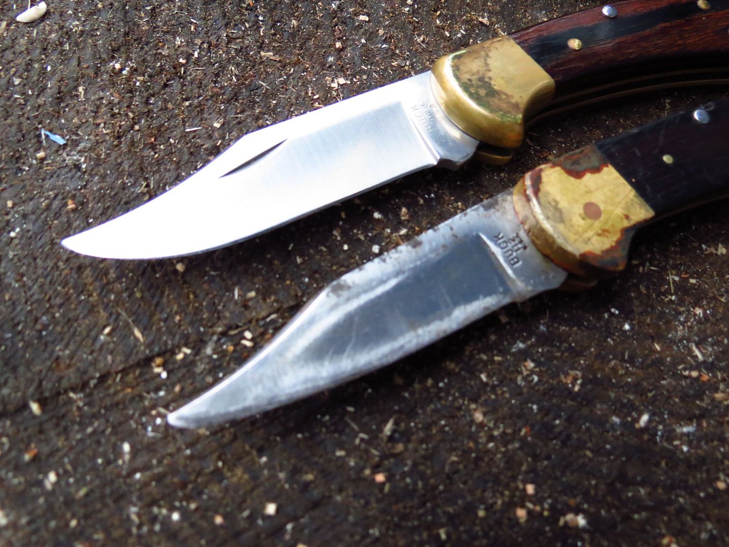

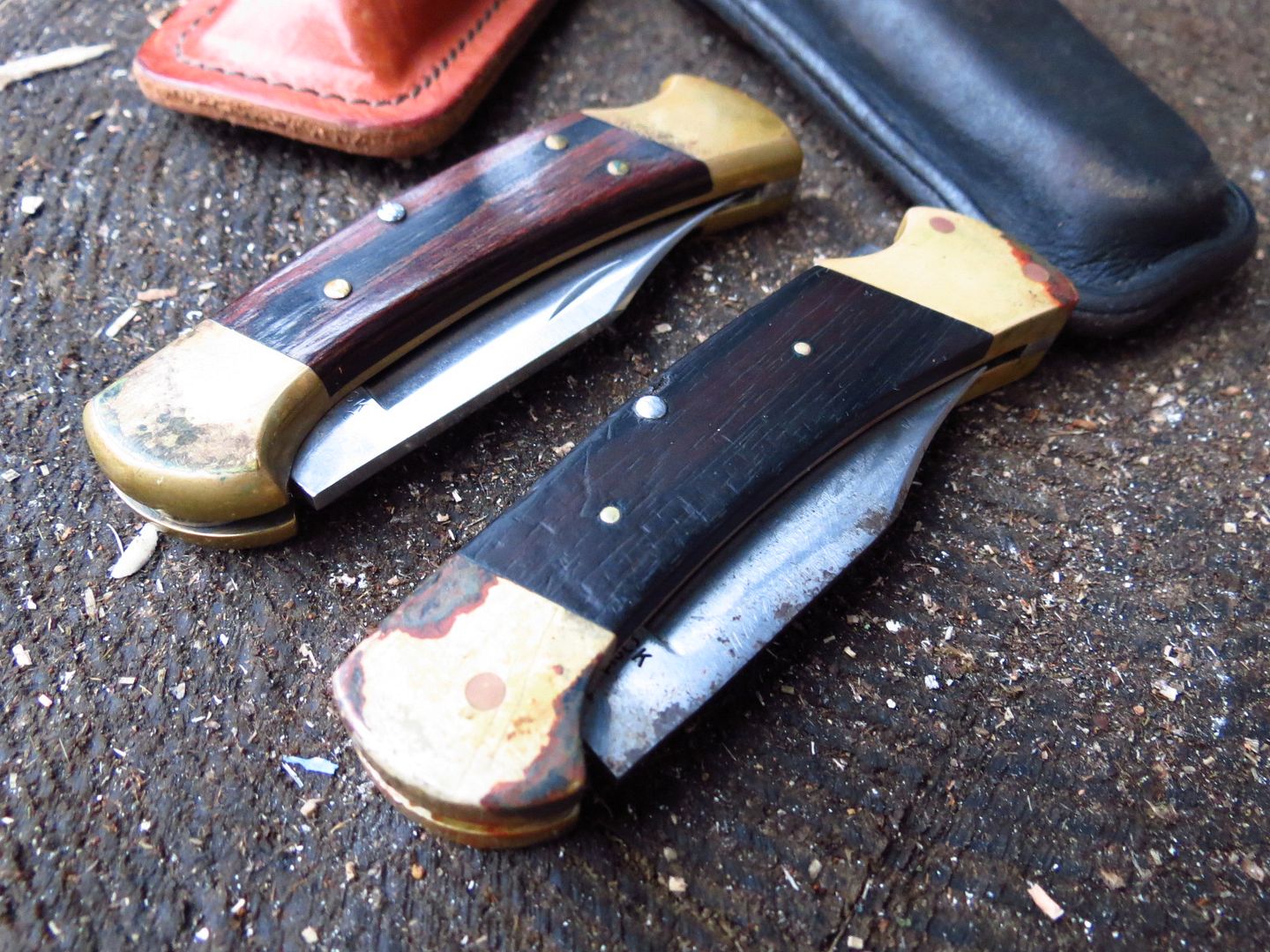

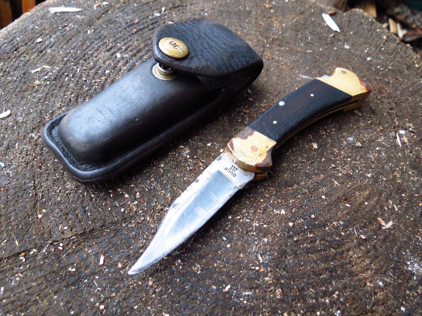

And here's the finished project next to my brother's 112.

Buck was using 440C on that era knives. Thanks of putting in the elbow grease to restore your Grandfather's knife. He'd be proud of you. DM

The blade is 440C but it has been sharpened down a lot. You could send it to Buck for Spa treatment and blade replacement. It would have a 420HC blade but would look amazing.
