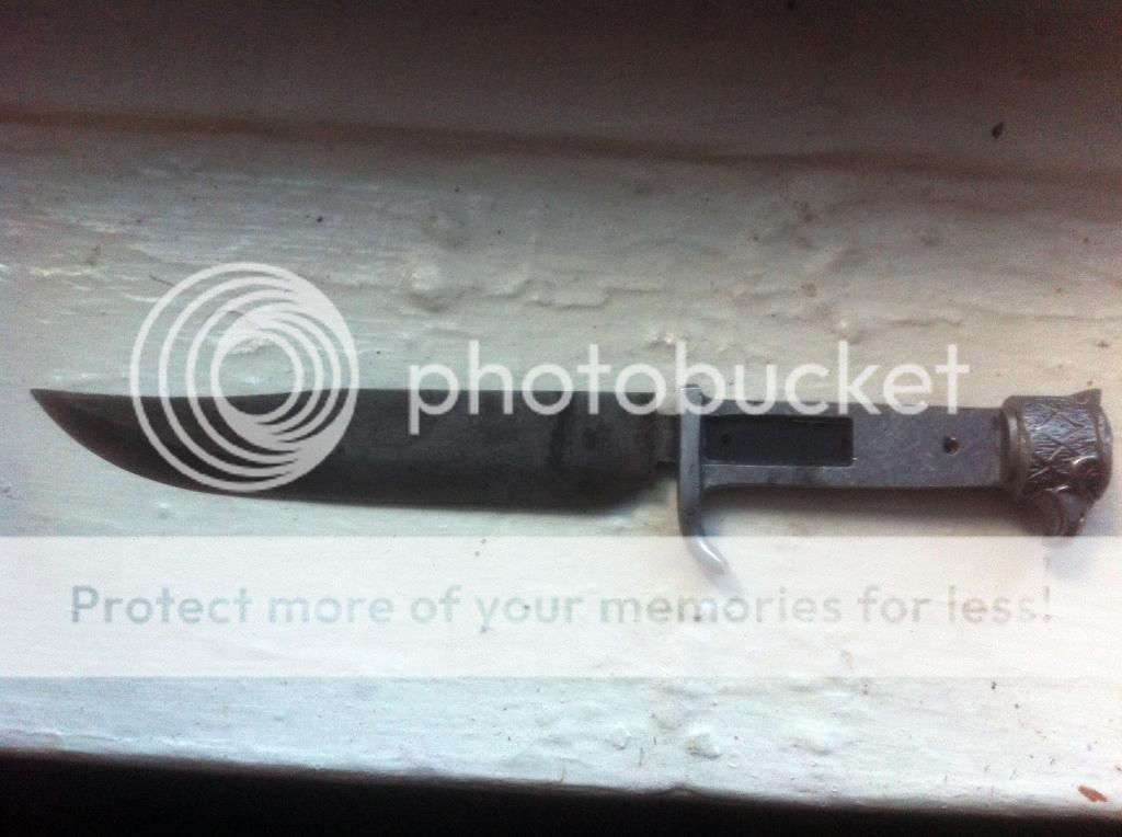

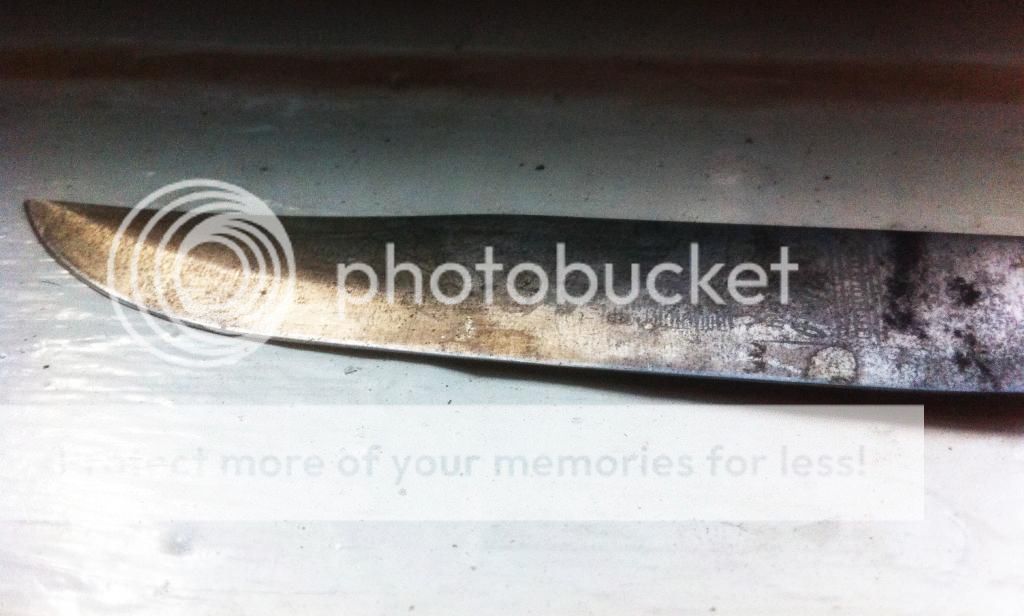

It once had cheap stag slabs that had cracked and fallen off and the blade was coming out of the handle. The blade was full (don't know that he ever really went hunting) but clouded with patina from who knows how many years sitting in a leather sheath outside with Chicago seasonal changes in temp and humidity. Under the patina one can make out a faint etch of a Stag surrounded by what looks like Bavarian ornamentation. Hard to see here:

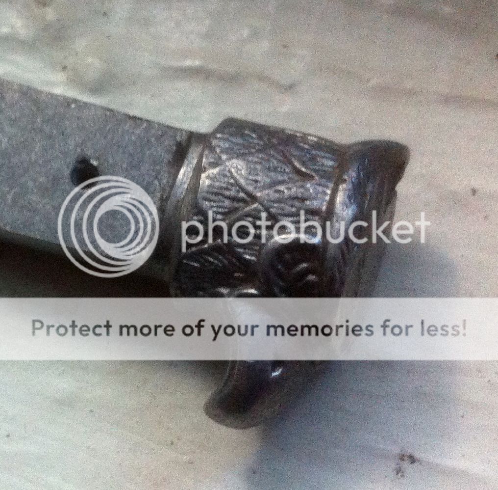

and the butt end of the handle had this goofy Eagle head (actually think its pretty cool)

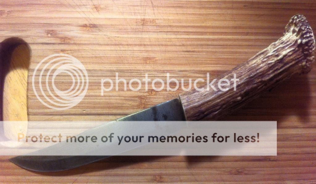

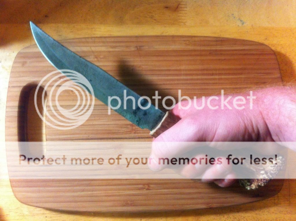

With the handle damaged as it was and the blade loose I thought about just sawing some new slabs and using the original frame but the guard and the Eagle head make the grip too small for my hands. Also the blade stock is actually quite thin, which I like, but it doesn't seem like its best use is in a knife handle of this type. So I decided instead to reserve the original handle for something else and rehandle the blade with a nice piece of Stag Antler I had laying around. I boiled the antler for about a half hour and then sunk it onto the vice clamped blade tang. Pretty simple but I think it came out nice and will likely see a fair amount of use in the kitchen. Here it is:
This antler fits the hand perfectly and the swayback makes it great for slicing, skinning and boning. And the thin carbon stock sharpened up very well.

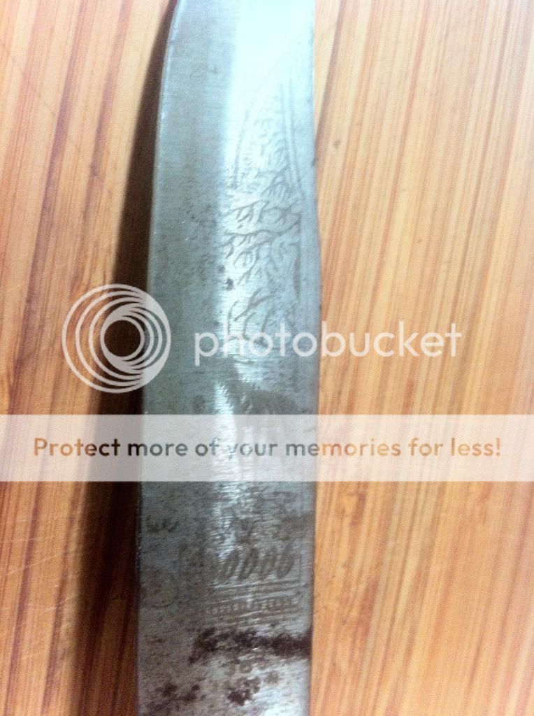

and here you can see the Stag etch a bit better:

Lemmy, it's great that you have some of grampa's keepsakes. I like the way you did the antler swayback style.

Buy the way Lemmy, the handles always seemed loose on those knives, that's why I never bought one as a kid. Seeing your picture of the knife apart, I can see why. That whole handle section appears to have been held on by one pin.
