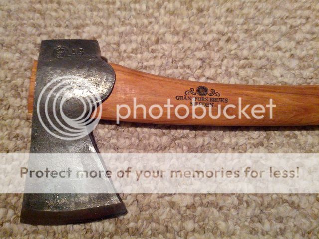

Hey guys, Wondering if anybody knew what treatment to use to get your hickory handles to turn out the rich, dark color that Gransfors Bruks produces?
Here is a pic to showcase the color, taken from the internet.
Mine came that way...almost exactly what the pic shows. I'm pretty sure they use beeswax as a final coat over their linseed oil treatment. I would think some BLO and natural (not bleached) beeswax would probably do it.

The Aqua Fortis is a stain the BLO brings out the grain and highlights the color. The wax protects everything and gives it a sheen.

As far as your original question about the color of the GB axe I believe that axe handle has all heartwood. The heartwood is a darker reddish brown and I've seen GB's with lighter sapwood as well as some with each color.
