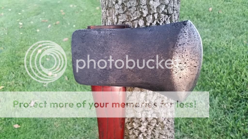

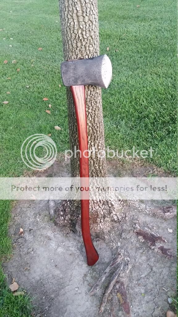

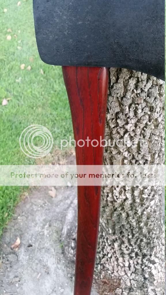

@ The Cow, I really like your stain job! I just finished my axe handle and hung it. I used Cherry Rosewood aniline dye over a dark brown leather antique gel. I had to use the brown antique gel because I realized that the cherry rosewood is pink when applied on hickory.
Here you can really see that deep rich color, while still being able to see wood grain.
i will admit that those look good.

Thanks! I think it would have looked a bit more natural if I used wood grain filler. You can see the unstained part of the wood grain. That's the only thing that bugs me.
